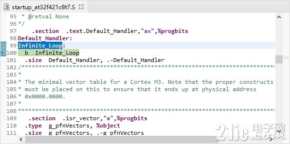

[AT32F421] AT32F421定时器3和15启用中断就进入Infinite_Loop,原厂支持一下

  * File   : main.c
  * Version: V1.2.4
/* Includes ------------------------------------------------------------------*/
#include "at32f4xx.h"
#include "at32_board.h"
/* Private typedef -----------------------------------------------------------*/
/* Private define ------------------------------------------------------------*/
/* Private macro -------------------------------------------------------------*/
/* Private variables ---------------------------------------------------------*/
GPIO_InitType GPIO_InitStructure;
TMR_TimerBaseInitType  TMR_TMReBaseStructure = {0};
TMR_OCInitType  TMR_OCInitStructure = {0};
NVIC_InitType NVIC_InitStructure;
/* Private function prototypes -----------------------------------------------*/
void RCC_Configuration(void);
void AT32_NVIC_Init(void);
void AT32_TMR3_Init(void);
/* Private functions ---------------------------------------------------------*/
int main(void){
  AT32_NVIC_Init();
  RCC_Configuration();
  Delay_init();
  AT32_LEDn_Init(LED3);
  AT32_LEDn_OFF(LED3);
  AT32_TMR3_Init();
  TMR_INTConfig(TMR3, TMR_INT_CC1, ENABLE);
  TMR_Cmd(TMR3, ENABLE);/* TMR3 enable counter */
  while (1){
        Delay_ms(100);
        RCC_APB1PeriphClockCmd(RCC_APB1PERIPH_TMR3, ENABLE);
        RCC_APB2PeriphClockCmd(RCC_APB2PERIPH_TMR1, ENABLE);
void AT32_NVIC_Init(void){
//        NVIC_PriorityGroupConfig(NVIC_PriorityGroup_4);
        NVIC_InitStructure.NVIC_IRQChannel = TMR3_GLOBAL_IRQn;
        NVIC_InitStructure.NVIC_IRQChannelPreemptionPriority = 1;
        NVIC_InitStructure.NVIC_IRQChannelSubPriority = 1;
        NVIC_InitStructure.NVIC_IRQChannelCmd = ENABLE;
        NVIC_Init(&NVIC_InitStructure);
/* TMR3 base configuration */
void AT32_TMR3_Init(void){
        TMR_TimeBaseStructInit(&TMR_TMReBaseStructure);
        TMR_TMReBaseStructure.TMR_Period = SystemCoreClock/10000-1;
        TMR_TMReBaseStructure.TMR_DIV = 10000-1;
        TMR_TMReBaseStructure.TMR_ClockDivision = 0;
        TMR_TMReBaseStructure.TMR_CounterMode = TMR_CounterDIR_Up;
        TMR_TimeBaseInit(TMR3, &TMR_TMReBaseStructure);
void TMR3_GLOBAL_IRQHandler(void){
        AT32_LEDn_Toggle(LED3);
        TMR_ClearITPendingBit(TMR3, TMR_INT_Overflow | TMR_INT_CC1 | TMR_INT_CC2 |        TMR_INT_CC3 | TMR_INT_CC4 | TMR_INT_Trigger);
 楼主| abc8051 发表于 2021-10-3 11:36 | 显示全部楼层
找到原因了,原厂启动文件问题。
  .word  TMR1_BRK_UP_TRG_COM_IRQHandler      /* TMR1 Break UP TRG COM                       */
  .word  TMR1_CC_IRQHandler                  /* TMR1 Capture Compare                        */
  .word  0                           /*增加一行                       */
  .word  TMR3_GLOBAL_IRQHandler              /* TMR3
