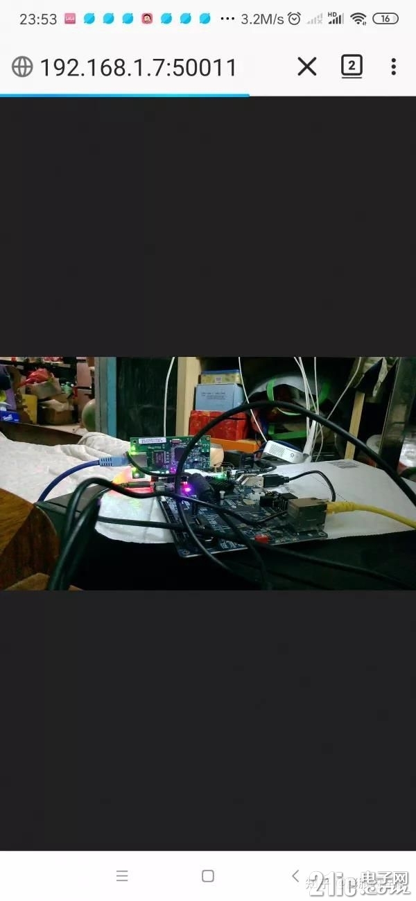

发送完HTTP标准头之后,就需要发送内容头(Content-Type),这处的Content-Type为image/jpeg,同样,HTTP标准协议里面image支持的类型远不止jpeg一种,发送完内容头之后就是正文和boundary结尾,这样帧完整的HTTP头发送到指定的TCP GET地址,就会在浏览器中显示刚刚发送的图片:
sprintf(buffer, "Content-Type: image/jpeg\r\n" \                "Content-Length: %d\r\n" \                "X-Timestamp: %d.%06d\r\n" \                "\r\n", frame_size, (int)timestamp.tv_sec, (int)timestamp.tv_usec);        printf("sending intemdiate header\n");        if(write(fd, buffer, strlen(buffer)) < 0)            break;        printf("sending frame\n");        if(write(fd, frame, frame_size) < 0)            break;        printf("sending boundary\n");        sprintf(buffer, "\r\n--" BOUNDARY "\r\n");        if(write(fd, buffer, strlen(buffer)) < 0)            break;
另外需要说明的是,TCP服务器线程在发送MJPEG流的时候是死循环发送的,因此TCP客户端在发送完GET指令之后,就会收到TCP服务器循环发送的图像缓存,TCP客户端会陷入忙等待状态无法再对外发送任何GET或者POST指令,从客户端使用者角度来看的效果就是网页一直在等待。

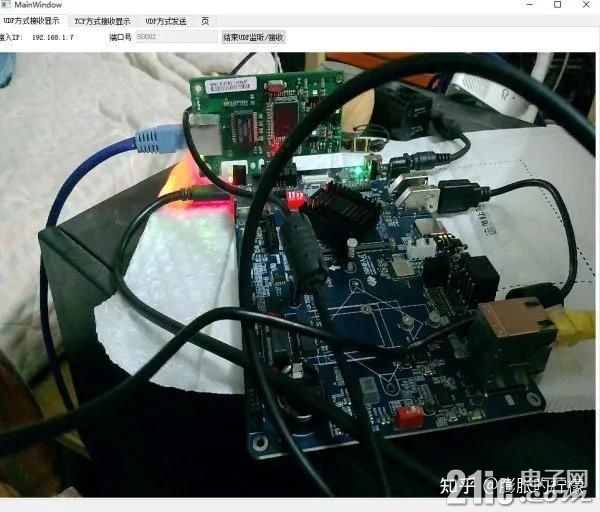

UDP发送操作,同样需要先建立UDP Socket:
int UDP_Send_Found(socklen_t* socket_found , struct sockaddr_in *addr , char* ip , int port){    *socket_found = socket(AF_INET, SOCK_DGRAM, 0);    if(*socket_found == (~0))    {        printf("Create udp send socket failed!\n");        return -1;    }    addr->sin_family = AF_INET;    addr->sin_addr.s_addr = inet_addr(ip);    addr->sin_port = htons(port);    memset(addr->sin_zero, 0, 8);    return 0;}
而UDP文件发送则要比HTTP发送简单得多,只需要将文件切片,每一片为固定长度的UDP帧长度,逐帧发送即可:
while(fend > 0){memset(picture.data , 0 , sizeof(picture.data));fread(picture.data , UDP_FRAME_LEN , 1, fp);if(fend >= UDP_FRAME_LEN){picture.length = UDP_FRAME_LEN;picture.fin = 0;}else{picture.length = fend;picture.fin = 1;}//printf("sendbytes = %d \n",sendbytes);sendbytes = sendto(socket_send, (char *)&picture, sizeof(struct Package), 0, (struct sockaddr*)&addr,addr_len);if(sendbytes == -1){printf("Send Picture Failed!d\n");return -1;}else{fend -= UDP_FRAME_LEN;}}
