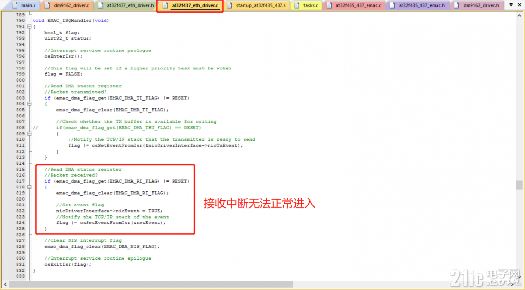

年前申请了AT32F437-START开发板,冲着板载的网络和超大的flash和内存空间,然后根据项目实际使用的协议栈,将CycloneTCP协议栈移植到此开发板上,目前已经实现可以发出IGMPV2协议报文,但是网络指示灯一直显示自协商的网络速度为10MHz,电脑端可以识别网卡设备,且使用ping指令无法正常ping通,现将相应的代码发上来,希望能得到官方的协助,帮忙讲解下EMAC外设的相关初始化流程和中断DMA收发数据的正确操作模式。

FrameTypeDef emac_rxpkt_chainmode(void)
        uint32_t framelength = 0;
        FrameTypeDef frame = {0,0};
        /* Check if the descriptor is owned by the ETHERNET DMA (when set) or CPU (when reset) */
        if((dma_rx_desc_to_get->status & EMAC_DMARXDESC_OWN) != (uint32_t)RESET)
                frame.length = FALSE;
                if(emac_dma_flag_get(EMAC_DMA_RBU_FLAG))
                        /* Clear RBUS ETHERNET DMA flag */
                        emac_dma_flag_clear(EMAC_DMA_RBU_FLAG);
                        /* Resume DMA reception */
                        EMAC_DMA->rpd_bit.rpd = FALSE;
                /* Return error: OWN bit set */
                return frame;
        if(((dma_rx_desc_to_get->status & EMAC_DMATXDESC_ES) == (uint32_t)RESET) &&
        ((dma_rx_desc_to_get->status & EMAC_DMARXDESC_LS) != (uint32_t)RESET) &&
        ((dma_rx_desc_to_get->status & EMAC_DMARXDESC_FS) != (uint32_t)RESET))
                /* Get the Frame Length of the received packet: substruct 4 bytes of the CRC */
                framelength = ((dma_rx_desc_to_get->status & EMAC_DMARXDESC_FL) >> EMAC_DMARXDESC_FRAME_LENGTHSHIFT) - 4;
                /* Get the addrees of the actual buffer */
                frame.buffer = dma_rx_desc_to_get->buf1addr;
        else
                /* Return ERROR */
                framelength = FALSE;
        frame.length = framelength;
        frame.descriptor = dma_rx_desc_to_get;
        /* Update the ETHERNET DMA global Rx descriptor with next Rx decriptor */
        /* Chained Mode */
        /* Selects the next DMA Rx descriptor list for next buffer to read */
        dma_rx_desc_to_get = (emac_dma_desc_type*) (dma_rx_desc_to_get->buf2nextdescaddr);
        /* Return Frame */
        return (frame);
* Function Name  : emac_txpkt_chainmode
* Description    : Transmits a packet, from application buffer, pointed by ppkt.
* Input          : - FrameLength: Tx Packet size.
* Output         : None
* Return         : ERROR: in case of Tx desc owned by DMA
*                  SUCCESS: for correct transmission
error_status emac_txpkt_chainmode(uint16_t FrameLength)
        if((dma_tx_desc_to_set->status & EMAC_DMATXDESC_OWN) != (uint32_t)RESET)
                /* Return ERROR: OWN bit set */
                return ERROR;
        /* Setting the Frame Length: bits[12:0] */
        dma_tx_desc_to_set->controlsize = (FrameLength & EMAC_DMATXDESC_TBS1);
        /* Setting the last segment and first segment bits (in this case a frame is transmitted in one descriptor) */
        dma_tx_desc_to_set->status |= EMAC_DMATXDESC_LS | EMAC_DMATXDESC_FS;
        /* Set Own bit of the Tx descriptor Status: gives the buffer back to ETHERNET DMA */
        dma_tx_desc_to_set->status |= EMAC_DMATXDESC_OWN;
        /* When Tx Buffer unavailable flag is set: clear it and resume transmission */
        if(emac_dma_flag_get(EMAC_DMA_TBU_FLAG))
                /* Clear TBUS ETHERNET DMA flag */
                emac_dma_flag_clear(EMAC_DMA_TBU_FLAG);
                /* Resume DMA transmission*/
                EMAC_DMA->tpd_bit.tpd = 0;
        /* Update the ETHERNET DMA global Tx descriptor with next Tx decriptor */
        /* Chained Mode */
        /* Selects the next DMA Tx descriptor list for next buffer to send */
        dma_tx_desc_to_set = (emac_dma_desc_type*) (dma_tx_desc_to_set->buf2nextdescaddr);
        /* Return SUCCESS */
        return SUCCESS;

* @brief AT32F437 Ethernet MAC interrupt service routine
void EMAC_IRQHandler(void)
        bool_t flag;
        uint32_t status;
        //Interrupt service routine prologue
        osEnterIsr();
        //This flag will be set if a higher priority task must be woken
        flag = FALSE;
        //Read DMA status register
        //Packet transmitted?
        if (emac_dma_flag_get(EMAC_DMA_TI_FLAG) != RESET)
                emac_dma_flag_clear(EMAC_DMA_TI_FLAG);
                //Check whether the TX buffer is available for writing
//                if(emac_dma_flag_get(EMAC_DMA_TBU_FLAG) == RESET)
                        //Notify the TCP/IP stack that the transmitter is ready to send
                        flag |= osSetEventFromIsr(&nicDriverInterface->nicTxEvent);
        //Packet received?
        if (emac_dma_flag_get(EMAC_DMA_RI_FLAG) != RESET)
                emac_dma_flag_clear(EMAC_DMA_RI_FLAG);
                //Set event flag
                nicDriverInterface->nicEvent = TRUE;
                //Notify the TCP/IP stack of the event
                flag |= osSetEventFromIsr(&netEvent);
        //Clear NIS interrupt flag
        emac_dma_flag_clear(EMAC_DMA_NIS_FLAG);
        //Interrupt service routine epilogue
        osExitIsr(flag);

* @param[in] ancillary Additional options passed to the stack along with
*   the packet
* @return Error code
error_t at32f437EthSendPacket(NetInterface *interface,
   const NetBuffer *buffer, size_t offset, NetTxAncillary *ancillary)
        size_t length;
        uint8_t *tx_buffer =  (uint8_t *)emac_getcurrenttxbuffer();
        //Retrieve the length of the packet
        length = netBufferGetLength(buffer) - offset;
        //Check the frame length
        if(length > AT32F437_ETH_TX_BUFFER_SIZE)
                //The transmitter can accept another packet
                osSetEvent(&interface->nicTxEvent);
                //Report an error
                return ERROR_INVALID_LENGTH;
//        //Make sure the current buffer is available for writing
//        if(emac_dma_flag_get(EMAC_DMA_TBU_FLAG))
//                /* Clear TBUS ETHERNET DMA flag */
//                emac_dma_flag_clear(EMAC_DMA_TBU_FLAG);
//                /* Resume DMA transmission*/
//                EMAC_DMA->tpd_bit.tpd = 0;
//                return ERROR_FAILURE;
        //Copy user data to the transmit buffer
        netBufferRead((uint8_t *) tx_buffer, buffer, offset, length);
        if(emac_txpkt_chainmode(length) == ERROR)
        //Data successfully written
        return NO_ERROR;
* @brief Receive a packet
* @param[in] interface Underlying network interface
error_t at32f437EthReceivePacket(NetInterface *interface)
   error_t error;
   size_t n;
   NetRxAncillary ancillary;
   FrameTypeDef frame;
        while(emac_received_packet_size_get() != 0)
                frame = emac_rxpkt_chainmode();
                if (frame.length > 0)
                        //Limit the number of data to read
                        n = MIN(frame.length, AT32F437_ETH_RX_BUFFER_SIZE);
                        //Additional options can be passed to the stack along with the packet
                        ancillary = NET_DEFAULT_RX_ANCILLARY;
                        //Pass the packet to the upper layer
                        nicProcessPacket(interface, (uint8_t *) frame.buffer, n,
                           &ancillary);
                        //Valid packet received
                        error = NO_ERROR;
                else
                        //The packet is not valid
                        error = ERROR_INVALID_PACKET;
                /* Set Own bit of the Rx descriptor Status: gives the buffer back to ETHERNET DMA */
                frame.descriptor->status |= EMAC_DMARXDESC_OWN;
                /* When Rx Buffer unavailable flag is set: clear it and resume reception */
        //Return status code
    return error;

接收中断无法正常进入
接收中断无法正常进入

感谢,官网的这些文档我已经阅读过了,目前不是初始化卡住,而是初始化自识别的模式和数据收发好像不太对,就是没有特定的讲解EMAC外设的流程文档,就不太清楚到底问题出在哪里,是设置不对还是时序有问题
