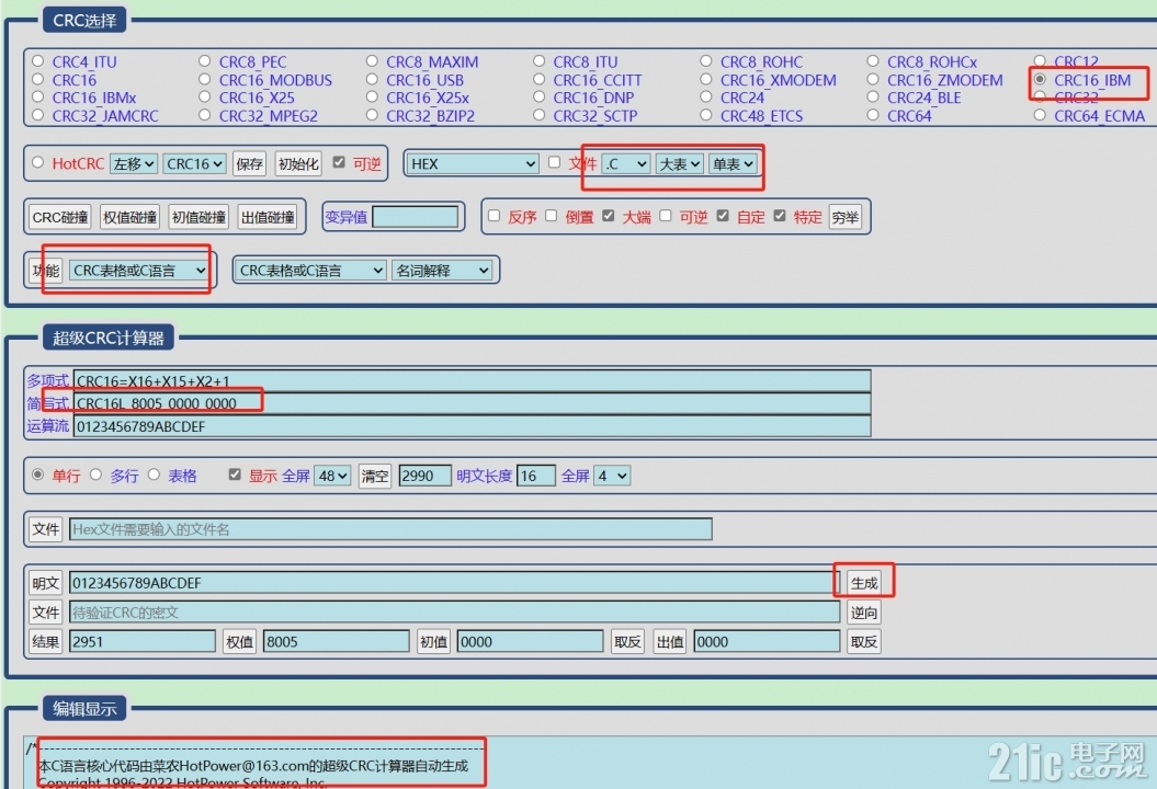

[超级CRC计算器] CRC16L_8005_0000_0000源码(www.hotcrc.com自动生成)
 楼主| hotpower 发表于 2023-9-21 09:49 | 显示全部楼层 |阅读模式
  1. /*------------------------------------------------------------------------------
  2.    本C语言核心代码由菜农HotPower@163.com的超级CRC计算器自动生成
  3.    Copyright 1996-2022 HotPower Software, Inc.
  4.    菜农HotPower[url=home.php?mod=space&uid=516618]@163.com[/url] 2023年9月21日 09:48:45 于西安雁塔菜地
  5. ------------------------------------------------------------------------------*/
  6. //CRC单表大表表格:
  7. const unsigned short CRC16L_8005_Table[256] = {//特别注意Keil C51请用code替换const
  8.   0x0000,0x8005,0x800F,0x000A,0x801B,0x001E,0x0014,0x8011,0x8033,0x0036,0x003C,0x8039,0x0028,0x802D,0x8027,0x0022,
  9.   0x8063,0x0066,0x006C,0x8069,0x0078,0x807D,0x8077,0x0072,0x0050,0x8055,0x805F,0x005A,0x804B,0x004E,0x0044,0x8041,
  10.   0x80C3,0x00C6,0x00CC,0x80C9,0x00D8,0x80DD,0x80D7,0x00D2,0x00F0,0x80F5,0x80FF,0x00FA,0x80EB,0x00EE,0x00E4,0x80E1,
  11.   0x00A0,0x80A5,0x80AF,0x00AA,0x80BB,0x00BE,0x00B4,0x80B1,0x8093,0x0096,0x009C,0x8099,0x0088,0x808D,0x8087,0x0082,
  12.   0x8183,0x0186,0x018C,0x8189,0x0198,0x819D,0x8197,0x0192,0x01B0,0x81B5,0x81BF,0x01BA,0x81AB,0x01AE,0x01A4,0x81A1,
  13.   0x01E0,0x81E5,0x81EF,0x01EA,0x81FB,0x01FE,0x01F4,0x81F1,0x81D3,0x01D6,0x01DC,0x81D9,0x01C8,0x81CD,0x81C7,0x01C2,
  14.   0x0140,0x8145,0x814F,0x014A,0x815B,0x015E,0x0154,0x8151,0x8173,0x0176,0x017C,0x8179,0x0168,0x816D,0x8167,0x0162,
  15.   0x8123,0x0126,0x012C,0x8129,0x0138,0x813D,0x8137,0x0132,0x0110,0x8115,0x811F,0x011A,0x810B,0x010E,0x0104,0x8101,
  16.   0x8303,0x0306,0x030C,0x8309,0x0318,0x831D,0x8317,0x0312,0x0330,0x8335,0x833F,0x033A,0x832B,0x032E,0x0324,0x8321,
  17.   0x0360,0x8365,0x836F,0x036A,0x837B,0x037E,0x0374,0x8371,0x8353,0x0356,0x035C,0x8359,0x0348,0x834D,0x8347,0x0342,
  18.   0x03C0,0x83C5,0x83CF,0x03CA,0x83DB,0x03DE,0x03D4,0x83D1,0x83F3,0x03F6,0x03FC,0x83F9,0x03E8,0x83ED,0x83E7,0x03E2,
  19.   0x83A3,0x03A6,0x03AC,0x83A9,0x03B8,0x83BD,0x83B7,0x03B2,0x0390,0x8395,0x839F,0x039A,0x838B,0x038E,0x0384,0x8381,
  20.   0x0280,0x8285,0x828F,0x028A,0x829B,0x029E,0x0294,0x8291,0x82B3,0x02B6,0x02BC,0x82B9,0x02A8,0x82AD,0x82A7,0x02A2,
  21.   0x82E3,0x02E6,0x02EC,0x82E9,0x02F8,0x82FD,0x82F7,0x02F2,0x02D0,0x82D5,0x82DF,0x02DA,0x82CB,0x02CE,0x02C4,0x82C1,
  22.   0x8243,0x0246,0x024C,0x8249,0x0258,0x825D,0x8257,0x0252,0x0270,0x8275,0x827F,0x027A,0x826B,0x026E,0x0264,0x8261,
  23.   0x0220,0x8225,0x822F,0x022A,0x823B,0x023E,0x0234,0x8231,0x8213,0x0216,0x021C,0x8219,0x0208,0x820D,0x8207,0x0202
  24. };
  25. //CRC单表大表查表算法:
  26. unsigned short GetCRC16L_8005_0000_0000_Table(unsigned char *crcBuff, unsigned int crcLen) {
  27. unsigned int i;
  28. unsigned short crc = 0x0000;//初值
  29.   for(i = 0; i < crcLen; i ++){
  30.     crc = (crc << 8) ^ CRC16L_8005_Table[(crc >> 8) ^ crcBuff[i]];
  31.     crc &= 0xFFFF;//请注意此语句为了防止数据溢出,有时可删除,具体看编译环境!
  32.   }
  33.   return crc;
  34. }
  35. int main(){
  36. //数据格式:HEX
  37. const unsigned char dataTable[] = {
  38.   0x01, 0x23, 0x45, 0x67, 0x89, 0xAB, 0xCD, 0xEF
  39. };//特别注意Keil C51请用code替换const
  40. unsigned short crc;
  41.   crc = GetCRC16L_8005_0000_0000_Table((unsigned char *)dataTable, sizeof(dataTable));
  42. //表格函数返回crc=0x2951,与HotWC3运算相同
  43.   while(crc | 1);//死循环,请在此处设置断点,验证函数返回值crc是否正确!!!
  44.   return 0;
  45. }
