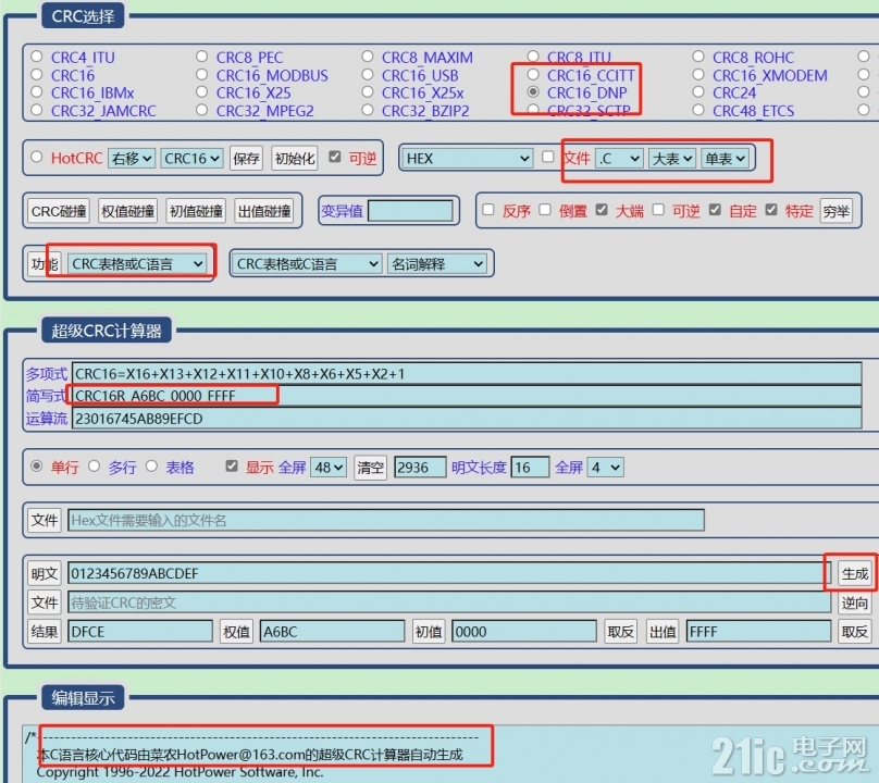

[超级CRC计算器] CRC16R_A6BC_0000_FFFF源码(www.hotcrc.com自动生成)
 楼主| hotpower 发表于 2023-9-21 10:00 | 显示全部楼层 |阅读模式

  40. unsigned short crc;
  41.   crc = GetCRC16R_A6BC_0000_FFFF_Table((unsigned char *)dataTable, sizeof(dataTable));
