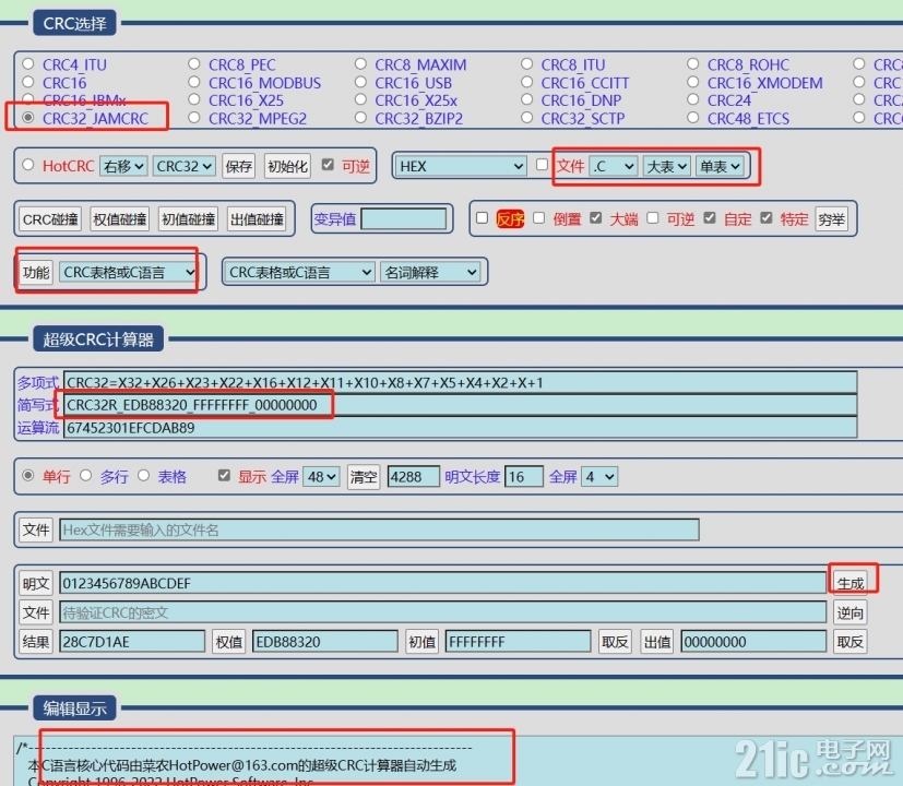

[超级CRC计算器] CRC32R_EDB88320_FFFFFFFF_00000000源码(www.hotcrc.com自动生成)
 楼主| hotpower 发表于 2023-9-21 10:14 | 显示全部楼层 |阅读模式

  39.   0xB3667A2EL,0xC4614AB8L,0x5D681B02L,0x2A6F2B94L,0xB40BBE37L,0xC30C8EA1L,0x5A05DF1BL,0x2D02EF8DL
  40. };
  41. //CRC单表大表查表算法:
  42. unsigned long GetCRC32R_EDB88320_FFFFFFFF_FFFFFFFF_Table(unsigned char *crcBuff, unsigned int crcLen) {
  43. unsigned int i;
  44. unsigned long crc = 0xFFFFFFFF;//初值
  45.   for(i = 0; i < crcLen; i ++){
  46.     crc = (crc >> 8) ^ CRC32R_EDB88320_Table[(crc & 0xFF) ^ crcBuff[i]];
  47.   }
  48.   crc ^= 0xFFFFFFFF;//出值
  49.   return crc;
  50. }
  51. int main(){
  52. //数据格式:HEX
  53. const unsigned char dataTable[] = {
  54.   0x01, 0x23, 0x45, 0x67, 0x89, 0xAB, 0xCD, 0xEF
  55. };//特别注意Keil C51请用code替换const
  56. unsigned long crc;
  57.   crc = GetCRC32R_EDB88320_FFFFFFFF_FFFFFFFF_Table((unsigned char *)dataTable, sizeof(dataTable));
  58. //表格函数返回crc=0x28C7D1AE,与HotWC3运算相同
  59.   while(crc | 1);//死循环,请在此处设置断点,验证函数返回值crc是否正确!!!
  60.   return 0;
  61. }
