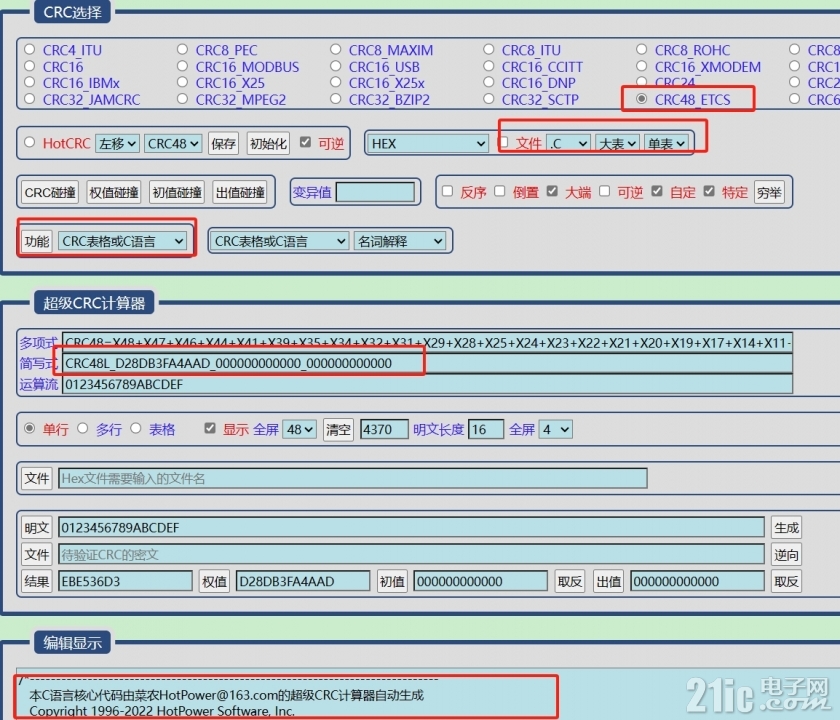

[超级CRC计算器] CRC48L_D28DB3FA4AAD_000000000000_000000000000源码(www.hotcrc.com自动生成)
 楼主| hotpower 发表于 2023-9-21 10:27 | 显示全部楼层 |阅读模式
AD, CRC, rc
  1. /*------------------------------------------------------------------------------

  41. //CRC单表大表查表算法:
  42. uint48 GetCRC48L_D28DB3FA4AAD_000000000000_000000000000_Table(unsigned char *crcBuff, unsigned int crcLen) {
  43. unsigned int i;
  44. uint48 crc = 0x000000000000;//初值
  45.   for(i = 0; i < crcLen; i ++){
  46.     crc = (crc << 8) ^ CRC48L_D28DB3FA4AAD_Table[(crc >> 40) ^ crcBuff[i]];
  47.     crc &= 0xFFFFFFFFFFFFL;//请注意此语句为了防止数据溢出,有时可删除,具体看编译环境!
  48.   }
  49.   return crc;
  50. }
  51. int main(){
  52. //数据格式:HEX
  53. const unsigned char dataTable[] = {
  54.   0x01, 0x23, 0x45, 0x67, 0x89, 0xAB, 0xCD, 0xEF
  55. };//特别注意Keil C51请用code替换const
  56. uint48 crc;
  57.   crc = GetCRC48L_D28DB3FA4AAD_000000000000_000000000000_Table((unsigned char *)dataTable, sizeof(dataTable));
  58. //表格函数返回crc=0x0CFE3A0A507C,与HotWC3运算相同
  59.   while(crc | 1);//死循环,请在此处设置断点,验证函数返回值crc是否正确!!!
  60.   return 0;
  61. }
