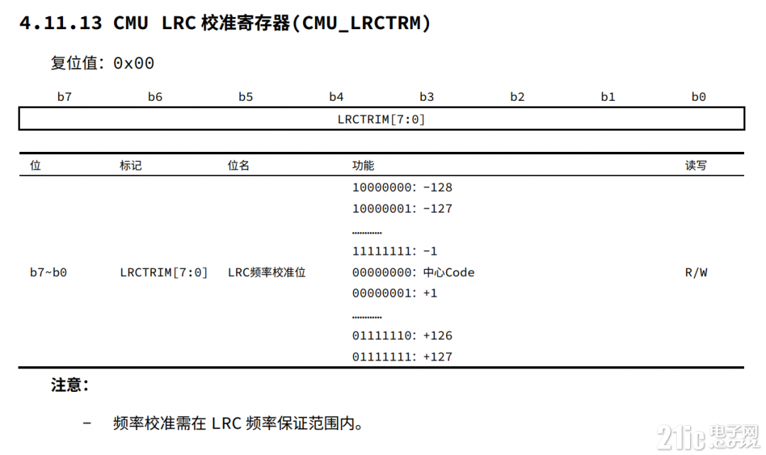

 楼主| jinyuhang123456 发表于 2023-12-28 17:49 | 显示全部楼层 |阅读模式
实名吐槽: 59820658d43eb03d2f.png 手册写的寄存器,根本让人看不懂。参数是什么意义,如何配置?例程也没有。
说不能超过这个范围,所以呢?
我实际测试80s时间,当写入-127的时候,rtc间隔时间是34s;当写入+127的时候,rtc间隔时间是108s。
我的天哪,到底能不能用?
能用的话,怎么用,求官方解答!

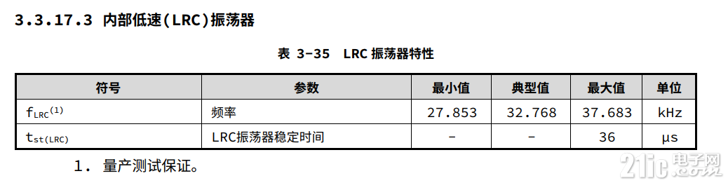

wubangmi 发表于 2023-12-29 08:59 | 显示全部楼层
我的理解校准位从-128~+127,那就是有256档可以给你调节,上面有个中心code0也就是默认值,你把这值往负数调就变慢。往正数调就变快。
至于能不能用,要取决你的项目,这数据实打实的标明了32.768Khz的频率范围是27.853Khz~37.683Khz.也就是精度是正负15%。
你评估自己的项目能忍受这个精度就用,不能忍受这个精度就用外部的32768
 楼主| jinyuhang123456 发表于 2023-12-29 17:36 | 显示全部楼层
我的理解校准位从-128~+127,那就是有256档可以给你调节,上面有个中心code0也就是默认值,你把这值往负数 ...
谢谢您的回复,但是我觉得您理解的可能有所偏差,确实是挡位调节,但是这个挡位跟上下限制关系不大。

a=-79
[14:33:05.082]�ա���2.LRC freq. is 12695 Hz
a=-78
[14:33:05.816]�ա���2.LRC freq. is 12695 Hz
a=-77
[14:33:06.550]�ա���2.LRC freq. is 12695 Hz
a=-76
[14:33:07.301]�ա���2.LRC freq. is 13671 Hz
a=-75
[14:33:08.033]�ա���2.LRC freq. is 12695 Hz
a=-74
[14:33:08.783]�ա���2.LRC freq. is 12695 Hz
a=-73
[14:33:09.517]�ա���2.LRC freq. is 13671 Hz
a=-72
[14:33:10.251]�ա���2.LRC freq. is 12695 Hz
a=-71
[14:33:11.001]�ա���2.LRC freq. is 13671 Hz
a=-70
[14:33:11.735]�ա���2.LRC freq. is 12695 Hz
a=-69
[14:33:12.470]�ա���2.LRC freq. is 12695 Hz
a=-68
[14:33:13.220]�ա���2.LRC freq. is 13671 Hz
a=-67
[14:33:13.954]�ա���2.LRC freq. is 12695 Hz
a=-66
[14:33:14.704]�ա���2.LRC freq. is 12695 Hz
a=-65
[14:33:15.438]�ա���2.LRC freq. is 12695 Hz
a=-64
[14:33:16.170]�ա���2.LRC freq. is 13671 Hz
a=-63
[14:33:16.919]�ա���2.LRC freq. is 13671 Hz
a=-62
[14:33:17.650]�ա���2.LRC freq. is 12695 Hz
a=-61
[14:33:18.402]�ա���2.LRC freq. is 13671 Hz
a=-60
[14:33:19.136]�ա���2.LRC freq. is 13671 Hz
a=-59
[14:33:19.870]�ա���2.LRC freq. is 12695 Hz
a=-58
[14:33:20.620]�ա���2.LRC freq. is 13671 Hz
a=-57
[14:33:21.351]�ա���2.LRC freq. is 12695 Hz
a=-56
[14:33:22.102]�ա���2.LRC freq. is 13671 Hz
a=-55
[14:33:22.832]�ա���2.LRC freq. is 12695 Hz
a=-54
[14:33:23.582]�ա���2.LRC freq. is 13671 Hz
a=-53
[14:33:24.316]�ա���2.LRC freq. is 12695 Hz
a=-52
[14:33:25.050]�ա���2.LRC freq. is 12695 Hz
a=-51
[14:33:25.801]�ա���2.LRC freq. is 12695 Hz
a=-50
[14:33:26.536]�ա���2.LRC freq. is 13671 Hz
a=-49
[14:33:27.271]�ա���2.LRC freq. is 12695 Hz
a=-48
[14:33:28.017]�ա���2.LRC freq. is 12695 Hz
a=-47
[14:33:28.751]�ա���2.LRC freq. is 13671 Hz
a=-46
[14:33:29.502]�ա���2.LRC freq. is 13671 Hz
a=-45
[14:33:30.233]�ա���2.LRC freq. is 14648 Hz
a=-44
[14:33:30.971]�ա���2.LRC freq. is 13671 Hz
a=-43
[14:33:31.721]�ա���2.LRC freq. is 13671 Hz
a=-42
[14:33:32.451]�ա���2.LRC freq. is 14648 Hz
a=-41
[14:33:33.202]�ա���2.LRC freq. is 14648 Hz
a=-40
[14:33:33.936]�ա���2.LRC freq. is 14648 Hz
a=-39
[14:33:34.671]�ա���2.LRC freq. is 15625 Hz
a=-38
[14:33:35.417]�ա���2.LRC freq. is 15625 Hz
a=-37
[14:33:36.151]�ա���2.LRC freq. is 15625 Hz
a=-36
[14:33:36.902]�ա���2.LRC freq. is 15625 Hz
a=-35
[14:33:37.636]�ա���2.LRC freq. is 16601 Hz
a=-34
[14:33:38.384]�ա���2.LRC freq. is 16601 Hz
a=-33
[14:33:39.117]�ա���2.LRC freq. is 16601 Hz
a=-32
[14:33:39.850]�ա���2.LRC freq. is 17578 Hz
a=-31
[14:33:40.599]�ա���2.LRC freq. is 17578 Hz
a=-30
[14:33:41.333]�ա���2.LRC freq. is 18554 Hz
a=-29
[14:33:42.082]�ա���2.LRC freq. is 18554 Hz
a=-28
[14:33:42.816]�ա���2.LRC freq. is 19531 Hz
a=-27
[14:33:43.551]�ա���2.LRC freq. is 19531 Hz
a=-26
[14:33:44.300]�ա���2.LRC freq. is 19531 Hz
a=-25
[14:33:45.034]�ա���2.LRC freq. is 19531 Hz
a=-24
[14:33:45.783]�ա���2.LRC freq. is 20507 Hz
a=-23
[14:33:46.517]�ա���2.LRC freq. is 20507 Hz
a=-22
[14:33:47.266]�ա���2.LRC freq. is 21484 Hz
a=-21
[14:33:48.000]�ա���2.LRC freq. is 20507 Hz
a=-20
[14:33:48.734]�ա���2.LRC freq. is 21484 Hz
a=-19
[14:33:49.485]�ա���2.LRC freq. is 22460 Hz
a=-18
[14:33:50.217]�ա���2.LRC freq. is 23437 Hz
a=-17
[14:33:50.952]�ա���2.LRC freq. is 23437 Hz
a=-16
[14:33:51.702]�ա���2.LRC freq. is 23437 Hz
a=-15
[14:33:52.434]�ա���2.LRC freq. is 23437 Hz
a=-14
[14:33:53.184]�ա���2.LRC freq. is 24414 Hz
a=-13
[14:33:53.917]�ա���2.LRC freq. is 25390 Hz
a=-12
[14:33:54.652]�ա���2.LRC freq. is 25390 Hz
a=-11
[14:33:55.401]�ա���2.LRC freq. is 26367 Hz
a=-10
[14:33:56.134]�ա���2.LRC freq. is 27343 Hz
a=-9
[14:33:56.870]�ա���2.LRC freq. is 27343 Hz
a=-8
[14:33:57.620]�ա���2.LRC freq. is 28320 Hz
a=-7
[14:33:58.352]�ա���2.LRC freq. is 29296 Hz
a=-6
[14:33:59.087]�ա���2.LRC freq. is 29296 Hz
a=-5
[14:33:59.833]�ա���2.LRC freq. is 30273 Hz
a=-4
[14:34:00.567]�ա���2.LRC freq. is 30273 Hz
a=-3
[14:34:01.319]�ա���2.LRC freq. is 30273 Hz
a=-2
[14:34:02.051]�ա���2.LRC freq. is 31250 Hz
a=-1
[14:34:02.784]�ա���2.LRC freq. is 31250 Hz
a=0
[14:34:03.534]�ա���2.LRC freq. is 32226 Hz
a=1
[14:34:04.269]�ա���2.LRC freq. is 33203 Hz
a=2
[14:34:05.000]�ա���2.LRC freq. is 34179 Hz
a=3
[14:34:05.734]�ա���2.LRC freq. is 34179 Hz
a=4
[14:34:06.485]�ա���2.LRC freq. is 34179 Hz
a=5
[14:34:07.216]�ա���2.LRC freq. is 36132 Hz
a=6
[14:34:07.951]�ա���2.LRC freq. is 36132 Hz
a=7
[14:34:08.699]�ա���2.LRC freq. is 37109 Hz
a=8
[14:34:09.433]�ա���2.LRC freq. is 38085 Hz
a=9
[14:34:10.168]�ա���2.LRC freq. is 39062 Hz
a=10
[14:34:10.902]�ա���2.LRC freq. is 40039 Hz
a=11
[14:34:11.651]�ա���2.LRC freq. is 40039 Hz
a=12
[14:34:12.383]�ա���2.LRC freq. is 41015 Hz
a=13
[14:34:13.118]�ա���2.LRC freq. is 41992 Hz
a=14
[14:34:13.866]�ա���2.LRC freq. is 43945 Hz
a=15
[14:34:14.600]�ա���2.LRC freq. is 42968 Hz
a=16
[14:34:15.336]�ա���2.LRC freq. is 42968 Hz
a=17
[14:34:16.083]�ա���2.LRC freq. is 42968 Hz
a=18
[14:34:16.817]�ա���2.LRC freq. is 42968 Hz
a=19
[14:34:17.553]�ա���2.LRC freq. is 42968 Hz
a=20
[14:34:18.303]�ա���2.LRC freq. is 42968 Hz
a=21
[14:34:19.034]�ա���2.LRC freq. is 42968 Hz
a=22
[14:34:19.771]�ա���2.LRC freq. is 42968 Hz
a=23
[14:34:20.516]�ա���2.LRC freq. is 43945 Hz
a=24
[14:34:21.250]�ա���2.LRC freq. is 42968 Hz
a=25
[14:34:21.999]�ա���2.LRC freq. is 42968 Hz
a=26
[14:34:22.734]�ա���2.LRC freq. is 43945 Hz
a=27
[14:34:23.467]�ա���2.LRC freq. is 42968 Hz
a=28
[14:34:24.202]�ա���2.LRC freq. is 42968 Hz
a=29
[14:34:24.952]�ա���2.LRC freq. is 42968 Hz
a=30
[14:34:25.682]�ա���2.LRC freq. is 42968 Hz
a=31
[14:34:26.434]�ա���2.LRC freq. is 42968 Hz
a=32
[14:34:27.168]�ա���2.LRC freq. is 42968 Hz
a=33
[14:34:27.900]�ա���2.LRC freq. is 43945 Hz
a=34
[14:34:28.637]�ա���2.LRC freq. is 42968 Hz
a=35
[14:34:29.383]�ա���2.LRC freq. is 42968 Hz
a=36
[14:34:30.117]�ա���2.LRC freq. is 42968 Hz
a=37
[14:34:30.867]�ա���2.LRC freq. is 42968 Hz
a=38
[14:34:31.601]�ա���2.LRC freq. is 42968 Hz
a=39
[14:34:32.335]�ա���2.LRC freq. is 43945 Hz
a=40
[14:34:33.071]�ա���2.LRC freq. is 43945 Hz
a=41
[14:34:33.817]�ա���2.LRC freq. is 42968 Hz
a=42
[14:34:34.551]�ա���2.LRC freq. is 42968 Hz
a=43
[14:34:35.301]�ա���2.LRC freq. is 42968 Hz
a=44
[14:34:36.034]�ա���2.LRC freq. is 42968 Hz
a=45
[14:34:36.767]�ա���2.LRC freq. is 42968 Hz
a=46
[14:34:37.516]�ա���2.LRC freq. is 42968 Hz
a=47
[14:34:38.251]�ա���2.LRC freq. is 42968 Hz
a=48
[14:34:38.985]�ա���2.LRC freq. is 42968 Hz
a=49
[14:34:39.735]�ա���2.LRC freq. is 42968 Hz
a=50
[14:34:40.468]�ա���2.LRC freq. is 42968 Hz
a=51
[14:34:41.202]�ա���2.LRC freq. is 42968 Hz
a=52
[14:34:41.952]�ա���2.LRC freq. is 42968 Hz
a=53
[14:34:42.683]�ա���2.LRC freq. is 42968 Hz
a=54
[14:34:43.417]�ա���2.LRC freq. is 43945 Hz
a=55
[14:34:44.168]�ա���2.LRC freq. is 42968 Hz
a=56
[14:34:44.899]�ա���2.LRC freq. is 42968 Hz
a=57
[14:34:45.649]�ա���2.LRC freq. is 42968 Hz
a=58
[14:34:46.383]�ա���2.LRC freq. is 43945 Hz
a=59
[14:34:47.116]�ա���2.LRC freq. is 42968 Hz
a=60
[14:34:47.852]�ա���2.LRC freq. is 43945 Hz
a=61
[14:34:48.602]�ա���2.LRC freq. is 42968 Hz
a=62
[14:34:49.336]�ա���2.LRC freq. is 42968 Hz
a=63
[14:34:50.070]�ա���2.LRC freq. is 43945 Hz
a=64
[14:34:50.819]�ա���2.LRC freq. is 42968 Hz
a=65
[14:34:51.553]�ա���2.LRC freq. is 42968 Hz
a=66
[14:34:52.287]�ա���2.LRC freq. is 42968 Hz
a=67
[14:34:53.037]�ա���2.LRC freq. is 43945 Hz
a=68
[14:34:53.767]�ա���2.LRC freq. is 42968 Hz
a=69
[14:34:54.517]�ա���2.LRC freq. is 43945 Hz
a=70
[14:34:55.249]�ա���2.LRC freq. is 42968 Hz
a=71
[14:34:55.982]�ա���2.LRC freq. is 42968 Hz
a=72
[14:34:56.732]�ա���2.LRC freq. is 42968 Hz
a=73
[14:34:57.466]�ա���2.LRC freq. is 42968 Hz
a=74
[14:34:58.200]�ա���2.LRC freq. is 42968 Hz
a=75
[14:34:58.938]�ա���2.LRC freq. is 42968 Hz
a=76
[14:34:59.683]�ա���2.LRC freq. is 42968 Hz
a=77
[14:35:00.417]�ա���2.LRC freq. is 42968 Hz
a=78
[14:35:01.167]�ա���2.LRC freq. is 43945 Hz
a=79
[14:35:01.902]�ա���2.LRC freq. is 42968 Hz
a=80
[14:35:02.634]�ա���2.LRC freq. is 43945 Hz
a=81
[14:35:03.371]�ա���2.LRC freq. is 42968 Hz
a=82
[14:35:04.117]�ա���2.LRC freq. is 42968 Hz
a=83
[14:35:04.850]�ա���2.LRC freq. is 43945 Hz
a=84
[14:35:05.602]�ա���2.LRC freq. is 42968 Hz
a=85
[14:35:06.336]�ա���2.LRC freq. is 42968 Hz
a=86
[14:35:07.067]�ա���2.LRC freq. is 42968 Hz
a=87
[14:35:07.818]�ա���2.LRC freq. is 42968 Hz
a=88
[14:35:08.551]�ա���2.LRC freq. is 42968 Hz
a=89
[14:35:09.284]�ա���2.LRC freq. is 42968 Hz
a=90
[14:35:10.035]�ա���2.LRC freq. is 42968 Hz
a=91
[14:35:10.767]�ա���2.LRC freq. is 42968 Hz
a=92
[14:35:11.501]�ա���2.LRC freq. is 42968 Hz
a=93
[14:35:12.253]�ա���2.LRC freq. is 42968 Hz
a=94
[14:35:12.982]�ա���2.LRC freq. is 42968 Hz
a=95
[14:35:13.719]�ա���2.LRC freq. is 42968 Hz
a=96
[14:35:14.468]�ա���2.LRC freq. is 42968 Hz
a=97
[14:35:15.200]�ա���2.LRC freq. is 42968 Hz
a=98
[14:35:15.935]�ա���2.LRC freq. is 42968 Hz
a=99
[14:35:16.685]�ա���2.LRC freq. is 42968 Hz
a=100
[14:35:17.416]�ա���2.LRC freq. is 42968 Hz
a=101
[14:35:18.166]�ա���2.LRC freq. is 42968 Hz
a=102
[14:35:18.900]�ա���2.LRC freq. is 42968 Hz
a=103
[14:35:19.634]�ա���2.LRC freq. is 43945 Hz
a=104
[14:35:20.384]�ա���2.LRC freq. is 42968 Hz
a=105
[14:35:21.117]�ա���2.LRC freq. is 42968 Hz
a=106
[14:35:21.853]�ա���2.LRC freq. is 42968 Hz
a=107
[14:35:22.603]�ա���2.LRC freq. is 42968 Hz
a=108
[14:35:23.337]�ա���2.LRC freq. is 42968 Hz
a=109
[14:35:24.083]�ա���2.LRC freq. is 42968 Hz
a=110
[14:35:24.817]�ա���2.LRC freq. is 42968 Hz
a=111
[14:35:25.567]�ա���2.LRC freq. is 42968 Hz
a=112
[14:35:26.300]�ա���2.LRC freq. is 42968 Hz
a=113
[14:35:27.035]�ա���2.LRC freq. is 42968 Hz
a=114
[14:35:27.785]�ա���2.LRC freq. is 42968 Hz
a=115
[14:35:28.517]�ա���2.LRC freq. is 42968 Hz
a=116
[14:35:29.266]�ա���2.LRC freq. is 43945 Hz
a=117
[14:35:30.001]�ա���2.LRC freq. is 42968 Hz
a=118
[14:35:30.735]�ա���2.LRC freq. is 43945 Hz
a=119
[14:35:31.484]�ա���2.LRC freq. is 42968 Hz
a=120
[14:35:32.218]�ա���2.LRC freq. is 42968 Hz
a=121
[14:35:32.967]�ա���2.LRC freq. is 42968 Hz
a=122
[14:35:33.701]�ա���2.LRC freq. is 42968 Hz
a=123
[14:35:34.435]�ա���2.LRC freq. is 42968 Hz
a=124
[14:35:35.185]�ա���2.LRC freq. is 42968 Hz
a=125
[14:35:35.919]�ա���2.LRC freq. is 42968 Hz
a=126
[14:35:36.655]�ա���2.LRC freq. is 42968 Hz
a=127
[14:35:37.400]�ա���2.LRC freq. is 42968 Hz
a=-128
[14:35:38.150]�ա���2.LRC freq. is 12695 Hz
a=-127
[14:35:38.884]�ա���2.LRC freq. is 13671 Hz
a=-126
[14:35:39.617]�ա���2.LRC freq. is 13671 Hz
a=-125
[14:35:40.366]�ա���2.LRC freq. is 13671 Hz
a=-124
 楼主| jinyuhang123456 发表于 2023-12-29 17:39 | 显示全部楼层
我实测了这个校准寄存器和LRC的频率的关系,发现结论:这个校准寄存器不建议使用!
20
20
