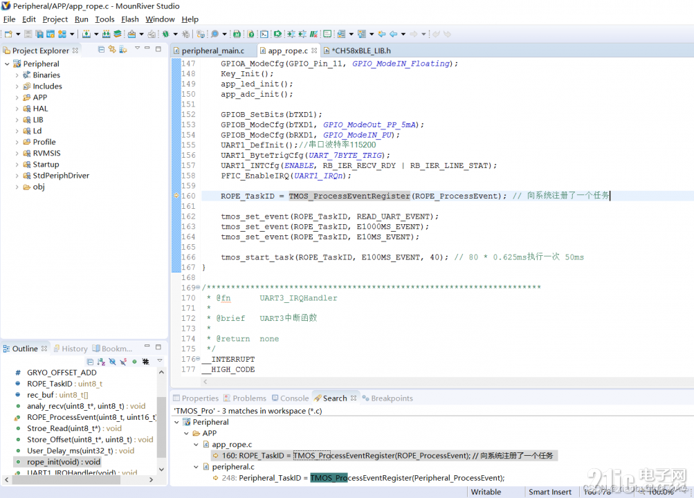

1.MounRiver Studio
这是一款面向RISC-V,ARM等内核MCU集成开发环境,界面如下,感兴趣的可以自行下载。
2.注册任务ID
ID定义是全局变量。
代码如下(示例):
uint8_t ROPE_TaskID = INVALID_TASK_ID; // Task ID for internal task/event processing
ROPE_TaskID = TMOS_ProcessEventRegister(ROPE_ProcessEvent); // 向系统注册了一个任务
* @brief   register process event callback function//注册处理事件回调函数
* @param   eventCb-events callback function//事件回调函数
* @return  0xFF - error,others-task id//错误,其他-任务id
extern tmosTaskID TMOS_ProcessEventRegister( pTaskEventHandlerFn eventCb );

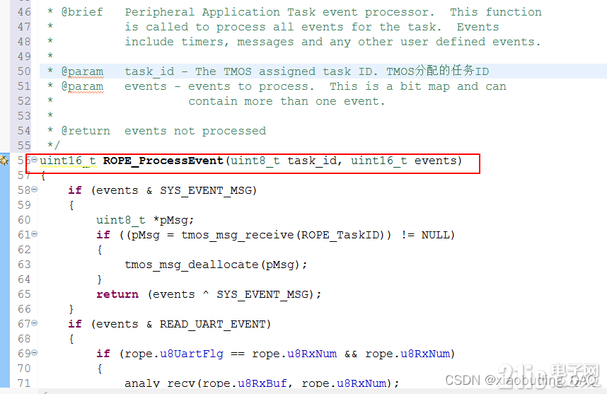

4.编写任务处理程序
代码如下(示例):
* @fn      Peripheral_ProcessEvent
* @brief   Peripheral Application Task event processor.  This function
*          is called to process all events for the task.  Events
*          include timers, messages and any other user defined events.
* @param   task_id - The TMOS assigned task ID. TMOS分配的任务ID
* @param   events - events to process.  This is a bit map and can
*                   contain more than one event.
* @return  events not processed
uint16_t ROPE_ProcessEvent(uint8_t task_id, uint16_t events)
    if (events & SYS_EVENT_MSG)
        uint8_t *pMsg;
        if ((pMsg = tmos_msg_receive(ROPE_TaskID)) != NULL)
            tmos_msg_deallocate(pMsg);
        return (events ^ SYS_EVENT_MSG);
    ........省略
