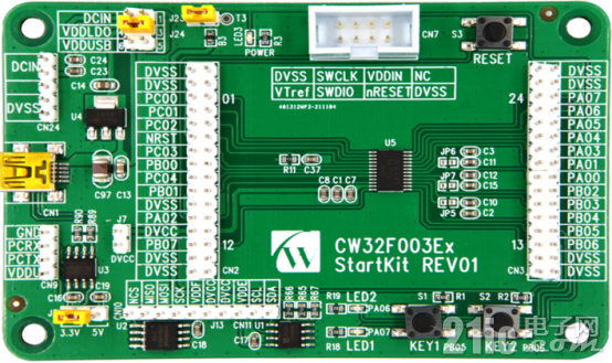

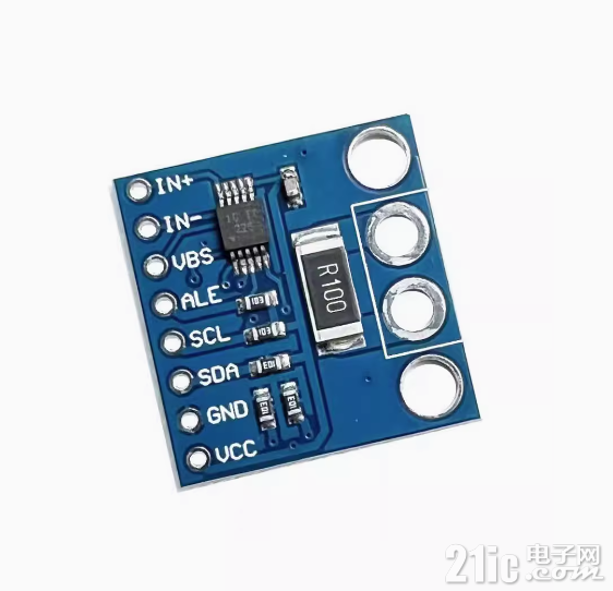

接下来就是INA226的一些配置,配置采集电流和电压,通过电流和电压算出功率。
- void INA226_Init(void)
- INA226_IIC_Init();
- delay_nms(10);
- INA226_SendData(WRITE_ADDR,0x00,0x4727);//初始化结果采用64次平均值,全功能,连续模式
- INA226_SendData(WRITE_ADDR,0x05,0xE800);//(当单位为mA时:0.002R=0xA00;0.01R=0x200);(上限8A)
- INA226_Get_ID(WRITE_ADDR);

- //1.25mV/bit
- uint16_t INA226_GetVoltage(uint8_t addr)
- uint16_t temp=0;
- INA226_SetRegPointer(addr,Bus_V_Reg);
- temp = INA226_ReadData(addr);
- return temp;
- //2.5uV/bit
- uint16_t INA226_GetShuntVoltage(uint8_t addr)
- uint16_t temp=0;
- INA226_SetRegPointer(addr,Shunt_V_Reg);
- if(temp&0x8000) temp = ~(temp - 1);
- return temp;
- //2.5mW/bit
- uint16_t INA226_Get_Power(uint8_t addr)
- uint16_t temp=0;
- INA226_SetRegPointer(addr,Power_Reg);
- return temp;

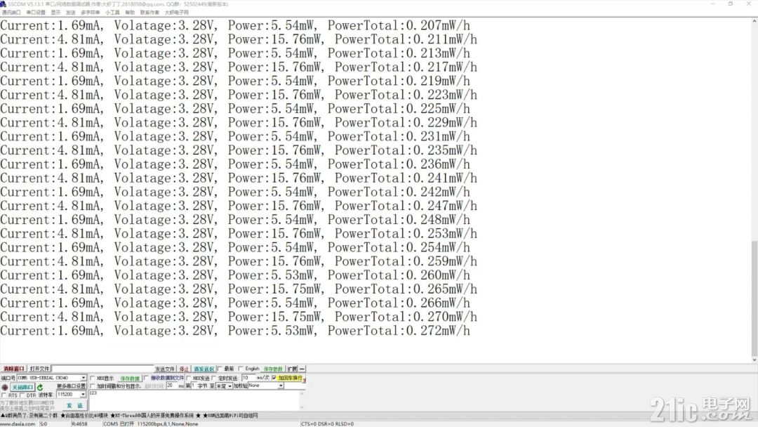

配置对于的参数,设置电流电压的系数,然后将数据通过串口发送给上位机
其中控制板载LED亮灭,这样可以采集出不同的功率。
- while(1)
- voltage_value = INA226_GetVoltage(WRITE_ADDR)*1.25f*0.001f;
- current_value = INA226_GetShuntCurrent(WRITE_ADDR)*0.002f;
- power_value = voltage_value * current_value;
- power_total_value += power_value / 3600;
- sprintf(uart_send, "Current:%.2fmA, Volatage:%.2fV, Power:%.2fmW, PowerTotal:%.3fmW/h\r\n", current_value, voltage_value, current_value * voltage_value, power_total_value);
- USART_SendBuf_Polling(DEBUG_USARTx, (uint8_t *)uart_send, strlen(uart_send));
- FirmwareDelay(1000000);
- GPIO_TogglePin(CW_GPIOA, GPIO_PIN_7);
- GPIO_TogglePin(CW_GPIOA, GPIO_PIN_6);
4、上机演示
将开发板串口接入PC,打开串口调试助手,可以看到能一直收到开发板的电源状态信息。
视频演示:
