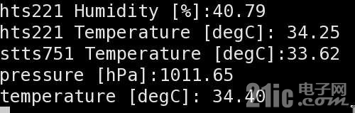

- while (1) {
- hts221_read_data_polling();
- stts751_read_data_polling();
- lps22hh_read_data_polling();
- HAL_Delay(1000);
烧录测试
