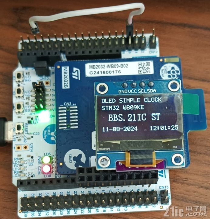

从STM32WB09KE的数据手册看到,片上外设包含一个I2C:
System peripherals
– 1x DMA controller with 8 channels supporting ADC, SPI, I2C, USART, LPUART, Timers
– 1x SPI with I2S interface multiplexed–
1x I2C (SMBus/PMBus)
– 1x LPUART (low power)
– 1x USART (ISO 7816 smartcard mode, IrDA, SPI master and modbus)
– 1x independent WDG
– 1x real time clock (RTC)
– 1x independent SysTick
– 1x 16-bit, four channels general purpose timer
– 2x 16-bit, two channels general purpose timer
– Infrared interface
从开发板原理图,在母版的CN4连接器上引出了I2C功能引脚。
I2C_SCL PB6 D15 GPIO28
I2C_SDA PB7 D14 GPIO29
因此可以用来驱动I2C接口的屏幕:
接下来初始化I2C模块,

主程序:
  1. int main(void)
  3.   /* USER CODE BEGIN 1 */
  4.   /* USER CODE END 1 */
  5.   /* MCU Configuration--------------------------------------------------------*/
  6.   /* Reset of all peripherals, Initializes the Flash interface and the Systick. */
  7.   HAL_Init();
  8.   /* USER CODE BEGIN Init */
  9.   /* USER CODE END Init */
  10.   /* Configure the system clock */
  11.   SystemClock_Config();
  12.   /* Configure the peripherals common clocks */
  13.   PeriphCommonClock_Config();
  14.   /* USER CODE BEGIN SysInit */
  15.   /* USER CODE END SysInit */
  16.   /* Initialize all configured peripherals */
  17.   MX_GPIO_Init();
  18.   MX_I2C1_Init();
  19.   MX_RTC_Init();
  20.   /* USER CODE BEGIN 2 */
  21.   OLED_Init();
  22.   OLED_Refresh();
  23.   HAL_Delay(500);
  24.   /* USER CODE END 2 */
  25.   /* Initialize leds */
  26.   BSP_LED_Init(LED_BLUE);
  27.   BSP_LED_Init(LED_GREEN);
  28.   BSP_LED_Init(LED_RED);
  29.   /* Initialize USER push-button, will be used to trigger an interrupt each time it's pressed.*/
  30.   BSP_PB_Init(B1, BUTTON_MODE_EXTI);
  31.   BSP_PB_Init(B2, BUTTON_MODE_EXTI);
  32.   BSP_PB_Init(B3, BUTTON_MODE_EXTI);
  33.   /* Initialize COM1 port (115200, 8 bits (7-bit data + 1 stop bit), no parity */
  34.   BspCOMInit.BaudRate   = 115200;
  35.   BspCOMInit.WordLength = COM_WORDLENGTH_8B;
  36.   BspCOMInit.StopBits   = COM_STOPBITS_1;
  37.   BspCOMInit.Parity     = COM_PARITY_NONE;
  38.   BspCOMInit.HwFlowCtl  = COM_HWCONTROL_NONE;
  39.   if (BSP_COM_Init(COM1, &BspCOMInit) != BSP_ERROR_NONE)
  40.   {
  41.     Error_Handler();
  42.   }
  43.   /* Infinite loop */
  44.   /* USER CODE BEGIN WHILE */
  45.   printf("\r\n LED, Button, COM all Init Done");
  46.   while (1)
  47.   {
  48.     /* USER CODE END WHILE */
  49.     /* USER CODE BEGIN 3 */
  50.           static uint8_t i;
  51.           printf("\r\n idle main loop, current date: %s, current time: %s", aShowDate, aShowTime);
  52.           //printf("\r\nOLED TEST MODE: CLEAR SCREEN AND REFRESH WITH 1000ms DELAY. (%d)", i++);
  53.           OLED_Clear();
  54.           OLED_ShowString(0,0,"OLED SIMPLE CLOCK",8,1);
  55.           OLED_ShowString(0,12,"STM32 WB09KE",8,1);
  56.           OLED_ShowString(12,24,"BBS.21IC ST",16,1);
  57.           OLED_ShowString(0,48,aShowDate,8,1);
  58.           OLED_ShowString(80,48,aShowTime,8,1);
  59.           OLED_Refresh();
  60.           RTC_CalendarShow(aShowTime, aShowDate);
  61.           HAL_Delay(100);
  62.   }
  63.   /* USER CODE END 3 */
  64. }
烧录,最终效果:
