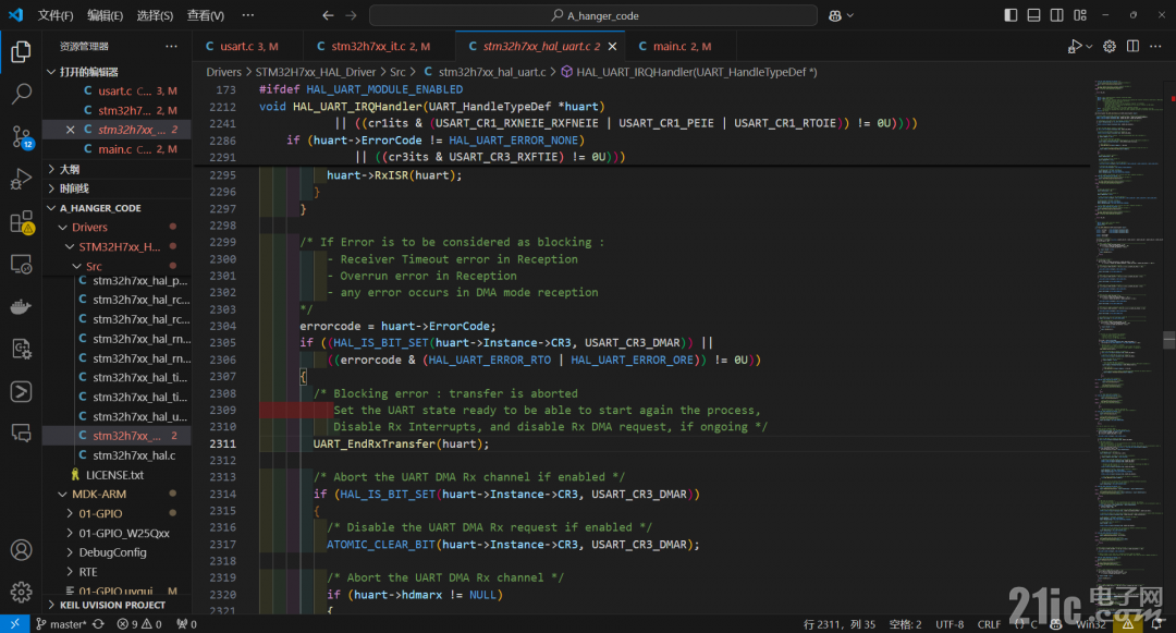

HAL_UART_IRQHandler中的UART_EndRxTransfer函数导致所有中断使能标志位被清除
进入这个函数的原因是因为我是用DMA来传输数据,如果这时候发生了任何错误,都会进入这个函数,看看这个函数原型
  * @brief  End ongoing Rx transfer on UART peripheral (following error detection or Reception completion).
  * @param  huart UART handle.
  * @retval None
static void UART_EndRxTransfer(UART_HandleTypeDef *huart)
  /* Disable RXNE, PE and ERR (Frame error, noise error, overrun error) interrupts */
  ATOMIC_CLEAR_BIT(huart->Instance->CR1, (USART_CR1_RXNEIE_RXFNEIE | USART_CR1_PEIE));
  ATOMIC_CLEAR_BIT(huart->Instance->CR3, (USART_CR3_EIE | USART_CR3_RXFTIE));
  /* In case of reception waiting for IDLE event, disable also the IDLE IE interrupt source */
  if (huart->ReceptionType == HAL_UART_RECEPTION_TOIDLE)
    ATOMIC_CLEAR_BIT(huart->Instance->CR1, USART_CR1_IDLEIE);
  /* At end of Rx process, restore huart->RxState to Ready */
  huart->RxState = HAL_UART_STATE_READY;
  huart->ReceptionType = HAL_UART_RECEPTION_STANDARD;
  /* Reset RxIsr function pointer */
  huart->RxISR = NULL;
