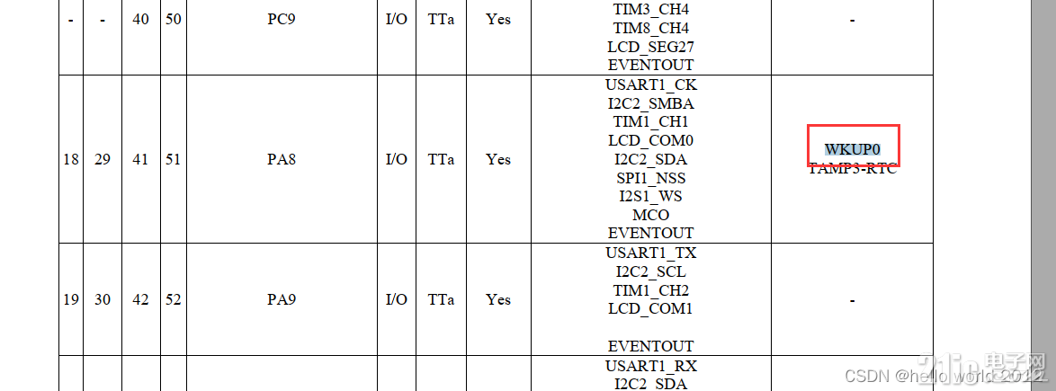

 楼主| renzheshengui 发表于 2025-3-22 19:01 | 显示全部楼层 |阅读模式

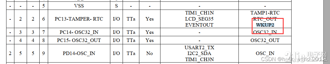

根据上图所示只有如上三个IO可以做Standby唤醒脚。
代码如下
#include "main.h"
#include "Standby.h"
#include "n32l40x_pwr.h"
void Wakeup_Pin_Config(void)
    GPIO_InitType GPIO_InitStructure;
    GPIO_InitStruct(&GPIO_InitStructure);
    RCC_EnableAPB2PeriphClk(RCC_APB2_PERIPH_GPIOA, ENABLE);
    GPIO_InitStructure.Pin        = GPIO_PIN_0;
    GPIO_InitStructure.GPIO_Mode  = GPIO_Mode_Input;
    GPIO_InitStructure.GPIO_Pull  = GPIO_Pull_Down;
    GPIO_InitPeripheral(GPIOA, &GPIO_InitStructure);
void Wakeup_Config(void)
        RCC_EnableAPB1PeriphClk(RCC_APB1_PERIPH_PWR, ENABLE);
        PWR_WakeUpPinEnable(WAKEUP_PIN1,ENABLE);
        if(PWR_GetFlagStatus(1,PWR_STBY_FLAG) != RESET)
                PWR_ClearFlag(PWR_STBY_FLAG);
        if(PWR_GetFlagStatus(1,PWR_WKUP1_FLAG) != RESET)
                PWR_ClearFlag(PWR_WKUP1_FLAG);
        printf("PWR_EnterSTANDBYMode \r\n");
        PWR_EnterSTANDBYMode(PWR_STOPENTRY_WFI,PWR_CTRL3_RAM2RET);
