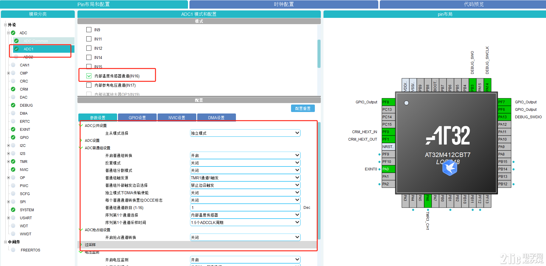

三:AT32 work bench 软件配置:

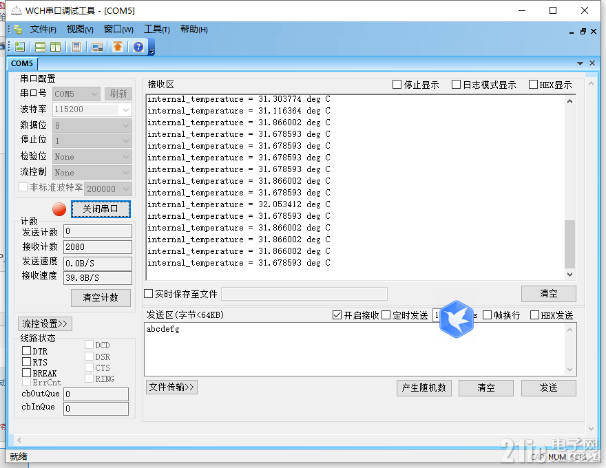

  1.     at32_led_toggle(LED2);
  2.     delay_sec(1);
  3.     /* adc1 software trigger start conversion */
  4.     adc_ordinary_software_trigger_enable(ADC1, TRUE);
  5.     while(dma_flag_get(DMA1_FDT1_FLAG) == RESET);
  6.     dma_flag_clear(DMA1_FDT1_FLAG);
  7.     printf("internal_temperature = %f deg C\r\n",(ADC_TEMP_BASE-(double)adc1_ordinary_value*ADC_VREF/4095)/ADC_TEMP_SLOPE+25);
五:实物测试如下:
