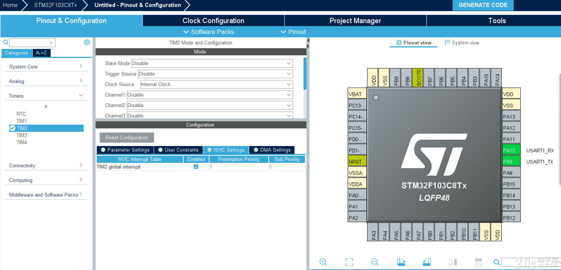

接下来是hal库版本的
然后是代码
#include "stm32f1xx_hal.h"
TIM_HandleTypeDef htim2;
volatile uint32_t timerOverflowCount = 0;
void HAL_TIM_PeriodElapsedCallback(TIM_HandleTypeDef *htim)
    if (htim->Instance == TIM2)
        timerOverflowCount++;
void delay_ms(uint32_t milliseconds)
    uint32_t startCount = timerOverflowCount;
    while ((timerOverflowCount - startCount) < milliseconds)
        // 等待
在主函数直接调用
int main(void)
        Led_Init();
        OLED_Init();
        while(1)
                Led_On();
                delay_ms(300);
                Led_Off();
                delay_ms(300);
