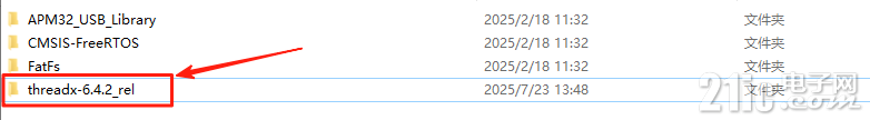

1. 首先将ThreadX 源码拷贝到 ..\APM32F402_403_SDK_V1.0.1\Middlewares 文件夹下

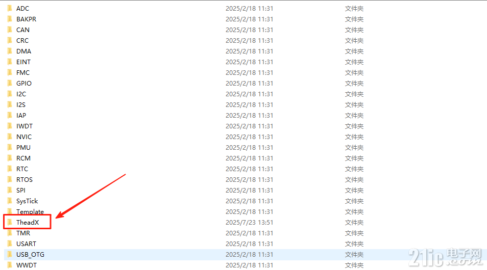

2. 拷贝官方SDK示例文件夹中的SysTick副本,并命名为ThreadX作为工程文件夹

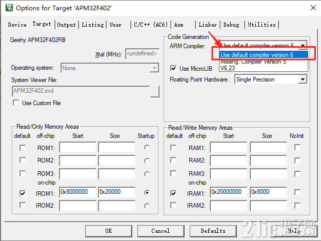

7. 更改默认编译器为AC6

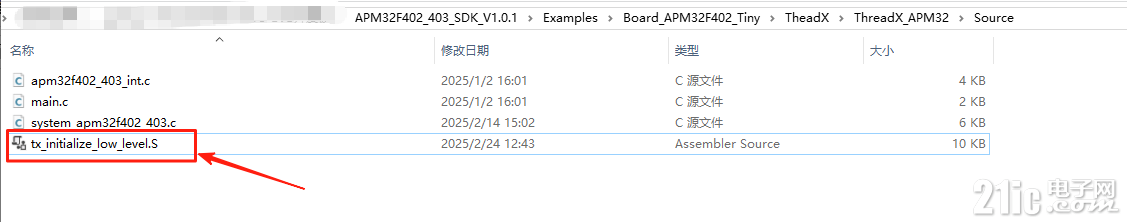

10. 修改tx_initialize_low_level.s中的时钟、堆栈以及中断向量表设置:

  126. @    /* Configure SysTick for 100Hz clock, or 16384 cycles if no reference.  */
  127. @
  128.     MOV     r0, #0xE000E000                         @ Build address of NVIC registers
  129.     LDR     r1, =SYSTICK_CYCLES
  130.     STR     r1, [r0, #0x14]                         @ Setup SysTick Reload Value
  131.     MOV     r1, #0x7                                @ Build SysTick Control Enable Value
  132.     STR     r1, [r0, #0x10]                         @ Setup SysTick Control
  133. @
  134. @    /* Configure handler priorities.  */
  135. @
  136.     LDR     r1, =0x00000000                         @ Rsrv, UsgF, BusF, MemM
  137.     STR     r1, [r0, #0xD18]                        @ Setup System Handlers 4-7 Priority Registers
  138.     LDR     r1, =0xFF000000                         @ SVCl, Rsrv, Rsrv, Rsrv
  139.     STR     r1, [r0, #0xD1C]                        @ Setup System Handlers 8-11 Priority Registers
  140.                                                     @ Note: SVC must be lowest priority, which is 0xFF
  141.     LDR     r1, =0x40FF0000                         @ SysT, PnSV, Rsrv, DbgM
  142.     STR     r1, [r0, #0xD20]                        @ Setup System Handlers 12-15 Priority Registers
  143.                                                     @ Note: PnSV must be lowest priority, which is 0xFF
  144. @
  145. @    /* Return to caller.  */
  146. @
  147.     BX      lr
  148. @}
  149. @

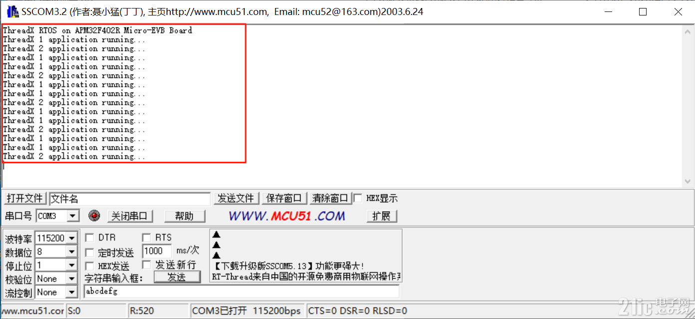

11. 编写tx_application_ entry.c源程序,创建两个线程,并设置优先级:
为了验证系统工作正常,我写了两个简单的任务:
  • 第一个任务控制LED2,每0.5秒闪烁一次
  • 第二个任务控制LED3,每1秒闪烁一次
  • 两个任务都会通过串口输出运行状态

13. 编译下载程序:
14. 查看串口输出及LED灯的变化:
