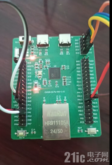

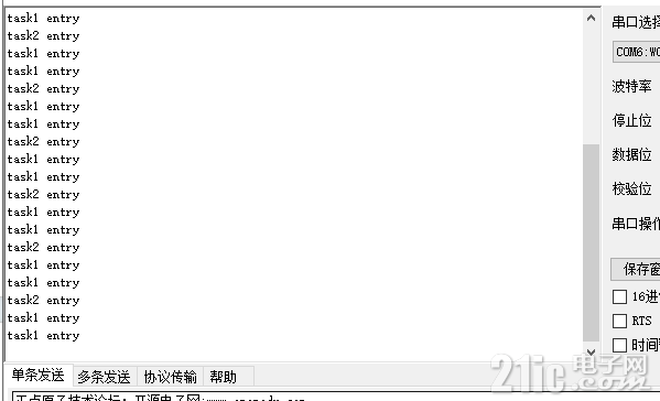

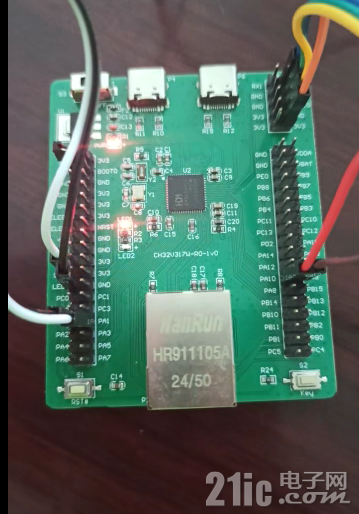

    6. 测试
    WCH 的 MounRiver Studio 使用 RISC-V GCC 工具链,需确保链接脚本(.ld)保留 FreeRTOS 所需的内存区域(如栈、堆)。
    中断向量表可能需手动对齐。
  • 初始化硬件:在main()中先初始化时钟和外设,再启动FreeRTOS调度器:
    1. #include "debug.h"
    2. #include "FreeRTOS.h"
    3. #include "task.h"
    4. /* Global define */
    5. #define TASK1_TASK_PRIO     5
    6. #define TASK1_STK_SIZE      256
    7. #define TASK2_TASK_PRIO     5
    8. #define TASK2_STK_SIZE      256
    9. /* Global Variable */
    10. TaskHandle_t Task1Task_Handler;
    11. TaskHandle_t Task2Task_Handler;
    12. void GPIO_Toggle_INIT(void)
    13. {
    14.   GPIO_InitTypeDef  GPIO_InitStructure={0};
    15.   RCC_APB2PeriphClockCmd(RCC_APB2Periph_GPIOA,ENABLE);
    16.   GPIO_InitStructure.GPIO_Pin = GPIO_Pin_0|GPIO_Pin_1;
    17.   GPIO_InitStructure.GPIO_Mode = GPIO_Mode_Out_PP;
    18.   GPIO_InitStructure.GPIO_Speed=GPIO_Speed_50MHz;
    19.   GPIO_Init(GPIOA, &GPIO_InitStructure);
    20. }
    21. void task1_task(void *pvParameters)
    22. {
    23.     while(1)
    24.     {
    25.         printf("task1 entry\r\n");
    26.         GPIO_SetBits(GPIOA, GPIO_Pin_0);
    27.         vTaskDelay(250);
    28.         GPIO_ResetBits(GPIOA, GPIO_Pin_0);
    29.         vTaskDelay(250);
    30.     }
    31. }
    32. /*********************************************************************
    33. * @fn      task2_task
    34. *
    35. * [url=home.php?mod=space&uid=247401]@brief[/url]   task2 program.
    36. *
    37. * @param  *pvParameters - Parameters point of task2
    38. *
    39. * [url=home.php?mod=space&uid=266161]@return[/url]  none
    40. */
    41. void task2_task(void *pvParameters)
    42. {
    43.     while(1)
    44.     {
    45.         printf("task2 entry\r\n");
    46.         GPIO_ResetBits(GPIOA, GPIO_Pin_1);
    47.         vTaskDelay(500);
    48.         GPIO_SetBits(GPIOA, GPIO_Pin_1);
    49.         vTaskDelay(500);
    50.     }
    51. }
    52. /*********************************************************************
    53. * @fn      main
    54. *
    55. * [url=home.php?mod=space&uid=247401]@brief[/url]   Main program.
    56. *
    57. * [url=home.php?mod=space&uid=266161]@return[/url]  none
    58. */
    59. int main(void)
    60. {
    61.         NVIC_PriorityGroupConfig(NVIC_PriorityGroup_2);
    62.         SystemCoreClockUpdate();
    63.         Delay_Init();
    64.         USART_Printf_Init(115200);
    65.
    66.         printf("SystemClk:%d\r\n",SystemCoreClock);
    67.         printf( "ChipID:%08x\r\n", DBGMCU_GetCHIPID() );
    68.         printf("FreeRTOS Kernel Version:%s\r\n",tskKERNEL_VERSION_NUMBER);
    69.         GPIO_Toggle_INIT();
    70.         /* create two task */
    71.     xTaskCreate((TaskFunction_t )task2_task,
    72.                         (const char*    )"task2",
    73.                         (uint16_t       )TASK2_STK_SIZE,
    74.                         (void*          )NULL,
    75.                         (UBaseType_t    )TASK2_TASK_PRIO,
    76.                         (TaskHandle_t*  )&Task2Task_Handler);
    77.     xTaskCreate((TaskFunction_t )task1_task,
    78.                     (const char*    )"task1",
    79.                     (uint16_t       )TASK1_STK_SIZE,
    80.                     (void*          )NULL,
    81.                     (UBaseType_t    )TASK1_TASK_PRIO,
    82.                     (TaskHandle_t*  )&Task1Task_Handler);
    83.     vTaskStartScheduler();
    84.         while(1)
    85.         {
    86.             printf("shouldn't run at here!!\n");
    87.         }
    88. }
关键代码修改总结
1.FreeRTOSConfig.h:配置时钟、堆大小、任务优先级等。
2.port.c:适配 RISC-V 的上下文切换和定时器中断。
3.链接脚本(.ld):确保内存布局正确。
4.中断服务函数:替换默认 SysTick 为硬件定时器。
