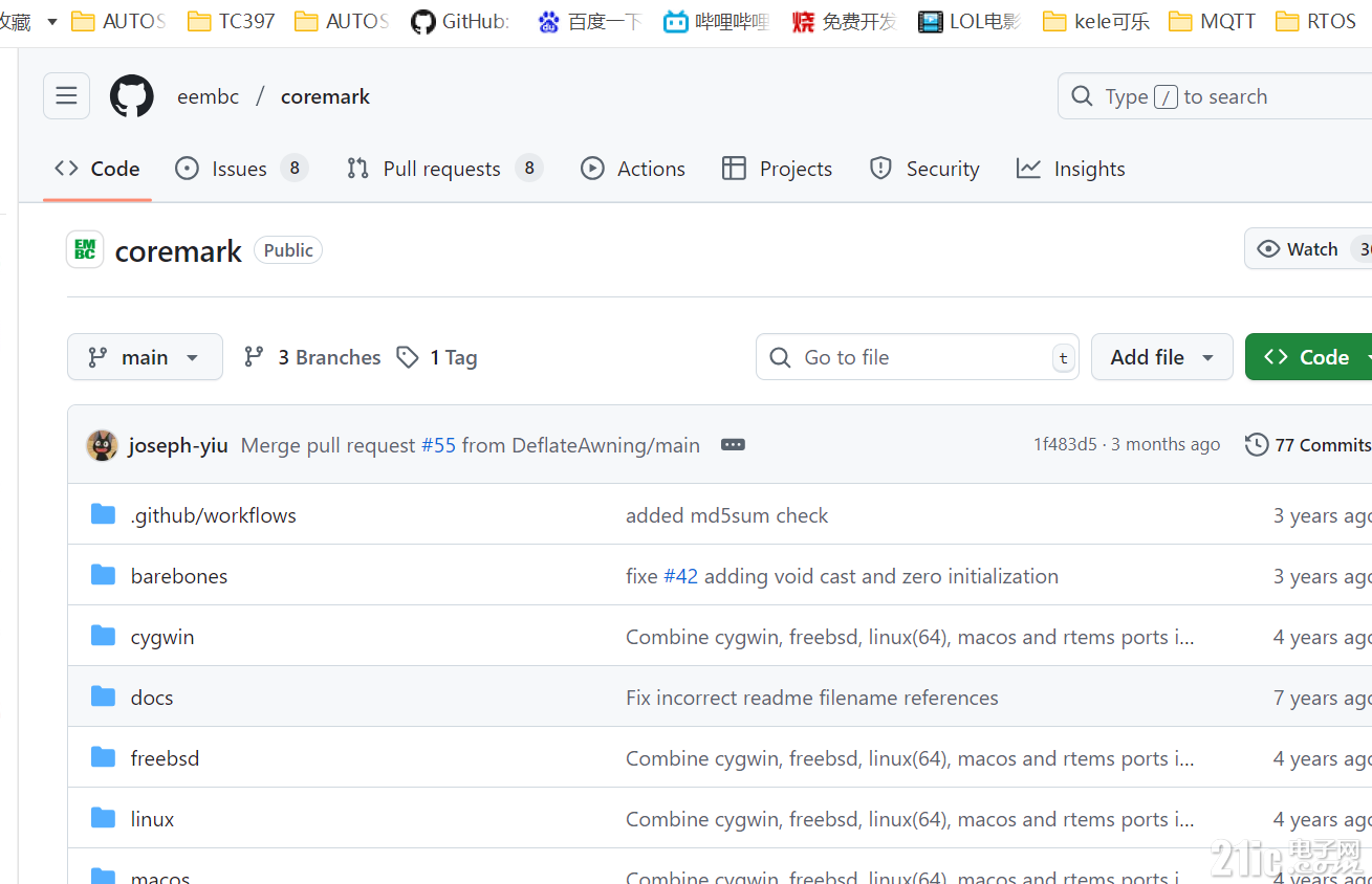

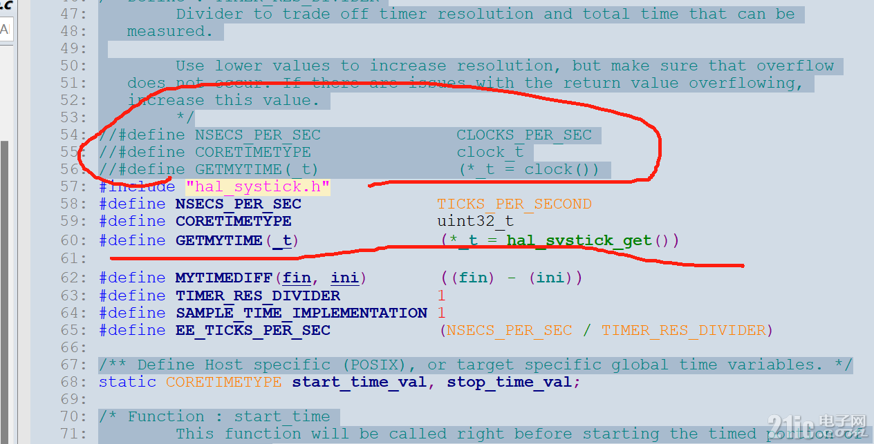

#申请开发板# #申请原创# 很荣幸收到极海赠送的APM32E030开发板,今天来测试一下跑分性能。首先从github上下载coremark源代码库

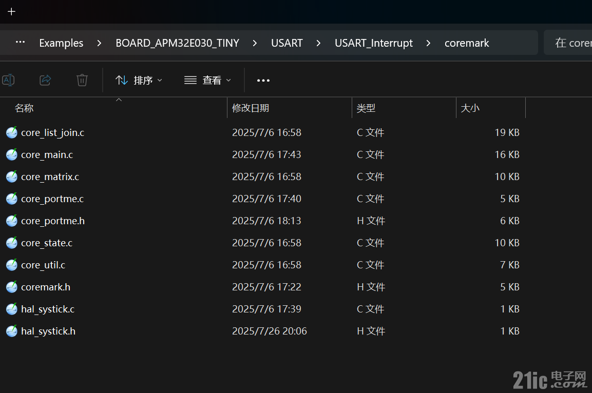

coremark
我只需要其中这几个文件,把它们放在一个文件夹里
然后添加到KEIL工程里面
开始修改

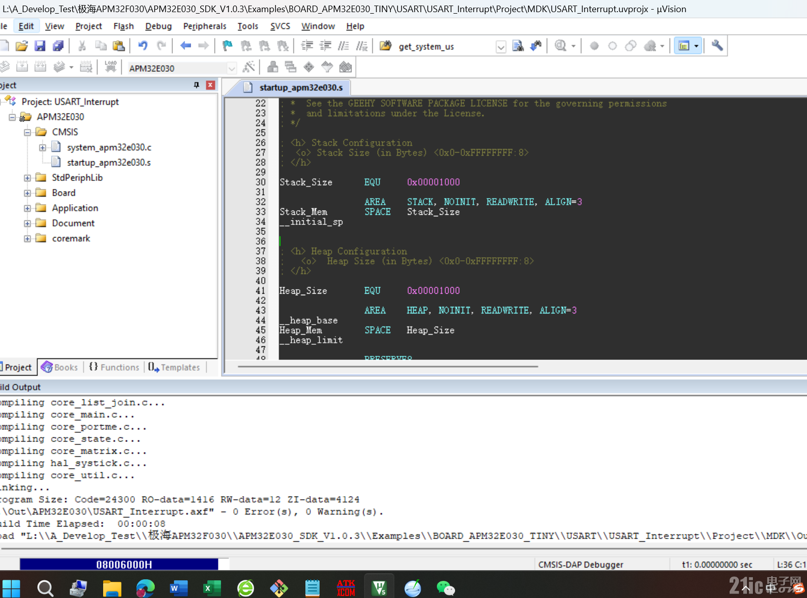

1.首先修改启动文件的堆栈空间,设大一些
2.修改portme文件
//#define NSECS_PER_SEC              CLOCKS_PER_SEC
//#define CORETIMETYPE               clock_t
//#define GETMYTIME(_t)              (*_t = clock())
#include "hal_systick.h"
#define NSECS_PER_SEC              TICKS_PER_SECOND
#define CORETIMETYPE               uint32_t
#define GETMYTIME(_t)              (*_t = hal_systick_get())
#define MYTIMEDIFF(fin, ini)       ((fin) - (ini))
#define TIMER_RES_DIVIDER          1
#define SAMPLE_TIME_IMPLEMENTATION 1

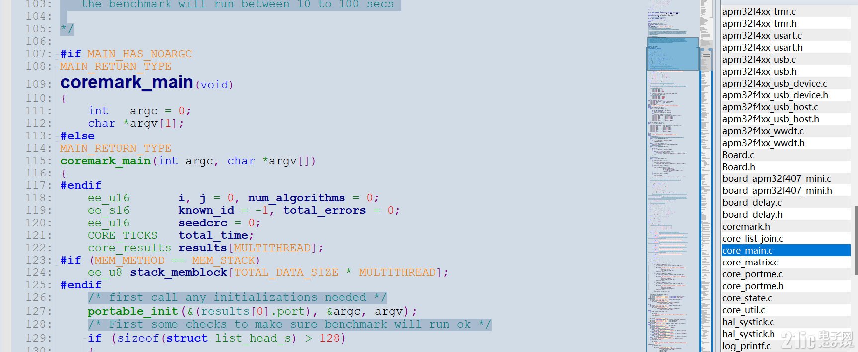

#define ITERATIONS 10000    // 这个值需要保证能够运行至少10秒,可以先写一个值,运行不足10秒会报错,再回来修改
#if MAIN_HAS_NOARGC
MAIN_RETURN_TYPE
coremark_main(void)
    int   argc = 0;
    char *argv[1];
#else
MAIN_RETURN_TYPE
coremark_main(int argc, char *argv[])

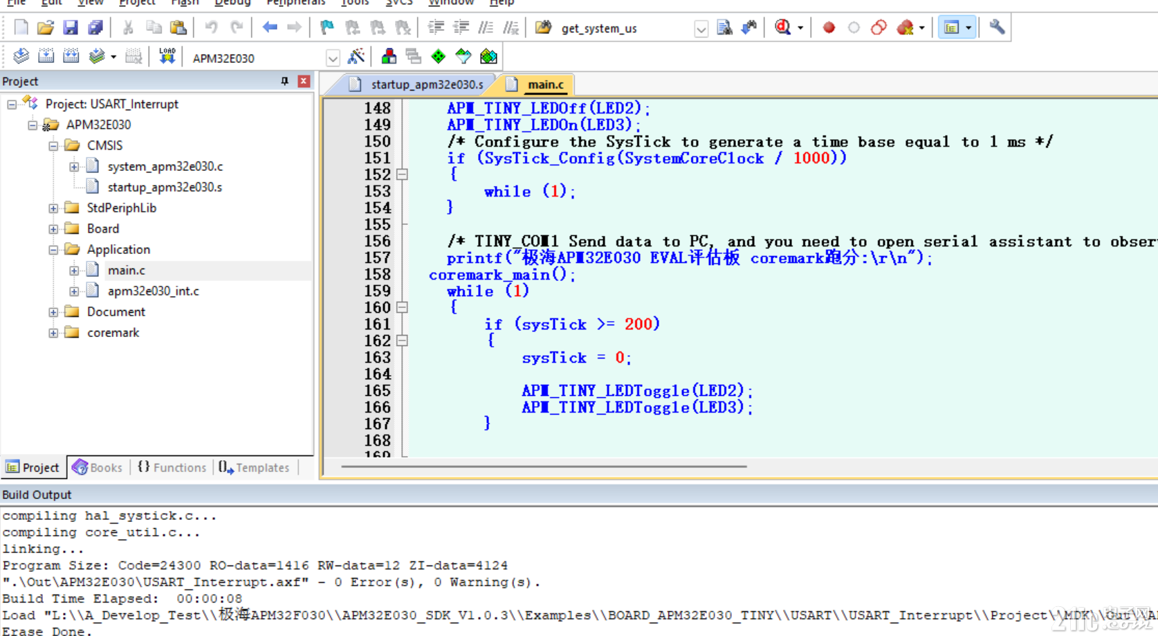

主函数添加核心功能函数
* @file        main.c
* @brief       Main program body
* @version     V1.0.4
* @date        2025-02-15
* @attention
*  Copyright (C) 2021-2025 Geehy Semiconductor
*  You may not use this file except in compliance with the
*  GEEHY COPYRIGHT NOTICE (GEEHY SOFTWARE PACKAGE LICENSE).
*  The program is only for reference, which is distributed in the hope
*  that it will be useful and instructional for customers to develop
*  their software. Unless required by applicable law or agreed to in
*  writing, the program is distributed on an "AS IS" BASIS, WITHOUT
*  ANY WARRANTY OR CONDITIONS OF ANY KIND, either express or implied.
*  See the GEEHY SOFTWARE PACKAGE LICENSE for the governing permissions
*  and limitations under the License.
/* Includes ***************************************************************/
#include "main.h"
#include "Board.h"
#include <stdio.h>
/* Private includes *******************************************************/
#include "coremark.h"
/* Private macro **********************************************************/
/* printf using USART1  */
#define DEBUG_USART  USART1
/* Private typedef ********************************************************/
/* Private variables ******************************************************/
static __IO u32 TimingDelay;
/* Private function prototypes ********************************************/
void SysTick_Init(void);
void SysTick_Delay_ms(__IO u32 nTime);
void TimingDelay_Decrement(void);
/* External variables *****************************************************/
void coremark_main(void);
/* External functions *****************************************************/
* @param       None
* @retval      None
int main(void)
    USART_Config_T usartConfigStruct;
    usartConfigStruct.baudRate = 115200;
    usartConfigStruct.hardwareFlow = USART_HARDWARE_FLOW_NONE;
    usartConfigStruct.mode = USART_MODE_TX;
    usartConfigStruct.parity = USART_PARITY_NONE;
    usartConfigStruct.stopBits = USART_STOP_BIT_1;
    usartConfigStruct.wordLength = USART_WORD_LEN_8B;
    BOARD_COMInit(COM1, &usartConfigStruct);
    BOARD_LEDInit(LED2);
    BOARD_LEDInit(LED3);
    printf("\r\nDelay Time = 1000ms\r\n");
    /* SysTick Initialization */
    SysTick_Init();
        printf("极海APM32F402 EVAL评估板 coremark跑分:\r\n");
        coremark_main();
    while (1)
        BOARD_LEDToggle(LED2);
        BOARD_LEDToggle(LED3);
        /* Precise Delay 1ms */
        SysTick_Delay_ms(1000);
* @brief       Start SysTick
* @param       None
* @retval      None
    SystemCoreClock = RCM_ReadSYSCLKFreq();
    /* SystemFrequency / 1000 = 1ms */
    if (SysTick_Config(SystemCoreClock / 1000))
        /* Capture error */
        while (1);
* @brief       Precise Delay
* @param       nTime in milliseconds
* @retval      None
    TimingDelay = nTime;
    while(TimingDelay != 0);
* @brief       Decrements the TimingDelay
* @param       None
* @retval      None
    if(TimingDelay != 0)
        TimingDelay--;
#if defined (__CC_ARM) || defined (__ICCARM__) || (defined(__ARMCC_VERSION) && (__ARMCC_VERSION >= 6010050))
* @brief       Redirect C Library function printf to serial port.
*              After Redirection, you can use printf function.
* @param       ch:  The characters that need to be send.
* @param       *f:  pointer to a FILE that can recording all information
*              needed to control a stream
* @retval      The characters that need to be send.
* @note
int fputc(int ch, FILE* f)
    /* send a byte of data to the serial port */
    USART_TxData(DEBUG_USART, (uint8_t)ch);
    /* wait for the data to be send */
    while (USART_ReadStatusFlag(DEBUG_USART, USART_FLAG_TXBE) == RESET);
    return (ch);
#elif defined (__GNUC__)
* @note
int __io_putchar(int ch)
    USART_TxData(DEBUG_USART, ch);
    return ch;
* @param       file:  Meaningless in this function.
* @param       *ptr:  Buffer pointer for data to be sent.
* @param       len:  Length of data to be sent.
* @note
int _write(int file, char* ptr, int len)
    UNUSED(file);
    int i;
    for (i = 0; i < len; i++)
        __io_putchar(*ptr++);
    return len;
#else
#warning Not supported compiler type
#endif
编译后烧录代码

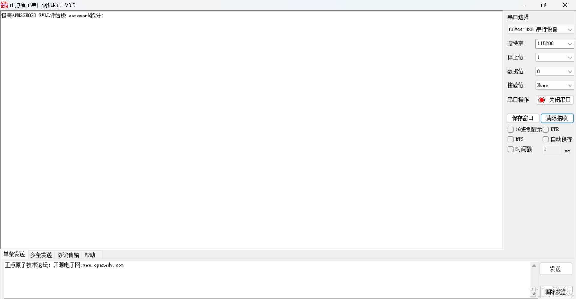

打开串口助手,115200波特率
等待10S左右时间会出现跑分结果
可以看到,APM32E030 EVAL评估板 coremark跑分:
153.699548 分,在开最大优化等级 -Omax条件下
这个分数在Cortex M0中很强了
