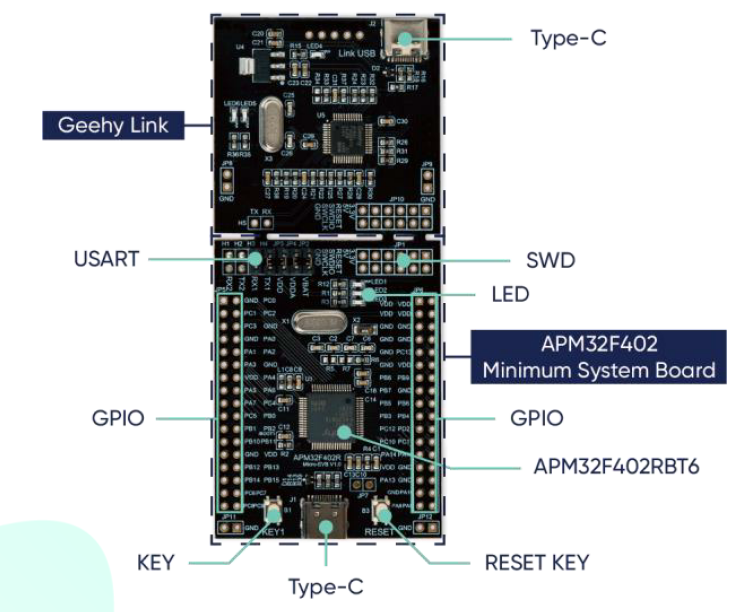

感谢极海与21ic联合提供的测评机会,本次收到的是APM32F402R-EVB。
主要的资源分布如下:
主控是32-bit Arm® Cortex® -M4F,Operating frequency 120MHz, Flash: 128KB , SRAM: 32KB 。

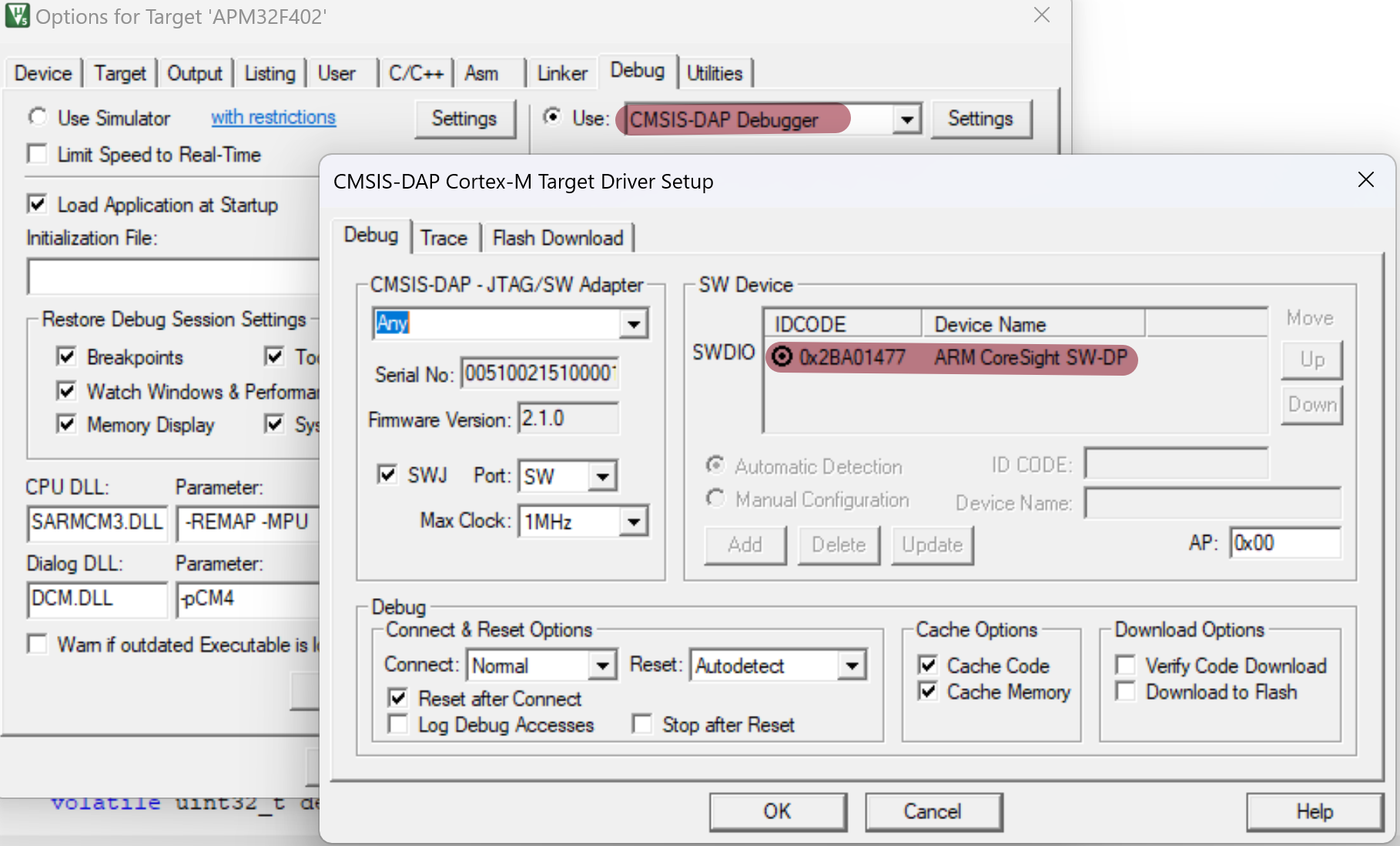

开发环境选择Keil,从极海官网下载Geehy.APM32F4xx_DFP.1.0.8.pack。从点亮LED开始:

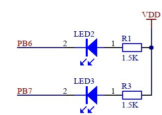

初始化GPIO引脚:
  1. void BOARD_LED_Config(BOARD_LED_T led)
  3.     GPIO_Config_T GPIO_ConfigStruct = {0U};
  4.     /* Enable the GPIO_LED Clock */
  5.     RCM_EnableAPB2PeriphClock(LED_CLK[led]);
  6.     /* Configure the GPIO_LED pin */
  7.     GPIO_ConfigStruct.pin = LED_PIN[led];
  8.     GPIO_ConfigStruct.mode = GPIO_MODE_OUT_PP;
  9.     GPIO_ConfigStruct.speed = GPIO_SPEED_50MHz;
  10.     GPIO_Config(LED_PORT[led], &GPIO_ConfigStruct);
  11.     LED_PORT[led]->BC = LED_PIN[led];
  12. }

烧录选项:
  1. Load "D:\\MicroModules\\21ic\\Geehy_APMF402\\-1-FirmWare\\APM32F402_403_SDK_V1.0.2\\Examples\\Board_APM32F402_Tiny\\GPIO\\GPIO_Toggle\\Project\\MDK\\Objects\\APM32F402\\GPIO_Toggle.axf"
  2. Erase Done.
  3. Programming Done.
  4. Verify OK.
  5. Application running ...
  6. Flash Load finished at 17:50:48

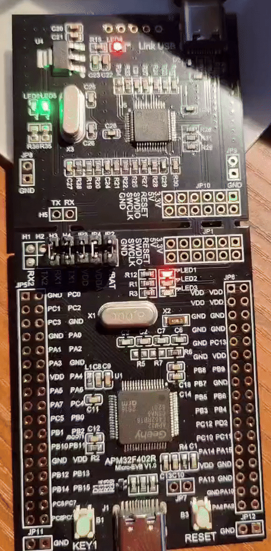

烧录验证:
