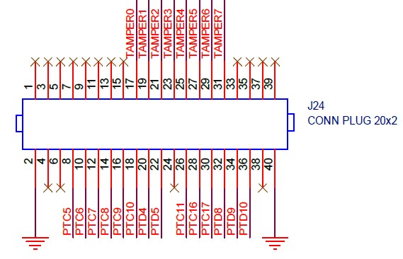

LPTMR Pulse Counting Example on LPTMR_ALT1
Testing ALT1 pin on PORTA19
        PA19位于GPIO引出口,请给PA19脉冲
This test requires a function generator, or another way of producing a pulse signal on the pin specified above. Please connect that device to the specified pin
If you would like to continue with this example, press "y". To skip press any other key
Press any key to start pulse counter
Current value of pulse count register CNR is xxx.
Detected 1000 pulses on LPTMR_ALT1
End of Pulse Counting Example
LPTMR Pulse Counting Example on LPTMR_ALT2
Testing ALT2 pin on PORTC5
        PC5位于核心板20*2口第8脚引出口,请给PC5脉冲
Detected 1000 pulses on LPTMR_ALT2
