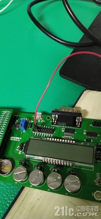

今晚捣鼓了一下触摸按键
代码:
#include "CH57x_common.h"
#include "CH57x_gpio.h"
UINT16 abcBuff[40];
volatile UINT8  adclen;
uint32_t ADCR;
void DebugInit(void)
    GPIOA_SetBits(GPIO_Pin_9);
    GPIOA_ModeCfg(GPIO_Pin_8, GPIO_ModeIN_PU);
    GPIOA_ModeCfg(GPIO_Pin_9, GPIO_ModeOut_PP_5mA);
    UART1_DefInit();
void led_init(void)
                GPIOB_SetBits( GPIO_Pin_0 );
    GPIOB_ModeCfg( GPIO_Pin_0, GPIO_ModeOut_PP_5mA );
int main()
    UINT8 i;
/* ÅäÖô®¿Úµ÷ÊÔ */
    DebugInit();
    PRINT( "Start @ChipID=%02X\n", R8_CHIP_ID );
/* TouchKey²ÉÑù£ºÑ¡ÔñadcͨµÀ 2 ×ö²ÉÑù£¬¶ÔÓ¦ PA12 */
    PRINT( "\n4.TouchKey sampling...\n");
    GPIOA_ModeCfg(GPIO_Pin_12, GPIO_ModeIN_Floating);
    TouchKey_ChSampInit();
    ADC_ChannelCfg( 2 );
    led_init();
                R8_ADC_CONVERT|=(1<<0);//Æô¶¯×ª»»
    while(1)
                        ADCR=0;
                        for(i=0; i<16; i++)
                                        abcBuff = TouchKey_ExcutSingleConver(0x20);      // Á¬Ðø²ÉÑù20´Î
                                        ADCR+=abcBuff;
                        ADCR>>=4;
                        PRINT("%d\r\n ", ADCR);
                        if(ADCR<2000)
                                GPIOB_ResetBits( GPIO_Pin_0 );
                        else
void ADC_IRQHandler(void)                        //adcÖжϷþÎñ³ÌÐò
    if(ADC_GetITStatus())
        abcBuff[adclen] = ADC_ReadConverValue();
        ADC_StartUp(); // ×÷ÓÃÇå³ýÖжϱêÖ¾²¢¿ªÆôÐÂÒ»ÂÖ²ÉÑù
        adclen ++;
效果图:

电容按键吗?
hudi008 发表于 2021-5-3 15:09 | 显示全部楼层
电容式感应触摸按键可以穿透绝缘材料外壳 8mm
