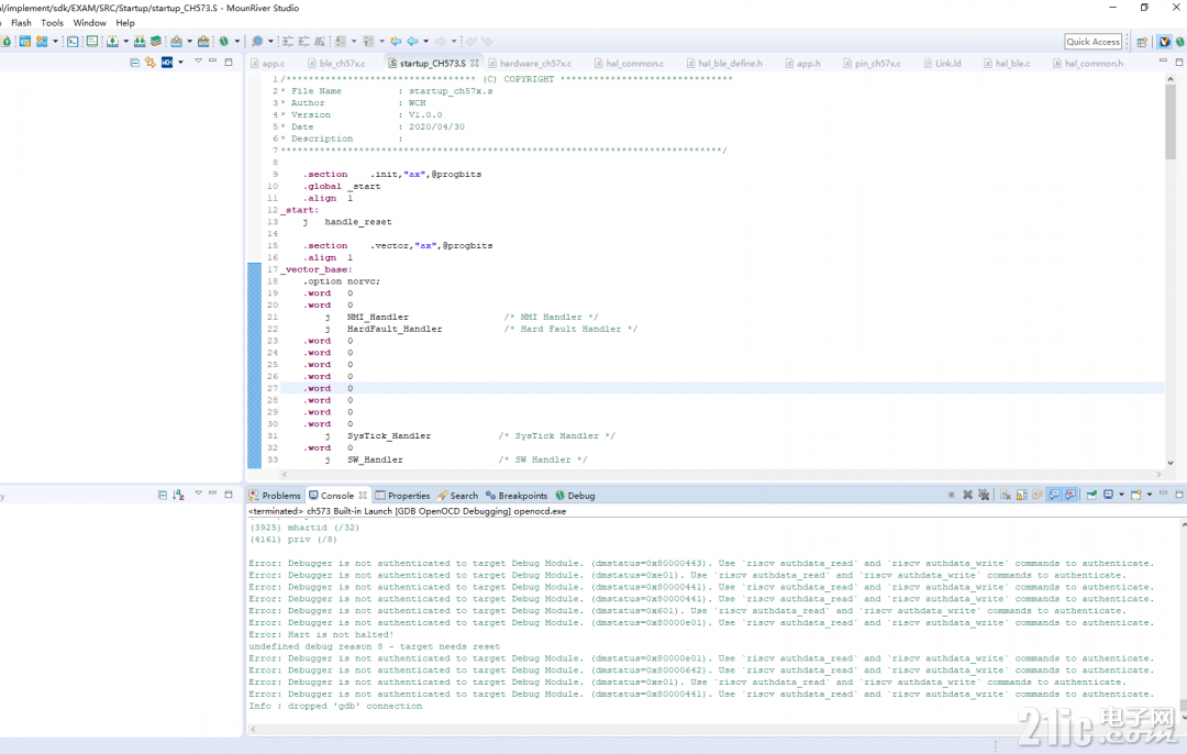

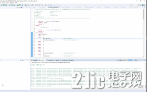

昨天仿真ch573都可以正常,今天仿真出现了以下的错误。

  251. (3923) marchid (/32)
  252. (3924) mimpid (/32)
  253. (3925) mhartid (/32)
  254. (4161) priv (/8)
  255. Error: Debugger is not authenticated to target Debug Module. (dmstatus=0x80000443). Use `riscv authdata_read` and `riscv authdata_write` commands to authenticate.
  256. Error: Debugger is not authenticated to target Debug Module. (dmstatus=0xe01). Use `riscv authdata_read` and `riscv authdata_write` commands to authenticate.
  257. Error: Debugger is not authenticated to target Debug Module. (dmstatus=0x80000441). Use `riscv authdata_read` and `riscv authdata_write` commands to authenticate.
  258. Error: Debugger is not authenticated to target Debug Module. (dmstatus=0x80000441). Use `riscv authdata_read` and `riscv authdata_write` commands to authenticate.
  259. Error: Debugger is not authenticated to target Debug Module. (dmstatus=0x601). Use `riscv authdata_read` and `riscv authdata_write` commands to authenticate.
  260. Error: Debugger is not authenticated to target Debug Module. (dmstatus=0x80000e01). Use `riscv authdata_read` and `riscv authdata_write` commands to authenticate.
  261. Error: Hart is not halted!
  262. undefined debug reason 8 - target needs reset
  263. Error: Debugger is not authenticated to target Debug Module. (dmstatus=0x80000e01). Use `riscv authdata_read` and `riscv authdata_write` commands to authenticate.
  264. Error: Debugger is not authenticated to target Debug Module. (dmstatus=0x80000642). Use `riscv authdata_read` and `riscv authdata_write` commands to authenticate.
  265. Error: Debugger is not authenticated to target Debug Module. (dmstatus=0xe01). Use `riscv authdata_read` and `riscv authdata_write` commands to authenticate.
  266. Error: Debugger is not authenticated to target Debug Module. (dmstatus=0x80000441). Use `riscv authdata_read` and `riscv authdata_write` commands to authenticate.
  267. Info : dropped 'gdb' connection
请问一下原厂FAE,这个是我的板子有问题还是其他原因?
请帮忙看一下,可以通过什么方式解决
谢谢

WCHTech2 发表于 2021-6-7 16:40 | 显示全部楼层
您好,可以尝试新建CH573的模板工程,试下是否可以仿真。
工程中如果操作Flash上锁,睡眠等功能时是不可进行仿真。
蓝牙的工程一般不建议使用单步调试仿真的方式,可以采用printf打印运行状态信息,因为蓝牙对实时性要求较高。
如有问题也可电话咨询:025-52638373
