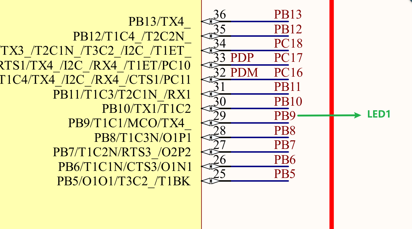

2、硬件配置
PB9----LED1

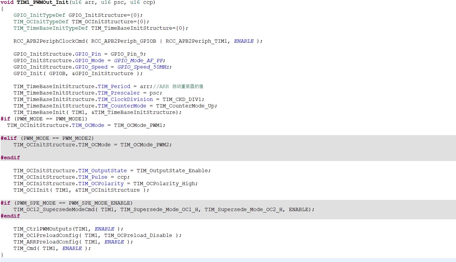

3、代码实现
PWM 频率和脉宽关系
a.ARR(TIM_Period) 是计数值;
b.PSC(TIM_Prescaler) 是预分频值。
计算公式:Fpwm = 主频 / ((ARR+1)*(PSC+1))(单位:Hz)
* @fn      TIM1_OutCompare_Init
* @brief   Initializes TIM1 output compare.
* @param   arr - the period value.
*          psc - the prescaler value.
*          ccp - the pulse value.
* @return  none
void TIM1_PWMOut_Init(u16 arr, u16 psc, u16 ccp)
        GPIO_InitTypeDef GPIO_InitStructure={0};
        TIM_OCInitTypeDef TIM_OCInitStructure={0};
        TIM_TimeBaseInitTypeDef TIM_TimeBaseInitStructure={0};
        RCC_APB2PeriphClockCmd( RCC_APB2Periph_GPIOB | RCC_APB2Periph_TIM1, ENABLE );
        GPIO_InitStructure.GPIO_Pin = GPIO_Pin_9;
        GPIO_InitStructure.GPIO_Mode = GPIO_Mode_AF_PP;
        GPIO_Init( GPIOB, &GPIO_InitStructure );
        TIM_TimeBaseInitStructure.TIM_Period = arr;//ARR 自动重装器的值
        TIM_TimeBaseInitStructure.TIM_Prescaler = psc;
        TIM_TimeBaseInitStructure.TIM_ClockDivision = TIM_CKD_DIV1;
        TIM_TimeBaseInitStructure.TIM_CounterMode = TIM_CounterMode_Up;
        TIM_TimeBaseInit( TIM1, &TIM_TimeBaseInitStructure);
#if (PWM_MODE == PWM_MODE1)
  TIM_OCInitStructure.TIM_OCMode = TIM_OCMode_PWM1;
#elif (PWM_MODE == PWM_MODE2)
        TIM_OCInitStructure.TIM_OCMode = TIM_OCMode_PWM2;
#endif
        TIM_OCInitStructure.TIM_OutputState = TIM_OutputState_Enable;
        TIM_OCInitStructure.TIM_Pulse = ccp;
        TIM_OCInitStructure.TIM_OCPolarity = TIM_OCPolarity_High;
        TIM_OC1Init( TIM1, &TIM_OCInitStructure );
#if (PWM_SPE_MODE == PWM_SPE_MODE_ENABLE)
        TIM_OC12_SupersedeModeCmd( TIM1, TIM_Supersede_Mode_OC1_H, TIM_Supersede_Mode_OC2_H, ENABLE);
#endif
        TIM_CtrlPWMOutputs(TIM1, ENABLE );
        TIM_OC1PreloadConfig( TIM1, TIM_OCPreload_Disable );
        TIM_ARRPreloadConfig( TIM1, ENABLE );
        TIM_Cmd( TIM1, ENABLE );

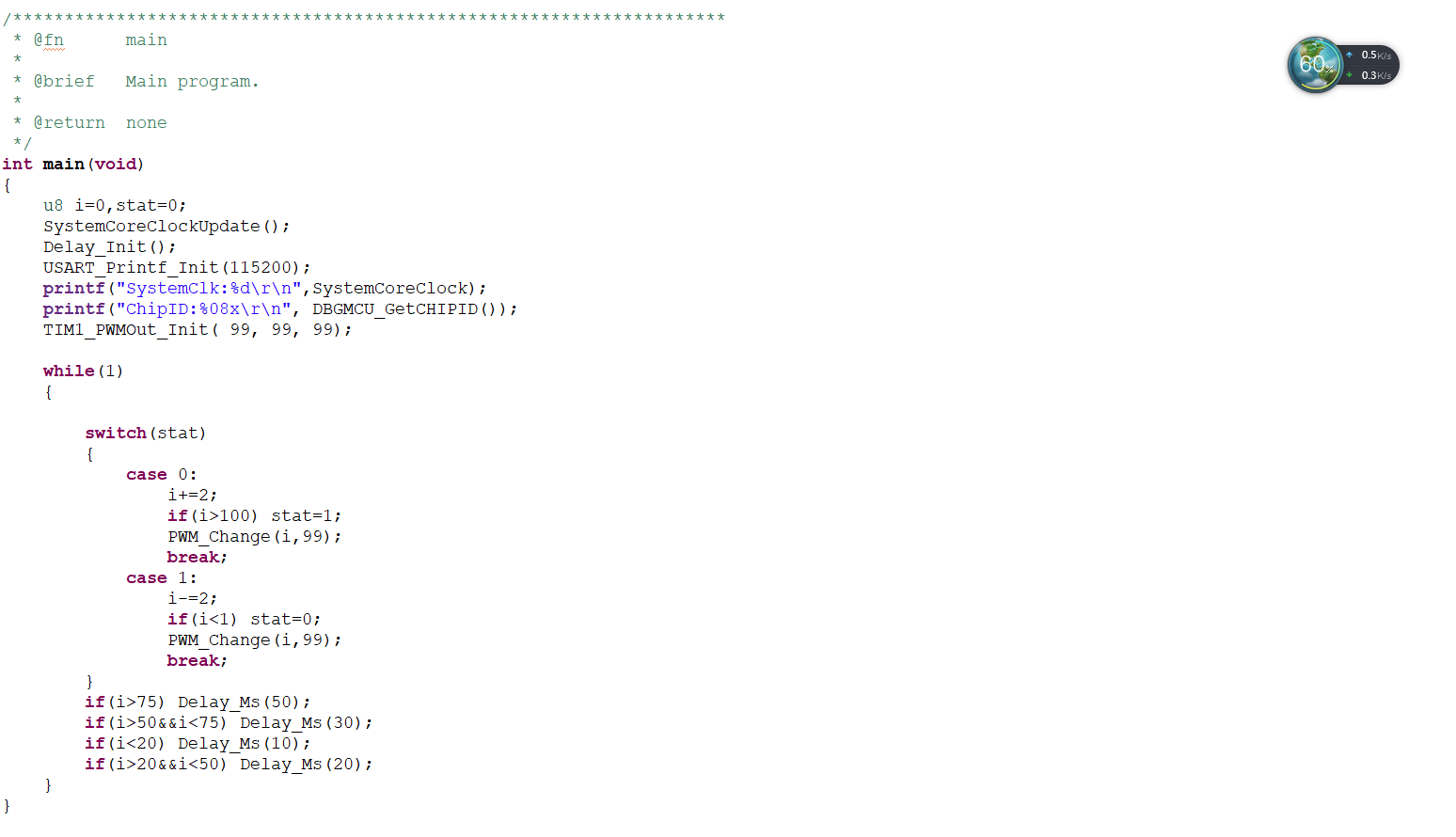

main函数
int main(void)
    u8 i=0,stat=0;
        SystemCoreClockUpdate();
        Delay_Init();
        USART_Printf_Init(115200);
        printf("SystemClk:%d\r\n",SystemCoreClock);
        printf("ChipID:%08x\r\n", DBGMCU_GetCHIPID());
        TIM1_PWMOut_Init( 99, 99, 99);
        while(1)
            switch(stat)
                             case 0:
                             i+=2;
                            if(i>100) stat=1;
                            PWM_Change(i,99);
                            break;
                                case 1:
                            i-=2;
                            if(i<1) stat=0;
                            PWM_Change(i,99);
                            break;
        if(i>75) Delay_Ms(50);
        if(i>50&&i<75) Delay_Ms(30);
        if(i<20) Delay_Ms(10);
        if(i>20&&i<50) Delay_Ms(20);

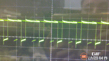

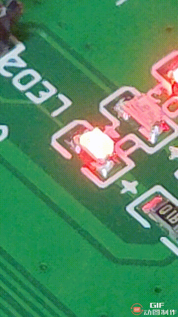

4、实验现象
源码附件
