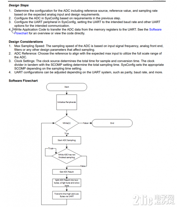

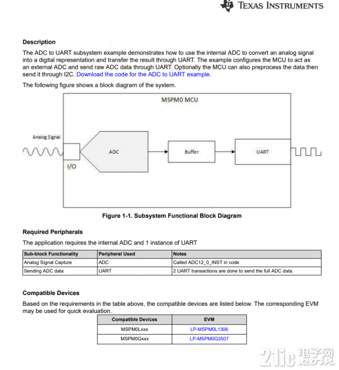

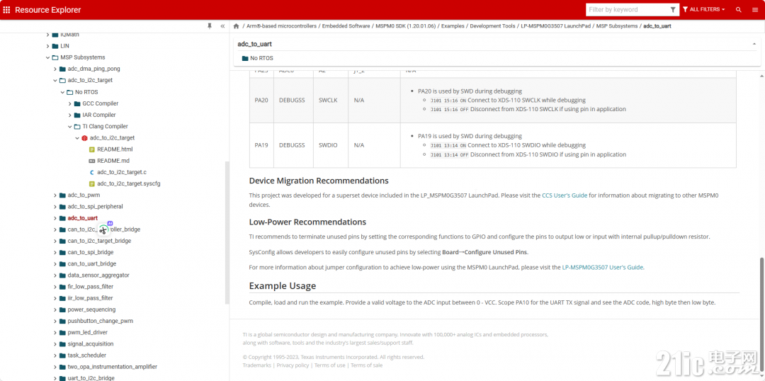

MSPM0G3507应用之ADC数据通过UART接口进行传输
 楼主| xyz549040622 发表于 2023-12-24 23:12 | 显示全部楼层 |阅读模式

  32. #include "ti_msp_dl_config.h"
  33. volatile bool gCheckADC;
  34. volatile uint16_t gADCResult;
  35. int main(void)
  36. {
  37.     SYSCFG_DL_init();
  38.     NVIC_EnableIRQ(ADC12_0_INST_INT_IRQN);
  39.     gCheckADC = false;
  40.     while (1) {
  41.         DL_ADC12_startConversion(ADC12_0_INST);
  42.         while (false == gCheckADC) {
  43.             __WFE();
  44.         }
  45.        /*
  46.         *  UART is 8 bits and the ADC result is 16 bits
  47.         *  Split the ADC result into 2 then send via UART.
  48.         */
  49.         gADCResult = DL_ADC12_getMemResult(ADC12_0_INST, DL_ADC12_MEM_IDX_0);
  50.         uint8_t lowbyte  = (uint8_t)(gADCResult & 0xFF);
  51.         uint8_t highbyte = (uint8_t)((gADCResult >> 8) & 0xFF);
  52.         DL_UART_Main_transmitData(UART_0_INST, highbyte);
  53.         DL_UART_Main_transmitData(UART_0_INST, lowbyte);
  54.         gCheckADC = false;
  55.         DL_ADC12_enableConversions(ADC12_0_INST);
  56.     }
  57. }
  58. void ADC12_0_INST_IRQHandler(void)
  59. {
  60.     switch (DL_ADC12_getPendingInterrupt(ADC12_0_INST)) {
  61.         case DL_ADC12_IIDX_MEM0_RESULT_LOADED:
  62.             gCheckADC = true;
  63.             break;
  64.         default:
  65.             break;
  66.     }
  67. }
