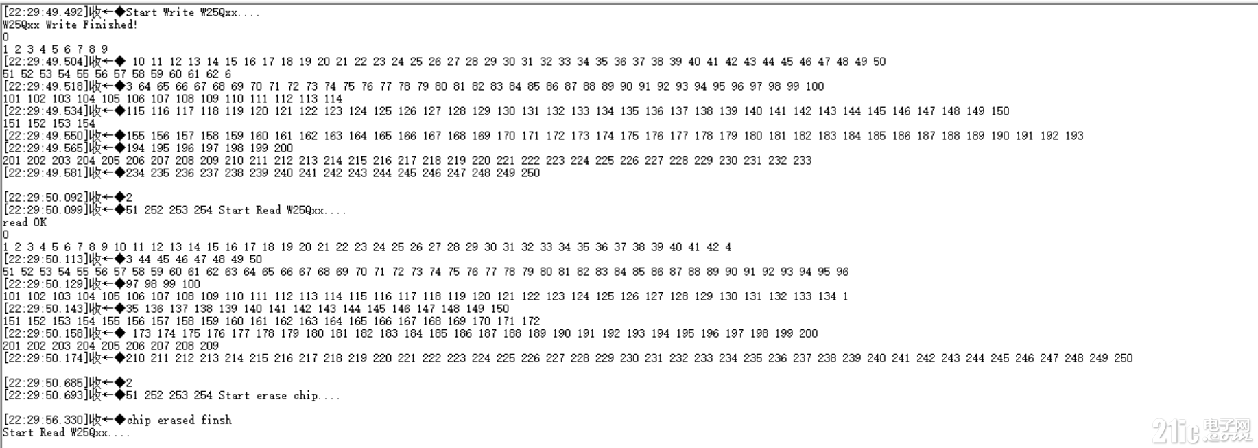

二、SPI读写W25Q16测试
1、简单介绍一下W25Q16芯片
W25Q16是一个16M BIT的FLASH芯片,它有8192个可编程页,一个能够写入256个字节;页擦除一次性可以擦除4K/32K/64KB或者整个芯片;分别有512个可擦除扇区,32个可擦除扇区。
它的组成是总共有32个块,每个块有64KB,一个块又分为16个扇区。使用它可以做大容量数据存储。

5、读写FLASH函数

    7、主函数
  1. /*********************************************************************
  2. * @fn      main
  3. *
  4. * @brief   Main program.
  5. *
  6. * @return  none
  7. */
  8. int main(void)
  9. {
  10.         u8  readData[SIZE];
  11.     u16 Flash_Model;
  12.     u8 writeData[SIZE] = {0};
  13.         NVIC_PriorityGroupConfig(NVIC_PriorityGroup_2);
  14.         SystemCoreClockUpdate();
  15.         Delay_Init();
  16.         USART_Printf_Init(115200);
  17.         printf("SystemClk:%d\r\n",SystemCoreClock);
  18.         printf( "ChipID:%08x\r\n", DBGMCU_GetCHIPID() );
  19.         printf("This is printf example\r\n");
  20.            SPI_Flash_Init();
  21.     Flash_Model = SPI_Flash_ReadID();
  22.     for(uint16_t i = 0;i < SIZE;i++) {
  23.         writeData[i] = i;
  24.     }
  25.     switch(Flash_Model)
  26.     {
  27.         case W25Q80:
  28.             printf("W25Q80 OK!\r\n");
  29.             break;
  30.         case W25Q16:
  31.             printf("W25Q16 OK!\r\n");
  32.             break;
  33.         case W25Q32:
  34.             printf("W25Q32 OK!\r\n");
  35.             break;
  36.         case W25Q64:
  37.             printf("W25Q64 OK!\r\n");
  38.             break;
  39.         case W25Q128:
  40.             printf("W25Q128 OK!\r\n");
  41.             break;
  42.         default:
  43.             printf("Fail!\r\n");
  44.             break;
  45.     }
  46.     printf("Start Erase W25Qxx....\r\n");
  47.     SPI_Flash_Erase_Sector(0);
  48.     printf("W25Qxx Erase Finished!\r\n");
  49.     Delay_Ms(500);
  50.     printf("Start Read W25Qxx....\r\n");
  51.     SPI_Flash_Read(readData, 0x0, SIZE);
  52.     printf("read OK\r\n");
  53.     Delay_Ms(500);
  54.     printf("Start Write W25Qxx....\r\n");
  55.     printf("W25Qxx Write Finished!\r\n");
  56.     for(uint8_t i = 0;i < SIZE;i++) {
  57.         printf("%d ",writeData[i]);
  58.         if (i % 50 == 0) {
  59.             printf("\r\n");
  60.         }
  61.     }
  62.     SPI_Flash_Write((u8 *)writeData, 0, SIZE);
  63.
  64.     Delay_Ms(500);
  65.     printf("Start Read W25Qxx....\r\n");
  66.     SPI_Flash_Read(readData, 0x0, SIZE);
  67.     printf("read OK\r\n");
  68.     for(uint8_t i = 0;i < SIZE;i++) {
  69.         printf("%d ",readData[i]);
  70.         if (i % 50 == 0) {
  71.             printf("\r\n");
  72.         }
  73.     }
  74.
  75.     Delay_Ms(500);
  76.     printf("Start erase chip....\r\n");
  77.     SPI_Flash_Erase_Chip();
  78.     printf("chip erased finsh\r\n");
  79.     printf("Start Read W25Qxx....\r\n");
  80.     SPI_Flash_Read(readData, 0x0, SIZE);
  81.     printf("%s\r\n", readData);
  82.         while(1)
  83.     {
  84.         }
  85. }
     8、下载验证
主要做了以下测试,擦除扇区、读写数据、擦除整个芯片,擦除整个芯片耗时6ms,这速度擦除还是可以的
