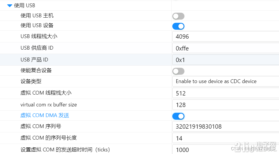

1 RT-Thread配置
board.h在USB相关定义中增加
#define BSP_USING_USBDEVICE
需要注意的是,如果不打开虚拟COM DMA发送开关,则只能发送一次,具体问题还不清楚,厂家提供的BSP中未做相关说明。
如果有编译错误,把相关文件中的RT_WEAK替换为rt_weak即可

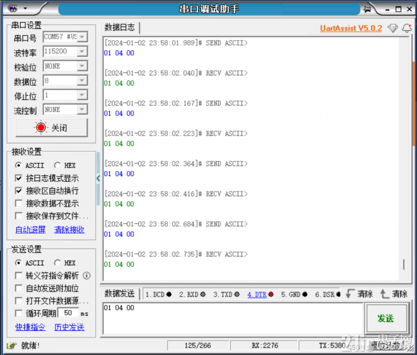

2 测试程序
输入list device
list device
device           type         ref count
vcom     Character Device     1
usbd     USB Slave Device     0
uart4    Character Device     0
uart3    Character Device     0
uart1    Character Device     2
pin      Pin Device           0
int main(void)
    int count;
    char buf2[128];
    rt_device_t dev = RT_NULL;
    dev = rt_device_find("vcom");
    if (dev)
        rt_device_open(dev, RT_DEVICE_FLAG_RDWR);
    else
        return -RT_ERROR;
    while (1)
        count = rt_device_read(dev, 0, buf2, 128);
        if(count>0){
            buf2[count] = 0;
            rt_kprintf("%s\n",buf2);
            rt_device_write(dev, 0, buf2, count);
        rt_thread_mdelay(1);
    return RT_EOK;
