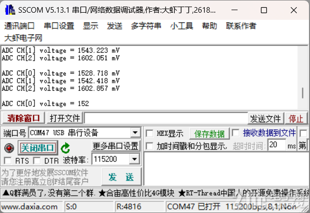

APM32F402R Micro-EVB开发板配有一个12bit ADC数模转换器,可进行多个数据通道的采集。
以3个数据采集通道为例,其信号输入的引脚分别对应PA0~PA2。
它对 ADC的初始化函数为:
  1. void ADC_Init(void)
  3.     GPIO_Config_T GPIO_ConfigStruct;
  4.     ADC_Config_T ADC_ConfigStruct;
  5.     RCM_EnableAPB2PeriphClock(RCM_APB2_PERIPH_GPIOA);
  6.     GPIO_ConfigStructInit(&GPIO_ConfigStruct);
  7.     GPIO_ConfigStruct.mode    = GPIO_MODE_ANALOG;
  8.     GPIO_ConfigStruct.pin     = GPIO_PIN_0 | GPIO_PIN_1 | GPIO_PIN_2;
  9.     GPIO_Config(GPIOA, &GPIO_ConfigStruct);
  10.     RCM_EnableAPB2PeriphClock(RCM_APB2_PERIPH_ADC1);
  11.     ADC_Reset(ADC1);
  12.     ADC_ConfigStructInit(&ADC_ConfigStruct);
  13.     ADC_ConfigStruct.mode                  = ADC_MODE_INDEPENDENT;
  14.     ADC_ConfigStruct.scanConvMode          = ENABLE;
  15.     ADC_ConfigStruct.continuousConvMode    = ENABLE;
  16.     ADC_ConfigStruct.externalTrigConv      = ADC_EXT_TRIG_CONV_NONE;
  17.     ADC_ConfigStruct.dataAlign             = ADC_DATA_ALIGN_RIGHT;
  18.     ADC_ConfigStruct.nbrOfChannel          = ADC_CH_SIZE;
  19.     ADC_Config(ADC1, &ADC_ConfigStruct);
  20.     RCM_ConfigADCCLK(RCM_PCLK2_DIV_6);
  21.     ADC_ConfigRegularChannel(ADC1, ADC_CHANNEL_0, 1, ADC_SAMPLETIME_13CYCLES5);
  22.     ADC_ConfigRegularChannel(ADC1, ADC_CHANNEL_1, 2, ADC_SAMPLETIME_13CYCLES5);
  23.     ADC_ConfigRegularChannel(ADC1, ADC_CHANNEL_2, 3, ADC_SAMPLETIME_13CYCLES5);
  24.     DMA_Init();
  25.     ADC_EnableDMA(ADC1);
  26.     ADC_Enable(ADC1);
  27.     ADC_ResetCalibration(ADC1);
  28.     while (ADC_ReadResetCalibrationStatus(ADC1));
  29.     ADC_StartCalibration(ADC1);
  30.     while (ADC_ReadCalibrationStartFlag(ADC1));
  31.     ADC_EnableSoftwareStartConv(ADC1);
  32. }
通过串口对采集数据进行输出的函数为:
  1. void ADC_MultiChannelPolling(void)
  3. float voltage;
  4. uint8_t index;
  5. for (index = 0; index < ADC_CH_SIZE; index++)
  6. {
  7. voltage = (adcData[index] * 3300.0) / 4095.0;
  8. printf("ADC CH[%d] voltage = %.03f mV\r\n", index, voltage);
  9. }
  10. printf("\r\n");
  11. }
检测多通道数据采集的主程序为:
  1. int main(void)
  3. USART_Config_T USART_ConfigStruct;
  4. USART_ConfigStructInit(&USART_ConfigStruct);
  5. USART_ConfigStruct.baudRate = 115200;
  6. USART_ConfigStruct.hardwareFlow = USART_HARDWARE_FLOW_NONE;
  7. USART_ConfigStruct.mode = USART_MODE_TX;
  8. USART_ConfigStruct.parity = USART_PARITY_NONE;
  9. USART_ConfigStruct.stopBits = USART_STOP_BIT_1;
  10. USART_ConfigStruct.wordLength = USART_WORD_LEN_8B;
  11. BOARD_COM_Config(COM1, &USART_ConfigStruct);
  12. ADC_Init();
  13. while (1)
  14. {
  15. ADC_MultiChannelPolling();
  16. Delay(1000);
  17. }
  18. }
经程序的编译和下载,其检测结果如图1所示。

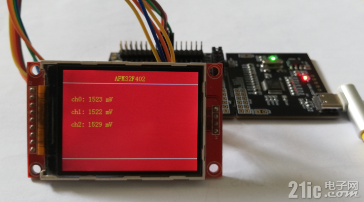

在配接TFT显示屏的情况下,其采集数据的显示函数为:
  3. float voltage;
  4. uint8_t index;
  6. {
  8. if(index ==0) LCD_ShowNum(60,60,voltage,4);
  9. if(index ==1) LCD_ShowNum(60,90,voltage,4);
  10. if(index ==2) LCD_ShowNum(60,120,voltage,4);
  11. }
  12. }
测试采集数据显示效果的主程序为:
  1. int main(void)
  3. BOARD_TFT_Config();
  4. tft_Init();
  5. LCD_Clear(RED);
  6. BACK_COLOR=RED;
  7. POINT_COLOR=YELLOW;
  8. LCD_ShowString(120,10,"APM32F402");
  9. POINT_COLOR=WHITE;
  10. LCD_DrawLine(0, 30, 319, 30);
  11. LCD_DrawLine(0, 210, 319, 210);
  12. POINT_COLOR=YELLOW;
  13. LCD_ShowString(20,60,"ch0: mV ");
  14. LCD_ShowString(20,90,"ch1: mV ");
  15. LCD_ShowString(20,120,"ch2: mV ");
  16. ADC_Init();
  17. while (1)
  18. {
  19. ADC_MultiChannelPolling();
  20. Delay(1000);
  21. }
  22. }
经程序的编译和下载,其检测结果如图2所示。
2126856c7ff32ec0a3d50691be1463ab
图2 显示效果
