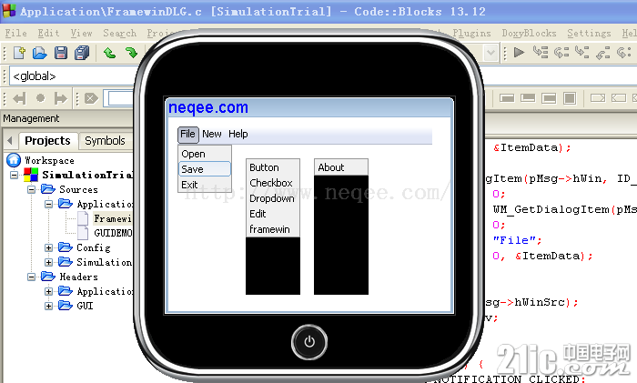

(2)保存为C文件FramewinDLG.c,然后添加到脱机模拟仿真平台CodeBlocks的emwin工程,并且编译运行,修改C文件前的显示效果如下:
(3)修改MENU①②③为竖向:
static const GUI_WIDGET_CREATE_INFO _aDialogCreate[] = {
{ FRAMEWIN_CreateIndirect, "Framewin", ID_FRAMEWIN_0, 0, 0, 320, 240, 0, 0x64, 0 },
{ MENU_CreateIndirect, "Menu", ID_MENU_0, 10, 10, 280, 20, 0, 0x0, 0 },
{ MENU_CreateIndirect, "Menu", ID_MENU_1, 10, 45, 60, 150, MENU_CF_VERTICAL, 0x0, 0 },
{ MENU_CreateIndirect, "Menu", ID_MENU_2, 85, 45, 60, 150, MENU_CF_VERTICAL, 0x0, 0 },
{ MENU_CreateIndirect, "Menu", ID_MENU_3, 160, 45, 60, 150, MENU_CF_VERTICAL, 0x0, 0 },

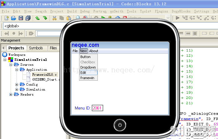

(7)用FRAMEWIN_AddMenu()函数将MENU附贴到Framewin顶部:
FRAMEWIN_AddMenu(pMsg->hWin, WM_GetDialogItem(pMsg->hWin, ID_MENU_0));

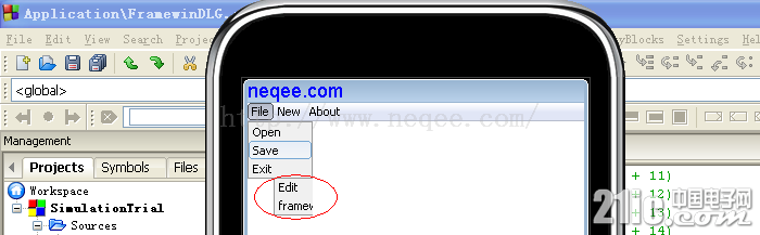

(8)修改MENU①②③的高度,否则将出现以下显示现象:
(9)在WM_NOTIFY_PARENT消息中(操作屏幕时程序跑到这里)加入代码:
case WM_MENU: //MENU控件触发消息(操作MENU后到这里)
     p_data = (MENU_MSG_DATA*)pMsg->Data.p;
     switch (p_data->MsgType) {
     case MENU_ON_ITEMPRESSED:
         break;
     case MENU_ON_ITEMACTIVATE:
         break;
     case MENU_ON_ITEMSELECT:
         MENU_GetItem(pMsg->hWinSrc, p_data->ItemId, &data);
         if (data.Flags & MENU_IF_DISABLED) break;
         EDIT_SetValue(WM_GetDialogItem(pMsg->hWin, ID_EDIT_0), data.Id);
         break;
     WM_DefaultProc(pMsg);
     break;
