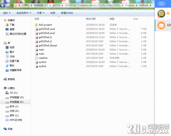

1,从GD官网下载GD32F3x0_Firmware_Library_V1.0.0并解压
2,(目前解压到E盘)E:\gd350\GD32F3x0_Firmware_Library_V1.0.0_Colibri-F350_\Projects
中建一个目录ledflash
拷贝Template目录以下文件到这个目录如下
配置好文件路径,工程中有的文件要删除后加入(都是路径问题)
3,记得调试用CMSID-DAP这个调试器选项 试下编译通过就OK。

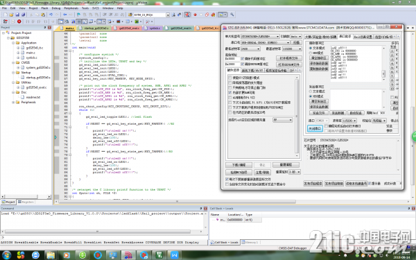

8,修改主程序中为:
int main(void)
    /* configure systick */
    systick_config();
    /* initilize the LEDs, USART and key */
    gd_eval_led_init(LED1);
    gd_eval_led_init(LED2);
    gd_eval_led_init(LED3);
    gd_eval_com_init(EVAL_COM1);
    gd_eval_key_init(KEY_WAKEUP, KEY_MODE_GPIO);
    /* print out the clock frequency of system, AHB, APB1 and APB2 */
    printf("\r\nCK_SYS is %d", rcu_clock_freq_get(CK_SYS));
    printf("\r\nCK_AHB is %d", rcu_clock_freq_get(CK_AHB));
    printf("\r\nCK_APB1 is %d", rcu_clock_freq_get(CK_APB1));
    printf("\r\nCK_APB2 is %d", rcu_clock_freq_get(CK_APB2));
    rcu_ckout_config(RCU_CKOUTSRC_CKSYS, RCU_CKOUT_DIV1);
    while (1)
        gd_eval_led_toggle(LED1); //led1 flash
                          if(RESET == gd_eval_key_state_get(KEY_WAKEUP)) //B2
            printf("\r\nled2 on!!!");
            gd_eval_led_on(LED2);
            delay_1ms(100);
            gd_eval_led_off(LED2);
            printf("\r\nled2 off!!!");
        if(RESET == gd_eval_key_state_get(KEY_TAMPER))//B3
           printf("\r\nled3 on!!!");
            delay_1ms(100);
            gd_eval_led_off(LED3);
            printf("\r\nled3 off!!!");
 楼主| wowu 发表于 2018-9-30 12:30 | 显示全部楼层
7,打开调试助手,设置对应串口和设置115200,N,8,1
8,编译运行
9,按下中间B2按键,按下B3按键
