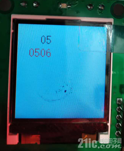

 楼主| xxh0201 发表于 2019-4-22 16:08 | 显示全部楼层
下面是用两种方法,读flash的内容:
volatile unsigned char code data_flash[128] _at_ 0x4700;
unsigned int Read_APROM_BYTE(unsigned int code *u16_addr)
    unsigned int rdata;
    rdata = *u16_addr;           //>>8,不移位
    return rdata;
下面是主函数写,并读,再显示出来
    while(1)
        for(i=0;i<128;i++)
            showshuzi_8X16( 32, 12, (data_flash>>4)&0x0F,BLACK,WHITE);
            showshuzi_8X16( 40, 12,  data_flash&0x0F,BLACK,WHITE);          //这两行是直接显示数组的数据
            rus_read_eeprom = Read_APROM_BYTE((unsigned int code *)(0x4700+i));//读地址方法
            showshuzi_8X16( 16, 30, (rus_read_eeprom>>12)&0x0F,RED,WHITE);
            showshuzi_8X16( 24, 30, (rus_read_eeprom>>8)&0x0F,RED,WHITE);
            showshuzi_8X16( 32, 30, (rus_read_eeprom>>4)&0x0F,RED,WHITE);
            showshuzi_8X16( 40, 30,  rus_read_eeprom&0x0F,RED,WHITE);          //这四行是读地址,显示数组的数据
            HOLD_DISP();//等待,按下按键再运行

lomo1316 发表于 2019-4-23 08:50 | 显示全部楼层
lomo1316 发表于 2019-4-23 09:41 | 显示全部楼层
UINT8 Read_APROM_BYTE(UINT8 code *u16_addr)
    UINT8 rdata;
    rdata = *u16_addr;
    return rdata;
这样改就不用移位了,跟大小端有点关系,但不是问题所在。
