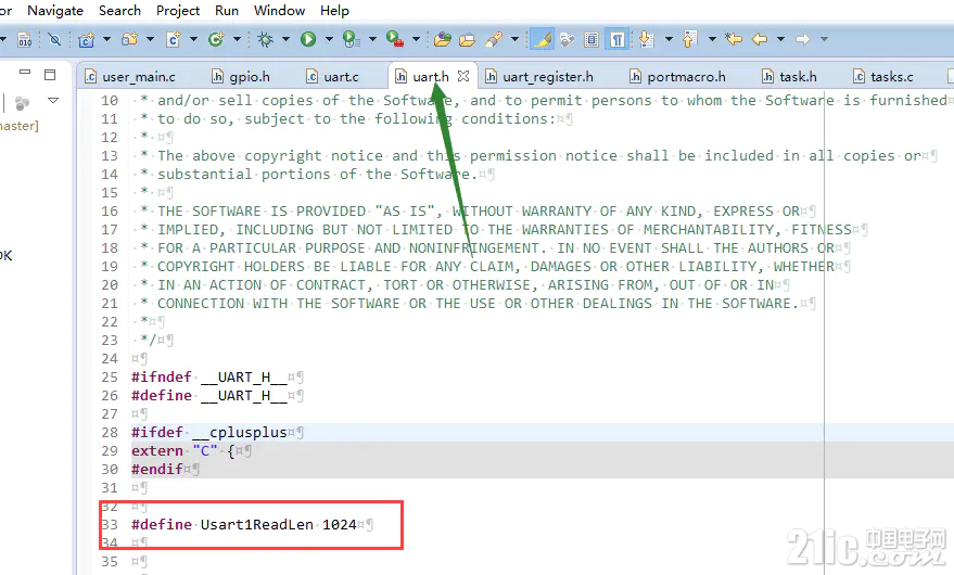

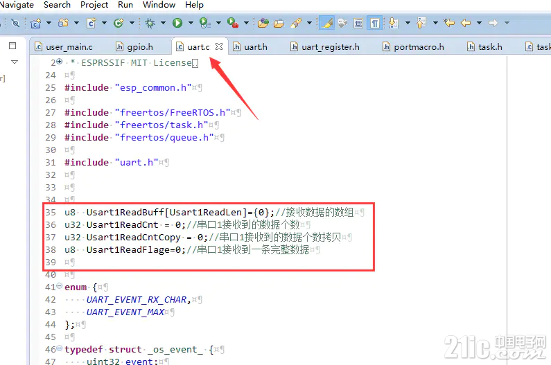

定义一些变量
 楼主| manufact 发表于 2020-8-15 16:01 | 显示全部楼层
u8  Usart1ReadBuff[Usart1ReadLen]={0};//接收数据的数组
u32 Usart1ReadCnt =0;//串口1接收到的数据个数
u32 Usart1ReadCntCopy =0;//串口1接收到的数据个数拷贝
u8  Usart1ReadFlage=0;//串口1接收到一条完整数据

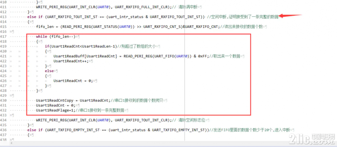

其实就是在满中断里面把数据存到咱定义的数组,在空闲中断里面读出来剩余的数据
然后置位一个标志,说明接收到一条完整的数据了
 楼主| manufact 发表于 2020-8-15 16:05 | 显示全部楼层

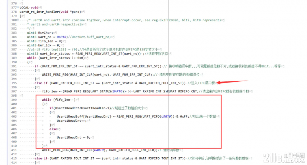

  1. LOCALvoiduart0_rx_intr_handler(void*para)
  3.     /* uart0 and uart1 intr combine togther, when interrupt occur, see reg 0x3ff20020, bit2, bit0 represents
  4.     * uart1 and uart0 respectively
  5.     */    uint8 RcvChar;
  6.     uint8 uart_no = UART0;//UartDev.buff_uart_no;
  7.     uint8 fifo_len =0;
  8.     uint8 buf_idx =0;
  9.     //uint8 fifo_tmp[128] = {0};//只是告诉我们这个单片机的内部FIFO是128字节大小
  10.     uint32 uart_intr_status = READ_PERI_REG(UART_INT_ST(uart_no)) ;//读取中断状态
  11.     while(uart_intr_status !=0x0)
  12.     {
  13.         if(UART_FRM_ERR_INT_ST == (uart_intr_status & UART_FRM_ERR_INT_ST))// 接收帧错误中断,,,可能是数据位数不对,或者接收到的数据不满8bit...等等
  14.        {
  15.             WRITE_PERI_REG(UART_INT_CLR(uart_no), UART_FRM_ERR_INT_CLR);// 清除中断寄存器的 帧错误位
  16.         }
  17.         elseif(UART_RXFIFO_FULL_INT_ST == (uart_intr_status & UART_RXFIFO_FULL_INT_ST))//进入FIFO满中断
  18.         {
  19.             fifo_len = (READ_PERI_REG(UART_STATUS(UART0)) >> UART_RXFIFO_CNT_S)&UART_RXFIFO_CNT;//读出来内部FIFO缓存的数据个数
  20.             while(fifo_len--)
  21.             {
  22.                 if(Usart1ReadCnt
  23.                     Usart1ReadBuff[Usart1ReadCnt] = READ_PERI_REG(UART_FIFO(UART0)) &0xFF;//取出来一个数据
  24.                     Usart1ReadCnt++;
  25.                 }
  26.                 else
  27.                 {
  28.                     Usart1ReadCnt =0;
  29.                 }
  30.             }
  31.             WRITE_PERI_REG(UART_INT_CLR(UART0), UART_RXFIFO_FULL_INT_CLR);// 清除满中断
  32.         }
  33.         elseif(UART_RXFIFO_TOUT_INT_ST == (uart_intr_status & UART_RXFIFO_TOUT_INT_ST))//空闲中断,证明接受到了一条完整的数据
  34.         {
  35.             fifo_len = (READ_PERI_REG(UART_STATUS(UART0)) >> UART_RXFIFO_CNT_S)&UART_RXFIFO_CNT;//读出来接收的数据个数
  36.             while(fifo_len--)
  37.             {
  38.                 if(Usart1ReadCnt
  39.                     Usart1ReadBuff[Usart1ReadCnt] = READ_PERI_REG(UART_FIFO(UART0)) &0xFF;//取出来一个数据
  40.                     Usart1ReadCnt++;
  41.                 }
  42.                 else
  43.                 {
  44.                     Usart1ReadCnt =0;
  45.                 }
  46.             }
  47.             Usart1ReadCntCopy = Usart1ReadCnt;//串口1接收到的数据个数拷贝
  48.             Usart1ReadCnt =0;
  49.             Usart1ReadFlage=1;//串口1接收到一条完整数据
  50.             WRITE_PERI_REG(UART_INT_CLR(UART0), UART_RXFIFO_TOUT_INT_CLR);// 清除空闲标志位
  51.         }

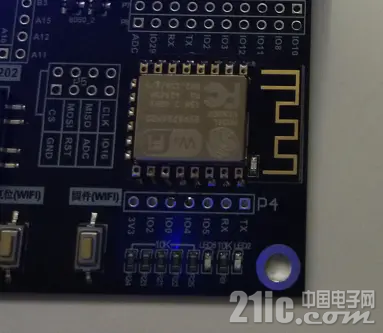

处理数据之前先预热一下操作系统
控制LED 1S亮 1S灭
 楼主| manufact 发表于 2020-8-15 16:08 | 显示全部楼层

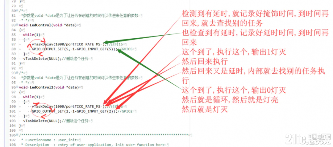

对了因为咱用的是操作系统哈,所以千万别这样想
 楼主| manufact 发表于 2020-8-15 16:09 | 显示全部楼层
应该建一个函数,还记得上一节不,对了咱只是说操作系统的使用哈,不讲实质
现在呢,把这个函数交给操作系统去管理
 楼主| manufact 发表于 2020-8-15 16:10 | 显示全部楼层
然后再完善
 楼主| manufact 发表于 2020-8-15 16:11 | 显示全部楼层
但是这样下载进去,不可以....
还记得上一节说的不,任务必须有延时
延时是用
vTaskDelay(1000/portTICK_RATE_MS );//延时1S
vTaskDelay(2000/portTICK_RATE_MS );//延时2S
有人可能有疑问,为什么要用这个,其实这是操作系统提供的延时的API,调用它给的,操作系统才知道这里要延时一会.我先去执行别的任务去
如果你不要操作系统提供的,用自己的硬延时 类如for 什么的,其实就是在这里等着了,,,,一般哈,对于延时比较苛刻的咱用自己的
比如采集DHT11,DS18B20,等等,,,这种不是很苛刻的,咱就用操作系统提供的

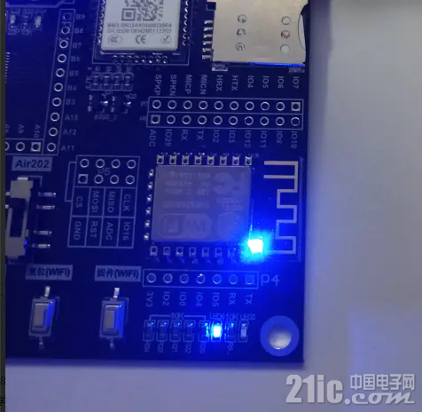

好了现在下载进去,会看到这个灯1S亮,1S灭
 楼主| manufact 发表于 2020-8-15 16:12 | 显示全部楼层
现在咱做个好玩的,两个任务控制两个灯
 楼主| manufact 发表于 2020-8-15 16:13 | 显示全部楼层
下载进去,大家会发现神奇的事情  同时亮,同时灭
其实这就是操作系统的魅力所在....如果任务延时上一样,那么你会看着两个函数是同时进行的
 楼主| manufact 发表于 2020-8-15 16:14 | 显示全部楼层
首先说一点哈
 楼主| manufact 发表于 2020-8-15 16:15 | 显示全部楼层
看着是同时亮和灭,其实他们之间有延时,就是大约延时个任务调度的时间
其实操作系统是不断的轮询各个任务,不断的挂起任务(让任务停止运行),启动任务
 楼主| manufact 发表于 2020-8-15 16:16 | 显示全部楼层
