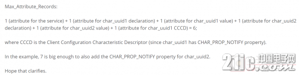

想问一下我这个初始化有什么问题导致蓝牙没有打开到接收的功能,并且报错failed:0x48,具体想问一下是哪里设置出现问题了。
void Add_Server(void)
  uint8_t status = BLE_STATUS_SUCCESS;
const uint8_t uuid[16] = {0x66,0x9a,0x0c,0x20,0x00,0x08,0x81,0x98,0xeb,0x11,0x8b,0x7d,0x20,0xd1,0x69,0x86};
  const uint8_t charUuidTX[16] = {0x66,0x9a,0x0c,0x20,0x00,0x08,0x81,0x98,0xeb,0x11,0x8b,0x7d,0x21,0xd1,0x69,0x86};
  const uint8_t charUuidRX[16] = {0x66,0x9a,0x0c,0x20,0x00,0x08,0x81,0x98,0xeb,0x11,0x8b,0x7d,0x22,0xd1,0x69,0x86};
  Osal_MemCpy(&service_uuid.Service_UUID_128, uuid, 16);
  status = aci_gatt_add_service(UUID_TYPE_128           ,&service_uuid          ,PRIMARY_SERVICE     ,0x04  ,&ServHandle);
                                                                                                    *红色表明的那位,用0x04的话蓝牙没有接收,发送和服务是正常的,用0x06的话就三个都错误了

豌豆爹 发表于 2021-3-10 10:14 | 显示全部楼层
https://community.st.com/s/question/0D50X00009XkYAvSAN/sensortile-bluenrgms-custom-service-aci
