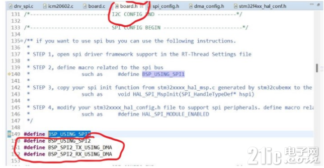

  1.启动RTT设备驱动。点击自己的程序 -》RT-Thread Setting,启动SPI设备驱动
2.在board.h中添加开启宏

4.使能HAL库-SPI,即可与RTT设备驱动接口

  OK,spi.h文件修改完成
  下面更改spi_core.c文件
  使用这个函数支持我们自定义的函数
  struct rt_spi_message *rt_spi_transfer_message(struct rt_spi_device *device,
  struct rt_spi_message *message)
  添加如下载数量
  struct rt_spi_message *rt_spi_transfer_message_my(struct rt_spi_device *device,
  struct rt_spi_message *message, rt_sem_t sem)
  rt_err_t result;
  struct rt_spi_message *index;
  RT_ASSERT(device != RT_NULL);
  /* get first message */
  index = message;
  if (index == RT_NULL)
  return index;
  result = rt_mutex_take(&(device-》bus-》lock), RT_WAITING_FOREVER);
  if (result != RT_EOK)
  rt_set_errno(-RT_EBUSY);
  return index;
  /* reset errno */
  rt_set_errno(RT_EOK);
  /* configure SPI bus */
  if (device-》bus-》owner != device)
  /* not the same owner as current, re-configure SPI bus */
  result = device-》bus-》ops-》configure(device, &device-》config);
  if (result == RT_EOK)
  /* set SPI bus owner */
  device-》bus-》owner = device;
  else
  /* configure SPI bus failed */
  rt_set_errno(-RT_EIO);
  goto __exit;
  /* transmit each SPI message */
  while (index != RT_NULL)
  /* transmit SPI message */
  result = device-》bus-》ops-》xfer_my(device, index, sem);
  if (result == 0)
  break;
  index = index-》next;
  __exit:
  /* release bus lock */
  rt_mutex_release(&(device-》bus-》lock));
  return index;
 楼主| 豌豆爹 发表于 2023-4-19 14:56 | 显示全部楼层
在spi.h里新加入此函数的声音,提供外部调用
  struct rt_spi_message *message, rt_sem_t sem);
  OK,全部搞定
