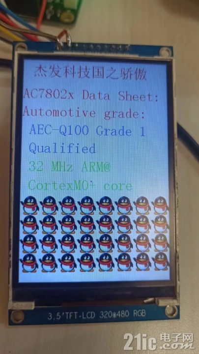

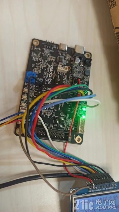

   驱动TFT LCD:
LCD接口:先用普通口模拟,发现速度慢,用SPI驱动明显加快!
先测试个demo:
  1. #include "gpio.h"
  2. #include "timer.h"
  3. #include "lcd_init.h"
  4. #include "lcd.h"
  5. #include "pic.h"
  6. int main(void)
  7. {
  8.
  9.                 unsigned char  i,j;
  10.                 float t=0;
  11.                 InitDelay();
  12.                 LCD_Init();//LCD³õʼ»¯
  13.                 LCD_Fill(0,0,LCD_W,LCD_H,WHITE);
  14.         while(1)
  15.         {
  16.
  17.                 LCD_ShowChinese(20,8,"杰发科技国之骄傲",RED,WHITE,32,0);
  18.                 LCD_ShowString(0,60,"AC7802x Data Sheet:",RED,WHITE,32,0);
  19.                 LCD_ShowString(0,100,"Automotive grade:",RED,WHITE,32,0);
  20.                 LCD_ShowString(0,140," AEC-Q100 Grade 1 ",BLUE,WHITE,32,0);
  21.                 LCD_ShowString(0,180," Qualified",BLUE,WHITE,32,0);
  22.                 LCD_ShowString(0,220," 32 MHz ARM[url=home.php?mod=space&uid=72445]@[/url] ",GREEN,WHITE,32,0);
  23.                 LCD_ShowString(0,260," CortexM0+ core",GREEN,WHITE,32,0);
  24. for(j=0;j<4;j++)
  25.                 {
  26.    for(i=0;i<8;i++)
  27.     {
  28.    LCD_ShowPicture(40*i,300+j*40,40,40,gImage_1);
  29.      }
  30.    }
  31.         }

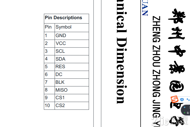

接口定义:
  1. #ifndef __LCD_INIT_H
  2. #define __LCD_INIT_H
  3. #include "ac780x_gpio.h"
  4. //#include "ac7802x.h"
  5. #define USE_HORIZONTAL 0  //ÉèÖúáÆÁ»òÕßÊúÆÁÏÔʾ 0»ò1ΪÊúÆÁ 2»ò3ΪºáÆÁ
  6. //typedef unsigned int  u32;
  7. //typedef unsigned int  u16;
  8. //typedef unsigned char  u8;
  9. typedef uint32_t u32;
  10. typedef uint16_t u16;
  11. typedef uint8_t u8;
  12. #if USE_HORIZONTAL==0||USE_HORIZONTAL==1
  13. #define LCD_W 320
  14. #define LCD_H 480
  15. #else
  16. #define LCD_W 480
  17. #define LCD_H 320
  18. #endif
  19. #define LCD_SCLK_Clr() GPIO_SetPinLevel(GPIOA, GPIO_PIN0, GPIO_LEVEL_LOW);
  20. #define LCD_SCLK_Set() GPIO_SetPinLevel(GPIOA, GPIO_PIN0, GPIO_LEVEL_HIGH);
  21. #define LCD_MOSI_Clr() GPIO_SetPinLevel(GPIOA, GPIO_PIN1, GPIO_LEVEL_LOW);
  22. #define LCD_MOSI_Set() GPIO_SetPinLevel(GPIOA, GPIO_PIN1, GPIO_LEVEL_HIGH);
  23. #define LCD_RES_Clr()  GPIO_SetPinLevel(GPIOA, GPIO_PIN2, GPIO_LEVEL_LOW);
  24. #define LCD_RES_Set()  GPIO_SetPinLevel(GPIOA, GPIO_PIN2, GPIO_LEVEL_HIGH);
  25. #define LCD_DC_Clr()   GPIO_SetPinLevel(GPIOA, GPIO_PIN3, GPIO_LEVEL_LOW);
  26. #define LCD_DC_Set()   GPIO_SetPinLevel(GPIOA, GPIO_PIN3, GPIO_LEVEL_HIGH);
  27. #define LCD_BLK_Clr()  GPIO_SetPinLevel(GPIOA, GPIO_PIN4, GPIO_LEVEL_LOW);
  28. #define LCD_BLK_Set()  GPIO_SetPinLevel(GPIOA, GPIO_PIN4, GPIO_LEVEL_HIGH);
  29. #define ZK_MISO        GPIO_GetPinLevel(GPIOA,GPIO_PIN5)//MISO  ¶ÁÈ¡×Ö¿âÊý¾ÝÒý½Å
  30. //#define ZK_MISO        GPIO_ReadInputDataBit(GPIOA,GPIO_Pin_5)//MISO  ¶ÁÈ¡×Ö¿âÊý¾ÝÒý½Å
  31. #define LCD_CS_Clr()   GPIO_SetPinLevel(GPIOA, GPIO_PIN6, GPIO_LEVEL_LOW);
  32. #define LCD_CS_Set()   GPIO_SetPinLevel(GPIOA, GPIO_PIN6, GPIO_LEVEL_HIGH);
  33. #define ZK_CS_Clr()    GPIO_SetPinLevel(GPIOA, GPIO_PIN7, GPIO_LEVEL_LOW);
  34. #define ZK_CS_Set()    GPIO_SetPinLevel(GPIOA, GPIO_PIN7, GPIO_LEVEL_HIGH);
  35. void LCD_GPIO_Init(void);//³õʼ»¯GPIO
  36. void LCD_Writ_Bus(u8 dat);//Ä£ÄâSPIʱÐò
  37. void LCD_WR_DATA8(u8 dat);//дÈëÒ»¸ö×Ö½Ú
  38. void LCD_WR_DATA(u32 dat);//дÈëÈý¸ö×Ö½Ú
  39. void LCD_WR_REG(u8 dat);//дÈëÒ»¸öÖ¸Áî
  40. void LCD_Address_Set(u16 x1,u16 y1,u16 x2,u16 y2);//ÉèÖÃ×ø±êº¯Êý
  41. void LCD_Init(void);//LCD³õʼ»¯
  42. #endif

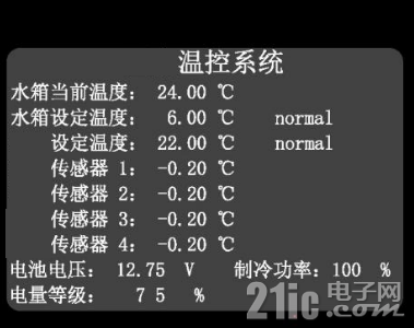

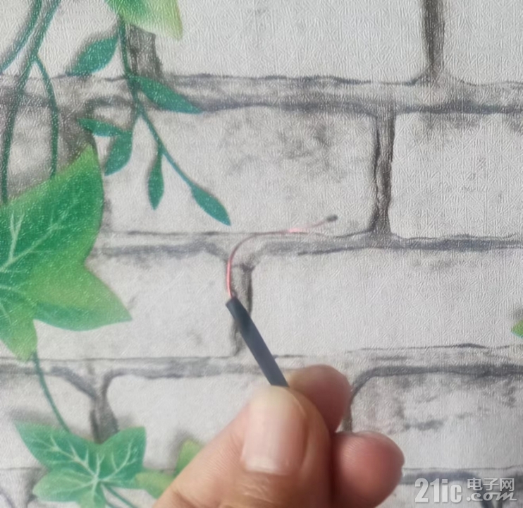

传感器采用多组热敏传感器 :
多通道 ADC采集热敏传感器数据
关键算法:
