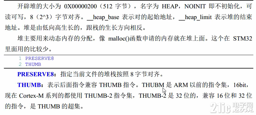

; <h> Heap Configuration
; 堆配置,主要用于动态内存的分配
; <o> Heap Size (in Bytes) <0x0-0xFFFFFFFF:8>
; </h>
Heap_Size EQU 0x00000200
AREA HEAP, NOINIT, READWRITE, ALIGN=3
__heap_base
Heap_Mem SPACE Heap_Size
__heap_limit
PRESERVE8 ; 当前堆栈以8字节对齐
THUMB

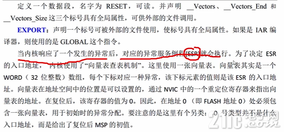

; Vector Table Mapped to Address 0 at Reset
AREA RESET, DATA, READONLY
EXPORT __Vectors
EXPORT __Vectors_End
EXPORT __Vectors_Size
__Vectors DCD __initial_sp ; Top of Stack
DCD Reset_Handler ; Reset Handler
DCD NMI_Handler ; NMI Handler
DCD HardFault_Handler ; Hard Fault Handler
DCD MemManage_Handler ; MPU Fault Handler
DCD BusFault_Handler ; Bus Fault Handler
DCD UsageFault_Handler ; Usage Fault Handler
DCD 0 ; Reserved
DCD 0 ; Reserved
DCD 0 ; Reserved
DCD 0 ; Reserved
DCD SVC_Handler ; SVCall Handler
DCD DebugMon_Handler ; Debug Monitor Handler
DCD 0 ; Reserved
DCD PendSV_Handler ; PendSV Handler
DCD SysTick_Handler ; SysTick Handler

2.2 堆
__heap_base
__heap_limit
THUMB
2.3 中断向量表
EXPORT __Vectors
DCD 0 ; Reserved
DCD 0 ; Reserved
DCD 0 ; Reserved
DCD 0 ; Reserved
DCD 0 ; Reserved

2.4 复位程序
; Reset handler
Reset_Handler PROC
EXPORT Reset_Handler [WEAK] ;弱定义
IMPORT __main
IMPORT SystemInit ; 系统时钟配置函数,由用户编写
LDR R0, =SystemInit
BLX R0
LDR R0, =__main
BX R0
ENDP

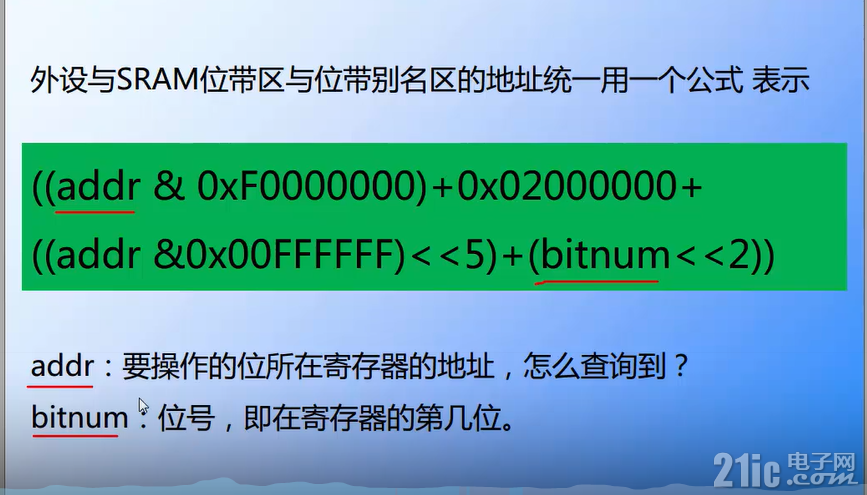

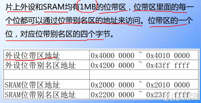

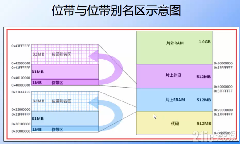

1. GPIO的位带操作
1.1 位带在哪里
1.2 位带去大小
1.3 地址转换
1.4 统一地址
