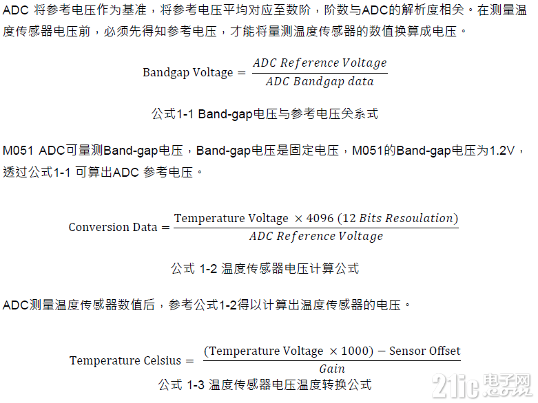

  1. /**************************************************************************//**
  2. * [url=home.php?mod=space&uid=288409]@file[/url]     main.c
  3. * @brief

  78.     double   dVref;
  79.     double   dTempData;
  80.     printf("+----------------------------------------------------------------------+\n");
  81.     printf("|               ADC for temperature sensor example code                |\n");

  103.         /* clear the A/D interrupt flag for safe */
  104.         ADC_CLR_INT_FLAG(ADC, ADC_ADF_INT);
  105.         /* Calculate dVref by using conversion result of VBG */
  106.         /* ConversionData = VBG * 4096 / Vref */
  107.         i32ConversionData = ADC_GET_CONVERSION_DATA(ADC, 7);
  108.         dVref = VBG * 4096 / (double)i32ConversionData;
  109.         /* Delay */
  110.         CLK_SysTickDelay(500000);
  111.         /* Configure the analog input source of channel 7 */
  112.         ADC_CONFIG_CH7(ADC, ADC_ADCHER_PRESEL_INT_TEMPERATURE_SENSOR);
  113.         /* start A/D conversion */
  114.         ADC_START_CONV(ADC);
  115.         /* Wait conversion done */
  116.         while (!ADC_GET_INT_FLAG(ADC, ADC_ADF_INT));
  117.         /* Stop A/D conversion */
  118.         ADC_STOP_CONV(ADC);
  119.         /* clear the A/D interrupt flag for safe */
  120.         ADC_CLR_INT_FLAG(ADC, ADC_ADF_INT);
  121.         /* Calculate value from temperature sensor  */
  122.         /* ConversionData = Vtemp(V) * 4096 / dVref */
  123.         /* Vtemp(mV) = Gain * Temperature + Offset  */
  124.         i32ConversionData = ADC_GET_CONVERSION_DATA(ADC, 7);
