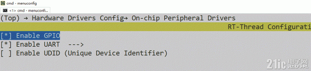

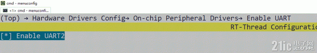

7、menuconfig
在C:\rt-thread\bsp\stm32\stm32h533-st-nucleo目录下打开env tools
键入:
menuconfig
只设置GPIO和UART
退出保存。

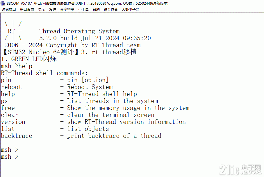

三、运行效果
1、main.c
  1. #include <rtthread.h>
  2. #include <rtdevice.h>
  3. #include <board.h>
  4. /* defined the LED1 pin: PB0 */
  5. #define LED1_PIN    GET_PIN(A, 5)
  6. int main(void)
  7. {
  8.     int count = 1;
  9.
  10.                 rt_kprintf("【STM32 Nucleo-64测评】3、rt-thread移植\r\n");
  11.                 rt_kprintf("1、GREEN LED闪烁\r\n");
  12.     /* set LED0 pin mode to output */
  13.     rt_pin_mode(LED1_PIN, PIN_MODE_OUTPUT);
  14.     while (count++)
  15.     {
  16.         rt_pin_write(LED1_PIN, PIN_HIGH);
  17.         rt_thread_mdelay(500);
  18.         rt_pin_write(LED1_PIN, PIN_LOW);
  19.         rt_thread_mdelay(500);
  20.     }
  21.     return RT_EOK;
  22. }
2、串口输出
另外板载LED闪烁
