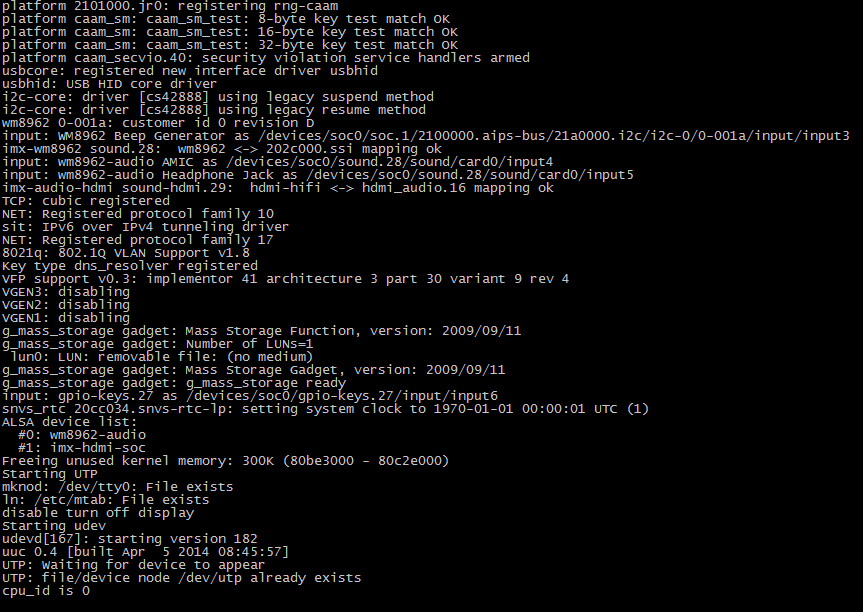

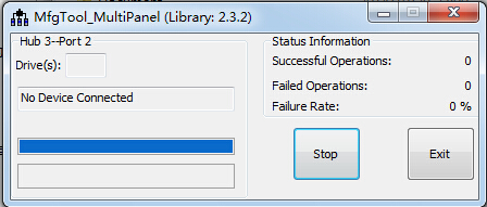

 楼主| yze123 发表于 2014-10-29 23:21 | 显示全部楼层
这是相应提示
串口打印信息到此就不动了
串口打印信息到此就不动了
MFGTool刚到jumping to OS image不久就变成这样了

 楼主| yze123 发表于 2014-10-29 23:26 | 显示全部楼层
我是从官网下载MFGTool,不做修改,按默认配置(默认烧到SD卡),按照正常步骤烧录的,3.0.35是可以的,但是3.10.17就是失败,求大神指点,好迷茫,刚开始学习就卡住好几天了.............

串口全部打印信息如下:
U-Boot 2013.04 (Apr 05 2014 - 08:50:42)
CPU:   Freescale i.MX6Q rev1.2 at 792 MHz
CPU:   Temperature 33 C, calibration data: 0x5bf4eb7d
Reset cause: POR
Board: MX6Q/SDL-SabreSD
I2C:   ready
DRAM:  1 GiB
MMC:   FSL_SDHC: 0, FSL_SDHC: 1, FSL_SDHC: 2
*** Warning - bad CRC, using default environment
No panel detected: default to Hannstar-XGA
Display: Hannstar-XGA (1024x768)
In:    serial
Out:   serial
Err:   serial
Found PFUZE100! deviceid=10,revid=11
mmc1 is current device
Net:   FEC [PRIME]
Warning: FEC using MAC address from net device
Boot from USB for mfgtools
Use default environment for mfgtools
Run bootcmd_mfg: run mfgtool_args;bootm ${loadaddr} ${initrd_addr} ${fdt_addr};
Hit any key to stop autoboot:  0
## Booting kernel from Legacy Image at 12000000 ...
   Image Name:   Linux-3.10.17-1.0.0_ga+g232293e
   Image Type:   ARM Linux Kernel Image (uncompressed)
   Data Size:    5182880 Bytes = 4.9 MiB
   Load Address: 10008000
   Entry Point:  10008000
   Verifying Checksum ... OK
## Loading init Ramdisk from Legacy Image at 12c00000 ...
   Image Name:   initramfs
   Image Type:   ARM Linux RAMDisk Image (gzip compressed)
   Data Size:    4399687 Bytes = 4.2 MiB
   Load Address: 12c00000
   Entry Point:  12c00000
## Flattened Device Tree blob at 18000000
   Booting using the fdt blob at 0x18000000
   Loading Kernel Image ... OK
OK
switch to ldo_bypass mode!
   Using Device Tree in place at 18000000, end 1800e84a
Starting kernel ...

CPU: All CPU(s) started in SVC mode.
devtmpfs: initialized
pinctrl core: initialized pinctrl subsystem
regulator-dummy: no parameters
NET: Registered protocol family 16
DMA: preallocated 256 KiB pool for atomic coherent allocations
Use WDOG2 as reset source
syscon 20c8000.anatop: regmap [mem 0x020c8000-0x020c8fff] registered
vdd1p1: 800 <--> 1375 mV at 1125 mV
vdd3p0: 2800 <--> 3150 mV at 3000 mV
vdd2p5: 2000 <--> 2750 mV at 2425 mV
cpu: 725 <--> 1450 mV
vddpu: 725 <--> 1450 mV
vddsoc: 725 <--> 1450 mV
syscon 20e0000.iomuxc-gpr: regmap [mem 0x020e0000-0x020e0037] registered
syscon 21bc000.ocotp-ctrl: regmap [mem 0x021bc000-0x021bffff] registered
hw-breakpoint: found 5 (+1 reserved) breakpoint and 1 watchpoint registers.
hw-breakpoint: maximum watchpoint size is 4 bytes.
imx6q-pinctrl 20e0000.iomuxc: initialized IMX pinctrl driver
bio: create slab <bio-0> at 0
mxs-dma 110000.dma-apbh: initialized
usb_otg_vbus: 5000 mV
usb_h1_vbus: 5000 mV
wm8962-supply: no parameters
mipi_dsi_pwr_on: no parameters
sensor-supply: 3300 mV
i2c-core: driver [max17135] using legacy suspend method
i2c-core: driver [max17135] using legacy resume method
SCSI subsystem initialized
usbcore: registered new interface driver usbfs
usbcore: registered new interface driver hub
usbcore: registered new device driver usb
i2c i2c-0: IMX I2C adapter registered
i2c i2c-1: IMX I2C adapter registered
i2c i2c-2: IMX I2C adapter registered
Linux video capture interface: v2.00
pps_core: LinuxPPS API ver. 1 registered
pps_core: Software ver. 5.3.6 - Copyright 2005-2007 Rodolfo Giometti <giometti@linux.it>
PTP clock support registered
imx-ipuv3 2400000.ipu: IPU DMFC NORMAL mode: 1(0~1), 5B(4,5), 5F(6,7)
imx-ipuv3 2800000.ipu: IPU DMFC NORMAL mode: 1(0~1), 5B(4,5), 5F(6,7)
mxc_mipi_csi2 21dc000.mipi_csi: i.MX MIPI CSI2 driver probed
mxc_mipi_csi2 21dc000.mipi_csi: i.MX MIPI CSI2 dphy version is 0x3130302a
MIPI CSI2 driver module loaded
Advanced Linux Sound Architecture Driver Initialized.
cfg80211: Calling CRDA to update world regulatory domain
Switching to clocksource mxc_timer1
NET: Registered protocol family 2
TCP established hash table entries: 8192 (order: 4, 65536 bytes)
TCP bind hash table entries: 8192 (order: 4, 65536 bytes)
TCP: Hash tables configured (established 8192 bind 8192)
TCP: reno registered
UDP hash table entries: 512 (order: 2, 16384 bytes)
UDP-Lite hash table entries: 512 (order: 2, 16384 bytes)
RPC: Registered named UNIX socket transport module.
RPC: Registered udp transport module.
RPC: Registered tcp transport module.
RPC: Registered tcp NFSv4.1 backchannel transport module.
Trying to unpack rootfs image as initramfs...
Freeing initrd memory: 4292K (82c01000 - 83032000)
hw perfevents: enabled with ARMv7 Cortex-A9 PMU driver, 7 counters available
pureg-dummy: no parameters
imx6_busfreq busfreq.15: DDR medium rate not supported.
Bus freq driver module loaded
VFS: Disk quotas dquot_6.5.2
Dquot-cache hash table entries: 1024 (order 0, 4096 bytes)
NFS: Registering the id_resolver key type
Key type id_resolver registered
Key type id_legacy registered
jffs2: version 2.2. (NAND) 漏 2001-2006 Red Hat, Inc.
fuse init (API version 7.22)
msgmni has been set to 2002
io scheduler noop registered
io scheduler deadline registered
io scheduler cfq registered (default)
imx-weim 21b8000.weim: WEIM driver registered.
mxc_mipi_dsi 21e0000.mipi: i.MX MIPI DSI driver probed
MIPI DSI driver module loaded
mxc_sdc_fb fb.30: register mxc display driver ldb
imx-ipuv3 2800000.ipu: IPU DMFC DP HIGH RESOLUTION: 1(0,1), 5B(2~5), 5F(6,7)
Console: switching to colour frame buffer device 128x48
mxc_sdc_fb fb.31: register mxc display driver hdmi
mxc_hdmi 20e0000.hdmi_video: Detected HDMI controller 0x13:0xa:0xa0:0xc1
fbcvt: 1920x1080@60: CVT Name - 2.073M9
mxc_sdc_fb fb.32: register mxc display driver lcd
mxc_sdc_fb fb.32: ipu0-di0 already in use
mxc_sdc_fb: probe of fb.32 failed with error -16
mxc_sdc_fb fb.33: register mxc display driver ldb
imx-sdma 20ec000.sdma: no iram assigned, using external mem
imx-sdma 20ec000.sdma: loaded firmware 1.1
imx-sdma 20ec000.sdma: initialized
pfuze100-regulator 1-0008: Full lay: 1, Metal lay: 1
pfuze100-regulator 1-0008: FAB: 0, FIN: 1
SW1AB: 300 <--> 1875 mV at 1175 mV
SW1C: 300 <--> 1875 mV at 1175 mV
SW2: 800 <--> 3300 mV at 3300 mV
SW3A: 400 <--> 1975 mV at 1500 mV
SW3B: 400 <--> 1975 mV at 1500 mV
SW4: 800 <--> 3300 mV at 3150 mV
SWBST: 5000 <--> 5150 mV at 5000 mV
VSNVS: 1000 <--> 3000 mV at 3000 mV
VREFDDR: 750 mV
VGEN1: 800 <--> 1550 mV at 1500 mV
VGEN2: 800 <--> 1550 mV at 1500 mV
VGEN3: 1800 <--> 3300 mV at 2800 mV
VGEN4: 1800 <--> 3300 mV at 1800 mV
VGEN5: 1800 <--> 3300 mV at 3000 mV
VGEN6: 1800 <--> 3300 mV at 3300 mV
Serial: IMX driver
2020000.serial: ttymxc0 at MMIO 0x2020000 (irq = 58) is a IMX
console [ttymxc0] enabled
serial: Freescale lpuart driver
[drm] Initialized drm 1.1.0 20060810
[drm] Initialized vivante 1.0.0 20120216 on minor 0
brd: module loaded
loop: module loaded
Wait for CR ACK error!
sata phy RX_PLL is stable!
ahci: SSS flag set, parallel bus scan disabled
ahci ahci: AHCI 0001.0300 32 slots 1 ports 3 Gbps 0x1 impl platform mode
ahci ahci: flags: ncq sntf stag pm led clo only pmp pio slum part ccc apst
scsi0 : ahci_platform
ata1: SATA max UDMA/133 mmio [mem 0x02200000-0x02203fff] port 0x100 irq 71
m25p80 spi32766.0: found mr25h256, expected m25p32
m25p80 spi32766.0: mr25h256 (32 Kbytes)
spi_imx 2008000.ecspi: probed
libphy: fec_enet_mii_bus: probed
fec 2188000.ethernet eth0: registered PHC device 0
ehci_hcd: USB 2.0 'Enhanced' Host Controller (EHCI) Driver
usbcore: registered new interface driver usb-storage
ci_hdrc ci_hdrc.0: EHCI Host Controller
ci_hdrc ci_hdrc.0: new USB bus registered, assigned bus number 1
ci_hdrc ci_hdrc.0: USB 2.0 started, EHCI 1.00
hub 1-0:1.0: USB hub found
hub 1-0:1.0: 1 port detected
ci_hdrc ci_hdrc.1: doesn't support gadget
ci_hdrc ci_hdrc.1: EHCI Host Controller
ci_hdrc ci_hdrc.1: new USB bus registered, assigned bus number 2
ci_hdrc ci_hdrc.1: USB 2.0 started, EHCI 1.00
hub 2-0:1.0: USB hub found
hub 2-0:1.0: 1 port detected
mousedev: PS/2 mouse device common for all mice
elan-touch 2-0010: elan - Read Hello Packet Failed
elan-touch: probe of 2-0010 failed with error -22
egalax_ts 1-0004: Failed to read firmware version
egalax_ts: probe of 1-0004 failed with error -5
ata1: SATA link down (SStatus 0 SControl 300)
egalax_ts 2-0004: Failed to read firmware version
egalax_ts: probe of 2-0004 failed with error -5
input: max11801_ts as /devices/soc0/soc.1/2100000.aips-bus/21a4000.i2c/i2c-1/1-0048/input/input0
i2c-core: driver [isl29023] using legacy suspend method
i2c-core: driver [isl29023] using legacy resume method
snvs_rtc 20cc034.snvs-rtc-lp: rtc core: registered 20cc034.snvs-rtc-lp as rtc0
i2c /dev entries driver
mxc_v4l2_output v4l2_out.38: V4L2 device registered as video16
mxc_v4l2_output v4l2_out.38: V4L2 device registered as video17
mxc_v4l2_output v4l2_out.38: V4L2 device registered as video18
mxc_v4l2_output v4l2_out.38: V4L2 device registered as video19
mxc_v4l2_output v4l2_out.38: V4L2 device registered as video20
mag3110 2-000e: check mag3110 chip ID
input: mag3110 as /devices/virtual/input/input1
mag3110 2-000e: mag3110 is probed
i2c-core: driver [mag3110] using legacy suspend method
i2c-core: driver [mag3110] using legacy resume method
input: mma845x as /devices/virtual/input/input2
imx2-wdt 20bc000.wdog: IMX2+ Watchdog Timer enabled. timeout=60s (nowayout=0)
cpuidle: using governor ladder
cpuidle: using governor menu
sdhci: Secure Digital Host Controller Interface driver
sdhci: Copyright(c) Pierre Ossman
sdhci-pltfm: SDHCI platform and OF driver helper
mmc0: no vqmmc regulator found
mmc0: no vmmc regulator found
mmc0: SDHCI controller on 2194000.usdhc [2194000.usdhc] using ADMA
mmc1: no vqmmc regulator found
mmc1: no vmmc regulator found
mmc1: SDHCI controller on 2198000.usdhc [2198000.usdhc] using ADMA
mmc2: no vqmmc regulator found
mmc2: no vmmc regulator found
mmc2: SDHCI controller on 219c000.usdhc [219c000.usdhc] using ADMA
mmc1: new high speed SDHC card at address e624
mmcblk0: mmc1:e624 SU08G 7.40 GiB
mmcblk0: p1
mmc2: new high speed DDR MMC card at address 0001
mmcblk1: mmc2:0001 SEM08G 7.39 GiB
Galcore version 4.6.9.9754
mmcblk1boot0: mmc2:0001 SEM08G partition 1 2.00 MiB
mmcblk1boot1: mmc2:0001 SEM08G partition 2 2.00 MiB
mmcblk1rpmb: mmc2:0001 SEM08G partition 3 128 KiB
mmcblk1: unknown partition table
mmcblk1boot1: unknown partition table
mmcblk1boot0: unknown partition table
mxc_vdoa 21e4000.vdoa: i.MX Video Data Order Adapter(VDOA) driver probed
mxc_asrc 2034000.asrc: mxc_asrc registered
mxc_vpu 2040000.vpu: VPU initialized
caam 2100000.caam: device ID = 0x0a16010000000000 (Era -524)
caam 2100000.caam: job rings = 2, qi = 0
caam 2100000.caam: authenc-hmac-md5-cbc-aes-caam
caam 2100000.caam: authencesn-hmac-md5-cbc-aes-caam
caam 2100000.caam: authenc-hmac-sha1-cbc-aes-caam
caam 2100000.caam: authencesn-hmac-sha1-cbc-aes-caam
caam 2100000.caam: authenc-hmac-sha224-cbc-aes-caam
caam 2100000.caam: authencesn-hmac-sha224-cbc-aes-caam
caam 2100000.caam: authenc-hmac-sha256-cbc-aes-caam
caam 2100000.caam: authencesn-hmac-sha256-cbc-aes-caam
caam 2100000.caam: authenc-hmac-md5-cbc-des3_ede-caam
caam 2100000.caam: authencesn-hmac-md5-cbc-des3_ede-caam
caam 2100000.caam: authenc-hmac-sha1-cbc-des3_ede-caam
caam 2100000.caam: authencesn-hmac-sha1-cbc-des3_ede-caam
caam 2100000.caam: authenc-hmac-sha224-cbc-des3_ede-caam
caam 2100000.caam: authencesn-hmac-sha224-cbc-des3_ede-caam
caam 2100000.caam: authenc-hmac-sha256-cbc-des3_ede-caam
caam 2100000.caam: authencesn-hmac-sha256-cbc-des3_ede-caam
caam 2100000.caam: authenc-hmac-md5-cbc-des-caam
caam 2100000.caam: authencesn-hmac-md5-cbc-des-caam
caam 2100000.caam: authenc-hmac-sha1-cbc-des-caam
caam 2100000.caam: authencesn-hmac-sha1-cbc-des-caam
caam 2100000.caam: authenc-hmac-sha224-cbc-des-caam
caam 2100000.caam: authencesn-hmac-sha224-cbc-des-caam
caam 2100000.caam: authenc-hmac-sha256-cbc-des-caam
caam 2100000.caam: authencesn-hmac-sha256-cbc-des-caam
caam 2100000.caam: ecb-des-caam
caam 2100000.caam: ecb-arc4-caam
caam 2100000.caam: ecb-aes-caam
caam 2100000.caam: ctr-aes-caam
caam 2100000.caam: cbc-aes-caam
caam 2100000.caam: ecb-des3-caam
caam 2100000.caam: cbc-3des-caam
caam 2100000.caam: cbc-des-caam
caam 2100000.caam: fsl,sec-v4.0 algorithms registered in /proc/crypto
platform 2101000.jr0: registering rng-caam
platform caam_sm: caam_sm_test: 8-byte key test match OK
platform caam_sm: caam_sm_test: 16-byte key test match OK
platform caam_sm: caam_sm_test: 32-byte key test match OK
platform caam_secvio.40: security violation service handlers armed
usbcore: registered new interface driver usbhid
usbhid: USB HID core driver
i2c-core: driver [cs42888] using legacy suspend method
i2c-core: driver [cs42888] using legacy resume method
wm8962 0-001a: customer id 0 revision D
input: WM8962 Beep Generator as /devices/soc0/soc.1/2100000.aips-bus/21a0000.i2c/i2c-0/0-001a/input/input3
imx-wm8962 sound.28:  wm8962 <-> 202c000.ssi mapping ok
input: wm8962-audio AMIC as /devices/soc0/sound.28/sound/card0/input4
input: wm8962-audio Headphone Jack as /devices/soc0/sound.28/sound/card0/input5
imx-audio-hdmi sound-hdmi.29:  hdmi-hifi <-> hdmi_audio.16 mapping ok
TCP: cubic registered
NET: Registered protocol family 10
sit: IPv6 over IPv4 tunneling driver
NET: Registered protocol family 17
8021q: 802.1Q VLAN Support v1.8
Key type dns_resolver registered
VFP support v0.3: implementor 41 architecture 3 part 30 variant 9 rev 4
VGEN3: disabling
VGEN2: disabling
VGEN1: disabling
g_mass_storage gadget: Mass Storage Function, version: 2009/09/11
g_mass_storage gadget: Number of LUNs=1
lun0: LUN: removable file: (no medium)
g_mass_storage gadget: Mass Storage Gadget, version: 2009/09/11
g_mass_storage gadget: g_mass_storage ready
input: gpio-keys.27 as /devices/soc0/gpio-keys.27/input/input6
snvs_rtc 20cc034.snvs-rtc-lp: setting system clock to 1970-01-01 00:00:01 UTC (1)
ALSA device list:
  #0: wm8962-audio
  #1: imx-hdmi-soc
Freeing unused kernel memory: 300K (80be3000 - 80c2e000)
Starting UTP
mknod: /dev/tty0: File exists
ln: /etc/mtab: File exists
disable turn off display
Starting udev
udevd[167]: starting version 182
uuc 0.4 [built Apr  5 2014 08:45:57]
UTP: Waiting for device to appear
UTP: file/device node /dev/utp already exists
cpu_id is 0

在Mfgtools工具上可以出现HID-compliant device,然后点击Start按钮,可以依次看到以下过程:loading uboot,doing kernel,doing initramfs,Jump to OS image,可在出现Jump to OS image后3s左右,则立即出现No Device Connected,然后一直停留在No Device Connected
 楼主| yze123 发表于 2014-10-30 10:57 | 显示全部楼层
求助啊啊啊啊

 楼主| yze123 发表于 2014-10-31 17:09 | 显示全部楼层
FSL_TICS_Rita 发表于 2014-10-31 15:12
楼主你好,请问你SD卡是放在哪个卡槽中的是SD3吗?
是SD3啊。
同样的操作,Linux3.0.35的烧写都可以了呢
FSL_TICS_Rita 发表于 2014-10-31 17:27 | 显示全部楼层
是SD3啊。
楼主你好,我这边试过是可以的。要不你看一下文档 i.MX_6_SABRE-SD_Linux_User\'s_Guide.pdf (325.08 KB, 下载次数: 195)
FSL_TICS_Rita 发表于 2014-10-31 17:29 | 显示全部楼层
是SD3啊。
请问你download mode 有设置正确的吗?
 楼主| yze123 发表于 2014-10-31 18:25 | 显示全部楼层
你好,download mode是按照这个来的,2与7拨到ON
download mode 就是按照这个来的,2与7拨到ON
