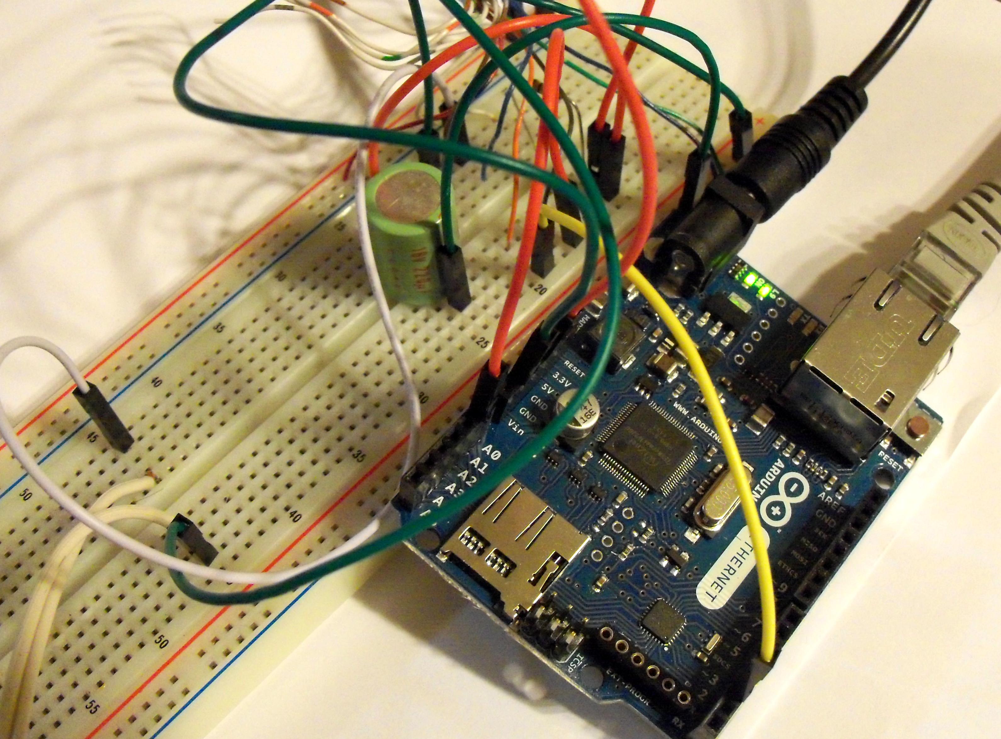

使用ADC及GPIO控制GP2Y1010AU0F
公式及原理參考
http://www.howmuchsnow.com/arduino/airquality/
測試得到的資料和空氣品質對照:
3000 + = 很差
1050-3000 = 差
300-1050 = 一般
150-300 = 好
75-150 = 很好
0-75 = 非常好

huangcunxiake 发表于 2017-4-6 19:52 | 显示全部楼层
The unit is amazingly sensitive. It easily sees the dust kicked up from walking on a rug or the vapors from cooking. Looking at the graphs below you can see some interesting things. First you can see that things settle down at night when people are not walking around. You can see around noon that my daughter cooked lunch. It's surprising how long it takes for the fine particles to settle down.
ApproachSet UpAn Arduino Ethernet is connected to the Sharp sensor following the schematic in the Sharp GP2Y1010AU0F Spec sheet. The LED connected to pin 2 is turned on, after 0.28ms the analog pin A0 connected to Vo is sampled. 0.04ms later, the LED is turned off and 9.680ms is waited before the 10ms sequence is repeated (Arduino Source Code).Sharp pin 1 (V-LED)   => 5V (connected to 150ohm resister)Sharp pin 2 (LED-GND) => Arduino GND pinSharp pin 3 (LED)     => Arduino pin 2Sharp pin 4 (S-GND)   => Arduino GND pinSharp pin 5 (Vo)      => Arduino A0 pinSharp pin 6 (Vcc)     => 5V connector.jpg fan.jpg
I used a small 40mm fan to help make sure air was circulated thru the Sharp sensor. This probably is not required, but since I am mounting one of the sensors outside in a radiation shield, I wanted to make sure I saw any pollen floating by.
Testing and Calibration 100_1396a.jpg The Pancake test :-)
