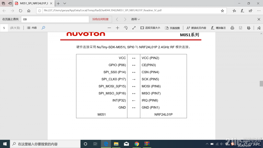

[DemoCode下载] M051 SPI接口驱动NRF24L01P模块
752|5
 楼主| wanduzi 发表于 2020-3-29 11:58 | 显示全部楼层 |阅读模式
EC_M051_SPI_NRF24L01P_V1.00.zip (1.41 MB, 下载次数: 8)

  69.     /* Enable UART peripheral clock */
  70.     CLK_EnableModuleClock(UART0_MODULE);
  71.     /* Enable SPI0 peripheral clock */
  72.     CLK_EnableModuleClock(SPI0_MODULE);
  73.     /*---------------------------------------------------------------------------------------------------------*/
  74.     /* Init I/O Multi-function                                                                                 */
  75.     /*---------------------------------------------------------------------------------------------------------*/
  76.     /* Set P3 multi-function pins for UART0 RXD and TXD */
  77.     SYS->P3_MFP = SYS_MFP_P30_RXD0 | SYS_MFP_P31_TXD0;
  78.     /* Setup SPI0 multi-function pins */
  79.     SYS->P1_MFP = SYS_MFP_P14_SPISS0 | SYS_MFP_P15_MOSI_0 | SYS_MFP_P16_MISO_0 | SYS_MFP_P17_SPICLK0;
  80.     /* Set P3 multi-function pins for UART0 RXD, TXD, EINT0 and EINT1 */
  81.     SYS->P3_MFP &= ~(SYS_MFP_P32_Msk);
  82.     SYS->P3_MFP |= (SYS_MFP_P32_INT0);
  83.     /* Lock protected registers */
  84.     SYS_LockReg();
  85.     /* Update System Core Clock */
  86.     /* User can use SystemCoreClockUpdate() to calculate SystemCoreClock and CycylesPerUs automatically. */
  87.     SystemCoreClockUpdate();
  88. }
  89. void SPI_Init(void)
  90. {
  91.     /* Configure as a master, clock idle low, 32-bit transaction,
  92.      * drive output on falling clock edge and latch input on rising edge.
  93.      */
  94.     /* Set IP clock divider. SPI clock rate = 2MHz */
  95.     SPI_Open(SPI0, SPI_MASTER, SPI_MODE_0, 8, 1000000);
  96.     /* Enable the automatic hardware slave select function. Select the SS pin and configure as low-active. */
  97.     SPI_EnableAutoSS(SPI0, SPI_SS, SPI_SS_ACTIVE_LOW);
  98.     SPI_DisableAutoSS(SPI0);
  99. }
  100. int main(void)
  101. {
  102.     /* Init System, IP clock and multi-function I/O.
  103.      *   In the end of SYS_Init() will issue SYS_LockReg()
  104.      *   to lock protected register. If user want to write
  105.      *   protected register, please issue SYS_UnlockReg()
  106.      *   to unlock protected register if necessary.
  107.      */
  108.     SYS_Init();
  109.     /* Configure UART0: 115200, 8-bit word, no parity bit, 1 stop bit. */
  110.     UART_Open(UART0, 115200);
  111.     /* Init SPI */
  112.     SPI_Init();
  113.     GPIO_SetMode(P0, BIT6, GPIO_PMD_OUTPUT);
  114.     GPIO_SetMode(P3, BIT6, GPIO_PMD_OUTPUT);
  115.     /* Configure P3.2 as EINT0 pin and enable interrupt by falling edge trigger */
  116.     GPIO_SetMode(P3, BIT2, GPIO_PMD_INPUT);
  117.     /* Enable interrupt de-bounce function and select de-bounce sampling cycle time is 1024 * 10 KHz clock */
  118.     GPIO_SET_DEBOUNCE_TIME(GPIO_DBCLKSRC_HCLK, GPIO_DBCLKSEL_32);
  119.     GPIO_ENABLE_DEBOUNCE(P3, BIT2);
  120.     GPIO_EnableEINT0(P3, 2, GPIO_INT_FALLING);
  121.     NVIC_EnableIRQ(EINT0_IRQn);
  122.     u8SendDataState = 0;
  123.     delay_ms(100);
  124.     init_nrf24l01_io();
  125.     delay_ms(500);
  126.     printf("Send READY!\r\n");
  127.     ifnnrf_CLERN_ALL();
  128.     ifnnrf_rx_mode();
  129.     u8sta = SPI_Read(RF_SETUP);
  130.     u8sta = SPI_Read(RF_CH);
  131.     u8sta = SPI_Read(EN_AA);
  132.     u8sta = SPI_Read(RF_SETUP);
  133.     SPI_RW_Reg(WRITE_REG + RF_STATUS, 0xff);
  134.     au8tx_buf[0] = 0xAA;
  135.     au8tx_buf[1] = 0x55;
  136.     au8tx_buf[2] = 0x01;
  137.     if (rf_CheckCD())
  138.     {
  139.         rf_ChangeCH(0);
  140.     }
  141.     ifnnrf_tx_mode();
  142.     while (1)
  143.     {
  144.         if (u8SendDataState == HAS_SENDSTATE)
  145.         {
  146.             u8SendDataState = NOT_SENDSTATE;
  147.             au8tx_buf[0] = 0xAA;
  148.             au8tx_buf[1] = u8TestData++;
  149.             au8tx_buf[2] = u8TestData;
  150.             if (u8TestData == 0xff)
  151.             {
  152.                 u8TestData = 0;
  153.             }
  154.             LED = ~LED;
  155.             ifnnrf_tx_mode();
  156.         }
  157.         else if (u8SendDataState == TIMEOUT_SENDSTATE)
  158.         {
  159.             u8SendDataState = NOT_SENDSTATE;
  160.             while (rf_CheckCD())
  161.             {
  162.                 rf_ChangeCH(0);
  163.             }
  164.             ifnnrf_tx_mode();
  165.         }
  166.     }
  167. }
  168. /*** (C) COPYRIGHT 2019 Nuvoton Technology Corp. ***/
