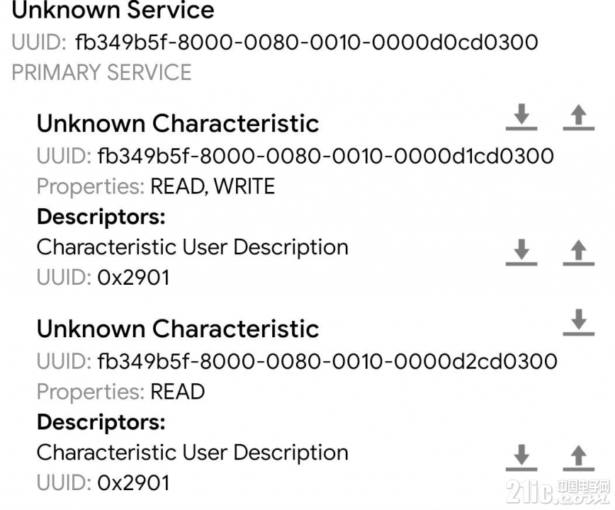

 楼主| xiaowenlg2 发表于 2020-5-28 17:36 | 显示全部楼层 |阅读模式
ch579 怎样修改成128bit的uuid
在gattprofile.c中改了几次不成功啊

 楼主| xiaowenlg2 发表于 2020-5-29 09:21 | 显示全部楼层
CONST uint8 simpleProfileServUUID[ATT_UUID_SIZE] =
  0x00,0x03,0xcd,0xd0,0x00,0x00,0x10,0x00,0x80,0x00,0x00,0x80,0x5f,0x9b,0x34,0xfb
// Characteristic 1 UUID: 0xFFF1
CONST uint8 simpleProfilechar1UUID[ATT_UUID_SIZE] =
  0x00,0x03,0xcd,0xd1,0x00,0x00,0x10,0x00,0x80,0x00,0x00,0x80,0x5f,0x9b,0x34,0xfb
// Characteristic 2 UUID: 0xFFF2
CONST uint8 simpleProfilechar2UUID[ATT_UUID_SIZE] =
  0x00,0x03,0xcd,0xd2,0x00,0x00,0x10,0x00,0x80,0x00,0x00,0x80,0x5f,0x9b,0x34,0xfb
      { ATT_UUID_SIZE, characterUUID },
      GATT_PERMIT_READ,
      0,
      &simpleProfileChar1Props
      // Characteristic Value 1
        { ATT_UUID_SIZE, simpleProfilechar1UUID },
        GATT_PERMIT_READ | GATT_PERMIT_WRITE,
        0,
        simpleProfileChar1
      // Characteristic 1 User Description
        { ATT_UUID_SIZE, charUserDescUUID },
        GATT_PERMIT_READ,
        0,
        simpleProfileChar1UserDesp

kingsleych 发表于 2020-5-29 10:00 | 显示全部楼层
  0x00,0x03,0xcd,0xd0,0x00,0x00,0x10,0x00,0x80 ...
gattprofile.c 文件给你修改好了,你替换到你的工程试试看
gattprofile.zip (4 KB, 下载次数: 5)
