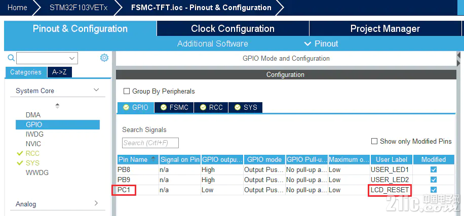

最后配置LCD的复位管脚:
26

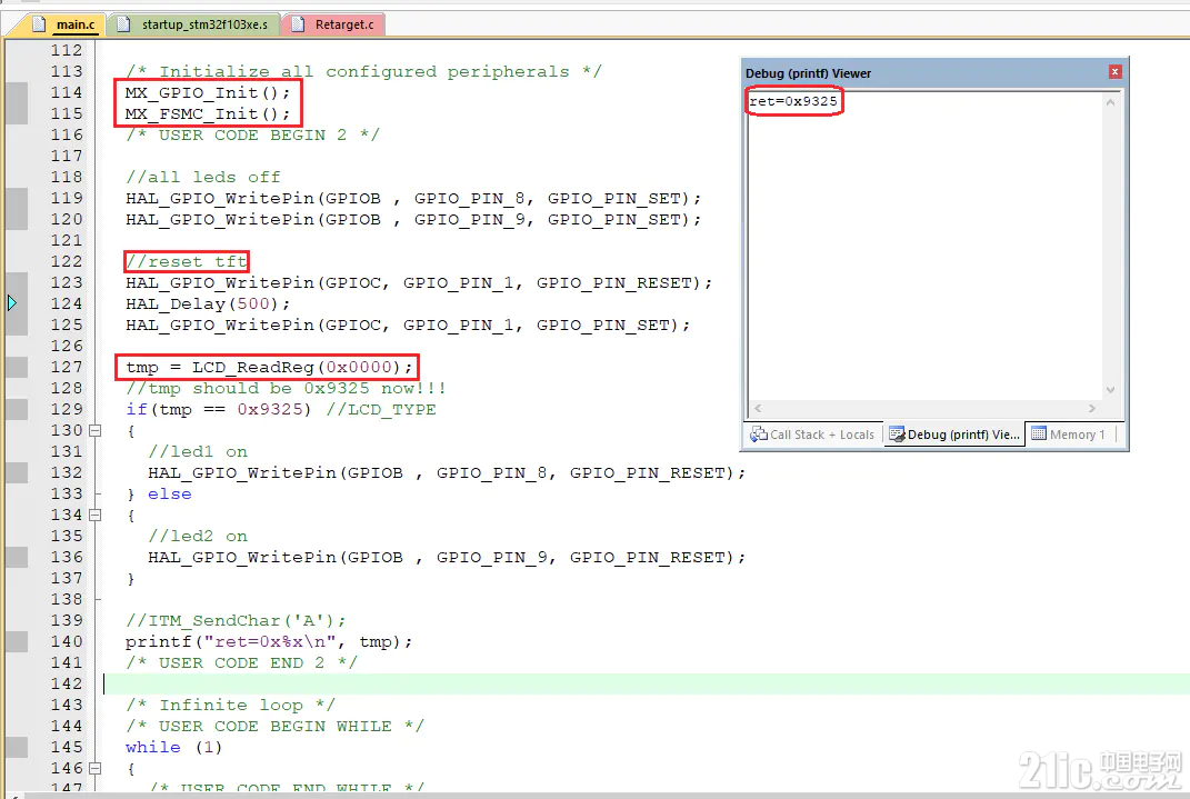

在CUBEMX中生成KEIL的代码,在main.c中添加针对 ILI9325 读写的函数:
main.c
#define LCD_Data_Addr ((uint32_t)0x60020000)     //写数据地址
#define LCD_Reg_Addr    ((uint32_t)0x60000000)  //写命令地址

程序初始化之后,复位LCD,然后读取 ILI9325 的版本,如果能正确读出数据 “9325”,即表明FSMC配置正确:
//复位LCD
HAL_GPIO_WritePin(GPIOC, GPIO_PIN_1, GPIO_PIN_RESET);
HAL_Delay(500);
HAL_GPIO_WritePin(GPIOC, GPIO_PIN_1, GPIO_PIN_SET);
//读
tmp = LCD_ReadReg(0x0000);    //0000为编码,详见 ILI9325手册
//tmp should be 0x9325 now!!!
if(tmp == 0x9325)
    //led1 on
    HAL_GPIO_WritePin(GPIOB , GPIO_PIN_8, GPIO_PIN_RESET);
} else
    //led2 on
     HAL_GPIO_WritePin(GPIOB , GPIO_PIN_9, GPIO_PIN_RESET);
printf("ret=0x%x\n", tmp);
28
functions|  楼主 | 2020-6-24 15:27 | 只看该作者
运行结果:
30
