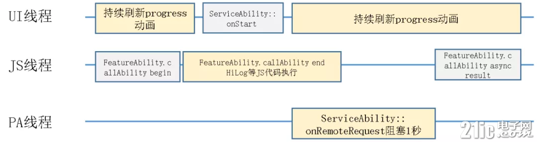

以上代码完成后,我们进行执行,progress组件的动画同样不会被打断,得到的Log如下:
06-25 13:31:48.090 4133-5887/com.blancwu.test I 03B00/JSApp: app Log: FeatureAbility.callAbility begin{"bundleName":"com.blancwu.test","abilityName":"com.blancwu.test.ServiceAbility","messageCode":1001,"abilityType":0,"syncOption":0}
06-25 13:31:48.094 4133-5887/com.blancwu.test I 03B00/JSApp: app Log: FeatureAbility.callAbility end{"bundleName":"com.blancwu.test","abilityName":"com.blancwu.test.ServiceAbility","messageCode":1001,"abilityType":0,"syncOption":0}
06-25 13:31:48.112 4133-4133/com.blancwu.test E 01100/ServiceAbility: [8187916a4418bed, 399b373, f521b3] ServiceAbility::onStart
06-25 13:31:48.126 4133-5837/com.blancwu.test I 01100/ServiceAbility: [8187916a4418bed, 171378f, 385abb1] onRemoteRequest begin 1079135572
06-25 13:31:48.126 4133-5837/com.blancwu.test I 01100/ServiceAbility: [8187916a4418bed, 171378f, 385abb1] onRemoteRequest end 1079135572
06-25 13:31:48.126 4133-5837/com.blancwu.test I 00000/RemoteObject: [8187916a4418bed, 171378f, 385abb1] Java onRemoteRequest called
06-25 13:31:48.143 4133-5837/com.blancwu.test I 01100/ServiceAbility: onRemoteRequest begin 1001
06-25 13:31:49.145 4133-5837/com.blancwu.test I 01100/ServiceAbility: onRemoteRequest end 1001
06-25 13:31:49.145 4133-5837/com.blancwu.test I 00000/RemoteObject: Java onRemoteRequest called
06-25 13:31:49.151 4133-5887/com.blancwu.test I 03B00/JSApp: app Log: FeatureAbility.callAbility async result "{\"result\":1}"
整个执行过程可以描述如下图:
我们观察到本次运行主进程(UI线程)号为4133,JS代码执行在JS线程(5887),Java PA响应onRemoteRequest执行在另一个后台任务线程(5837)。通过Log我们看到onRemoteRequst即使阻塞了后台任务线程1s也不会影响JS线程的执行以及主线程(UI线程)上动画的刷新,做到了JS线程与后台任务线程上的任务并行处理。
