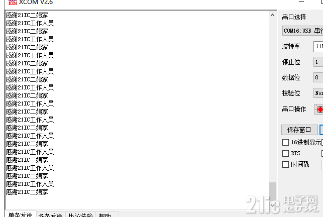

      国民技术N32G43X串口打印功能,支持printf函数,而不需要选择use MicroLIB。
  1. /* System Clocks Configuration */
  2.     RCC_Configuration();
  3.     /* Configure the GPIO ports */
  4.     GPIO_Configuration();
  5.     /* USARTy and USARTz configuration ------------------------------------------------------*/
  6.     USART_InitStructure.BaudRate            = 115200;
  7.     USART_InitStructure.WordLength          = USART_WL_8B;
  8.     USART_InitStructure.StopBits            = USART_STPB_1;
  9.     USART_InitStructure.Parity              = USART_PE_NO;
  10.     USART_InitStructure.HardwareFlowControl = USART_HFCTRL_NONE;
  11.     USART_InitStructure.Mode                = USART_MODE_RX | USART_MODE_TX;
  12.     /* Configure USARTx */
  13.     USART_Init(USARTx, &USART_InitStructure);
  14.     /* Enable the USARTx */
  15.     USART_Enable(USARTx, ENABLE);

打印:
显示主频始终144M,666
