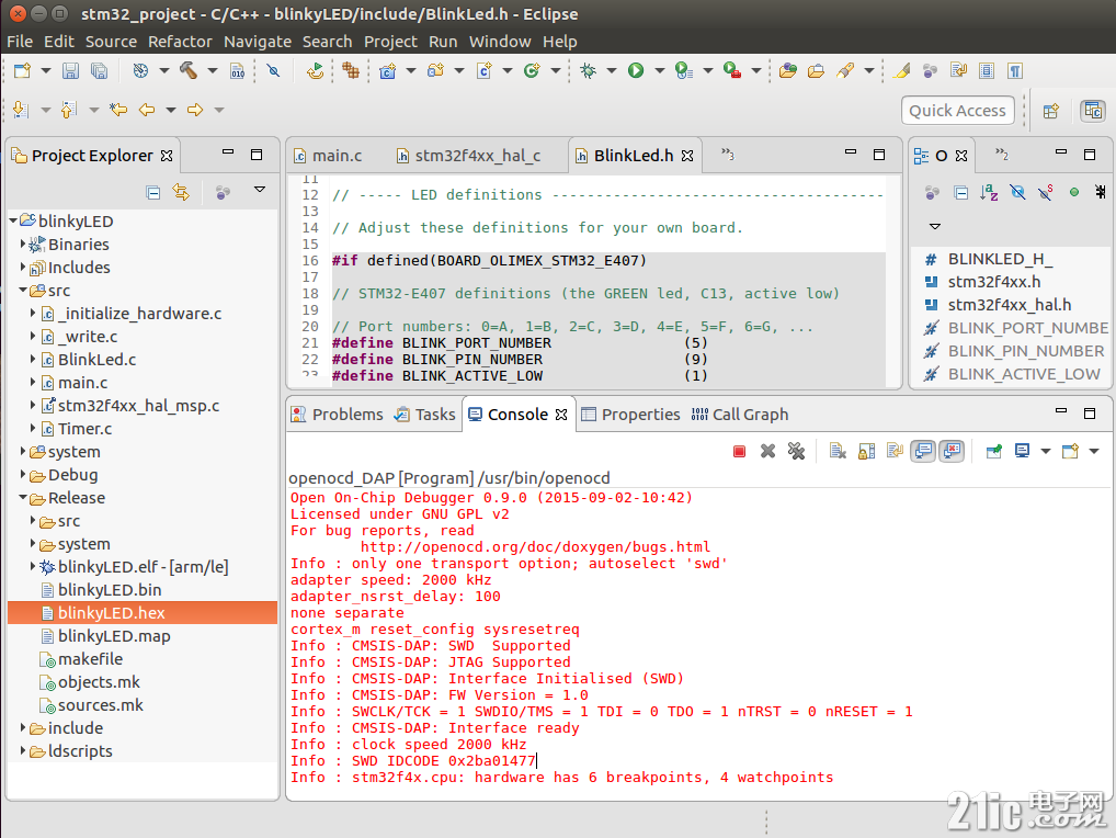

7.When you installed you need do some test.
This step need you connect your debug device with stm32f4 board.(My device is:CMSIS-DAP+STM32F407ZET6)
Connect Command:
Sudo openocd –f /user/share/openpcd/scripts/interface/cmsis-dap.cfg –f /user/share/openpcd/scripts/target/stm32f4x.cfg
If you see this message in your terminal:
Info : stm32f4x.cpu: hardware has 6 breakpoints, 4 watchpoints
It prove your connect is successful!
8.Click your menu bar
Run → External Tools → External Tools configurations..
When you configuration is complete,
click Apply → Run.
If you set successful,you will see the red message like this:

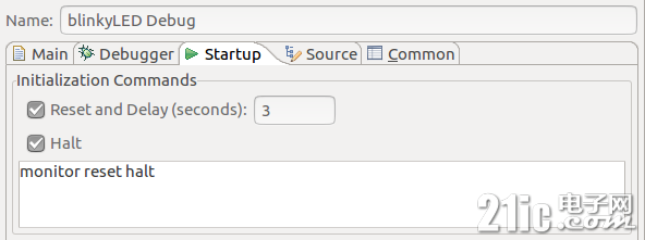

9.Debug Configurations
Creat a new menu under “GDB Hardware Debug”,and reference these picture to configuratopm:
In main menu:
In Debugger menu:
In starup menu:
In common menu:
Future start-up steps should be:1.Use External Tools.2.Debug Configuration → Run GDB Hardware Debugging
