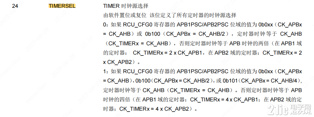

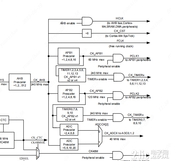

获取所用GD32定时器的时钟频率要想输出确定PWM频率的波,首先要知道当前所用定时器的时钟频率,查看GD32F4xx用户手册中的4-2.时钟树
送药小车项目中,用的是外部时钟,APB1和APB2配置如下所示:
  1. <div data-page-id="OpjudooEAoYasFxOCz9cAb54ngN" data-docx-has-block-data="false"><pre class="ace-line ace-line old-record-id-MtDHdEqj6obQKwxwf7CcggzVnke"><code class="language-C" data-wrap="false">//截取至system_gd32f4xx.c
  2. system_clock_240m_25m_hxtal();
  3.
  4. /* AHB = SYSCLK */
  5. RCU_CFG0 |= RCU_AHB_CKSYS_DIV1;
  6. /* APB2 = AHB/2 */
  7. RCU_CFG0 |= RCU_APB2_CKAHB_DIV2;
  8. /* APB1 = AHB/4 */
  9. RCU_CFG0 |= RCU_APB1_CKAHB_DIV4;</code></pre></div><span data-lark-record-data="{&quot;rootId&quot;:&quot;OpjudooEAoYasFxOCz9cAb54ngN&quot;,&quot;text&quot;:{&quot;initialAttributedTexts&quot;:{&quot;text&quot;:{&quot;0&quot;:&quot;//截取至system_gd32f4xx.c\n\nsystem_clock_240m_25m_hxtal();\n    \n/* AHB = SYSCLK */\nRCU_CFG0 |= RCU_AHB_CKSYS_DIV1;\n/* APB2 = AHB/2 */\nRCU_CFG0 |= RCU_APB2_CKAHB_DIV2;\n/* APB1 = AHB/4 */\nRCU_CFG0 |= RCU_APB1_CKAHB_DIV4;&quot;},&quot;attribs&quot;:{&quot;0&quot;:&quot;*0|9+52*0+w&quot;}},&quot;apool&quot;:{&quot;numToAttrib&quot;:{&quot;0&quot;:[&quot;author&quot;,&quot;7209868880213491740&quot;]},&quot;nextNum&quot;:1}},&quot;type&quot;:&quot;text&quot;,&quot;referenceRecordMap&quot;:{},&quot;extra&quot;:{&quot;mention_page_title&quot;:{},&quot;external_mention_url&quot;:{}},&quot;isKeepQuoteContainer&quot;:false,&quot;isFromCode&quot;:true,&quot;selection&quot;:[{&quot;id&quot;:33,&quot;type&quot;:&quot;text&quot;,&quot;selection&quot;:{&quot;start&quot;:0,&quot;end&quot;:214},&quot;recordId&quot;:&quot;MtDHdEqj6obQKwxwf7CcggzVnke&quot;}],&quot;payloadMap&quot;:{},&quot;isCut&quot;:false}" data-lark-record-format="docx/text" class="lark-record-clipboard"></span>
可知AHB为240Mhz,定时器的时钟有两个路线,一路定时器的时钟从APB1过来,又因为上面这个TIMERSEL时钟源选择这个位,所以APB1下时钟频率为120MHz,也就是TIMER1,2,3,4,5,6,11,12,13是120MHz。另一路定时器时钟从APB2过来,TIMER0,7,8,9,10时钟频率为240MHz。
