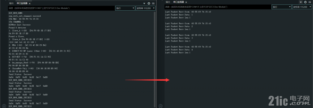

 楼主| gaoyang9992006 发表于 2023-8-17 22:25 | 显示全部楼层
该图是发送和接收设备串口打印的消息。
  1. ESP_NOW_DEMO
  2. esp_wifi_set_channel:succeed
  3. STA MAC: 60:55:F9:74:15:C0
  4. STA CHANNEL 1
  5. ESPNow Init Success
  6. Found 6 devices
  7. 1: Slave_A (-28)  [D4:F9:8D:3E:17:BD]
  8. D4:F9:8D:3E:17:BD
  9. Found a Slave.
  10. 1: Slave_A [D4:F9:8D:3E:17:BD] (-28)
  11. <212 249 141 62 23 189 >
  12. 2: WXA (-62)  [4C:C6:4C:B6:CD:EA]
  13. 4C:C6:4C:B6:CD:EA
  14. 3: DIRECT-5C-HP Laser 136nw (-68)  [52:81:40:D9:31:5C]
  15. 52:81:40:D9:31:5C
  16. 4: XGY-NJY (-74)  [98:F1:81:1A:C2:90]
  17. 98:F1:81:1A:C2:90
  18. 5: hw_manage_5be0 (-79)  [F8:98:EF:E6:5B:EB]
  19. F8:98:EF:E6:5B:EB
  20. 6: ChinaNet-7uLj (-90)  [38:88:1E:B5:E5:90]
  21. 38:88:1E:B5:E5:90
  22. Send Status: Success
  23. 0xD4  0xF9  0x8D  0x3E  0x17  0xBD
  24. ESP_NOW_SEND_SUCCESS
  25. Send Status: Success
  26. 0xD4  0xF9  0x8D  0x3E  0x17  0xBD
  27. ESP_NOW_SEND_SUCCESS
  1. Last Packet Recv from: 60:55:f9:74:15:c0
  2. Last Packet Recv Data: 1
  3. Last Packet Recv len:1
  4. Last Packet Recv from: 60:55:f9:74:15:c0
  5. Last Packet Recv Data: 2
  6. Last Packet Recv len:1
  7. Last Packet Recv from: 60:55:f9:74:15:c0
  8. Last Packet Recv Data: 3
  9. Last Packet Recv len:1
  10. Last Packet Recv from: 60:55:f9:74:15:c0
  11. Last Packet Recv Data: 4
  12. Last Packet Recv len:1
  13. Last Packet Recv from: 60:55:f9:74:15:c0
  14. Last Packet Recv Data: 5
  15. Last Packet Recv len:1
技术总结:发送端查找接收端的热点,并把符合要求的热点的MAC找到,通过MAC地址和信道让发送函数发送数据;接收端监听对应信道发送给自己MAC地址的消息,并返回发送者的MAC与数据。  发表于 2023-8-18 09:39
