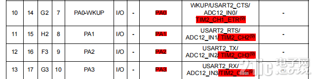

1、确定定时器
高级控制定时器(TIM1、TIM8)、通用定时器(TIMx)、基本定时器(TIM6、TIM7)---我选用的是TIM2
2、确定引脚(查用户手册)
我选择的是:TIM2-CH4 PA3

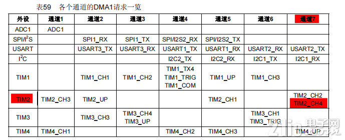

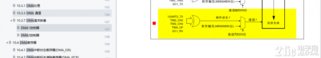

3、确定DMA以及通道(查询参考手册)
根据上述选择觉得DMA1还是DMA2,这边是DMA1 通道为 Channel7

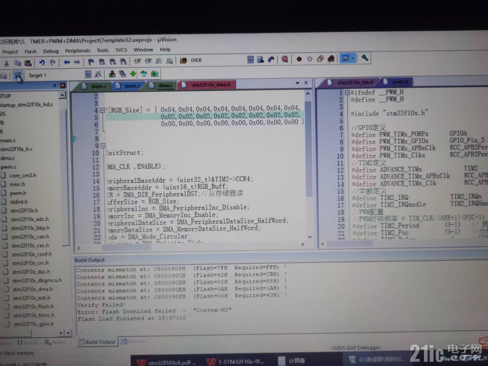

2、DMA.c文件(涉及DMA结构初始化)RGB_Buff内存存储的缓存要发给PWM改变占空比的
#include "dma.h"
#define RGB_Size 25
//1码:0x06    0码:0x02
const uint16_t RGB_G_Buff[RGB_Size] = { 0x06,0x06,0x06,0x06,0x06,0x06,0x06,0x06,
                                                                            0x02,0x02,0x02,0x02,0x02,0x02,0x02,0x02,
                                                                            0x00 };
const uint16_t RGB_R_Buff[RGB_Size] = { 0x02,0x02,0x02,0x02,0x02,0x02,0x02,0x02,
                                                                            0x00 };
const uint16_t RGB_B_Buff[RGB_Size] = { 0x02,0x02,0x02,0x02,0x02,0x02,0x02,0x02,
                                                                            0x00 };
const uint16_t RGB_0_Buff[RGB_Size] = { 0x02,0x02,0x02,0x02,0x02,0x02,0x02,0x02,
                                                                            0x00 };
void Dma_Init(void)
    DMA_InitTypeDef DMA_InitStruct;
    TIM_DMA_APBxCLK(TIM_DMA_CLK ,ENABLE);
    DMA_InitStruct.DMA_PeripheralBaseAddr = (uint32_t)&TIM2->CCR4;
    DMA_InitStruct.DMA_MemoryBaseAddr = (uint32_t)RGB_B_Buff;
    DMA_InitStruct.DMA_DIR = DMA_DIR_PeripheralDST;//从存储器读
    DMA_InitStruct.DMA_BufferSize = RGB_Size;
    DMA_InitStruct.DMA_PeripheralInc = DMA_PeripheralInc_Disable;
    DMA_InitStruct.DMA_MemoryInc = DMA_MemoryInc_Enable;
    DMA_InitStruct.DMA_PeripheralDataSize = DMA_PeripheralDataSize_HalfWord;
    DMA_InitStruct.DMA_MemoryDataSize = DMA_MemoryDataSize_HalfWord;
    DMA_InitStruct.DMA_Mode = DMA_Mode_Circular;
    DMA_InitStruct.DMA_Priority = DMA_Priority_High;
    DMA_InitStruct.DMA_M2M = DMA_M2M_Disable;
    DMA_Init(MTM_DMA_Channe, &DMA_InitStruct);
    DMA_Cmd(MTM_DMA_Channe, ENABLE);
    //DMA_ClearFlag(MTM_DMA_TCx);

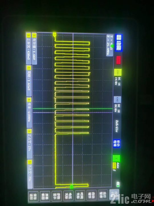

五、测试波形
之前是使用0x06, 0x02,0x00各八组的数据组测量的,可以明显看到下述测量波形占空比的变化
