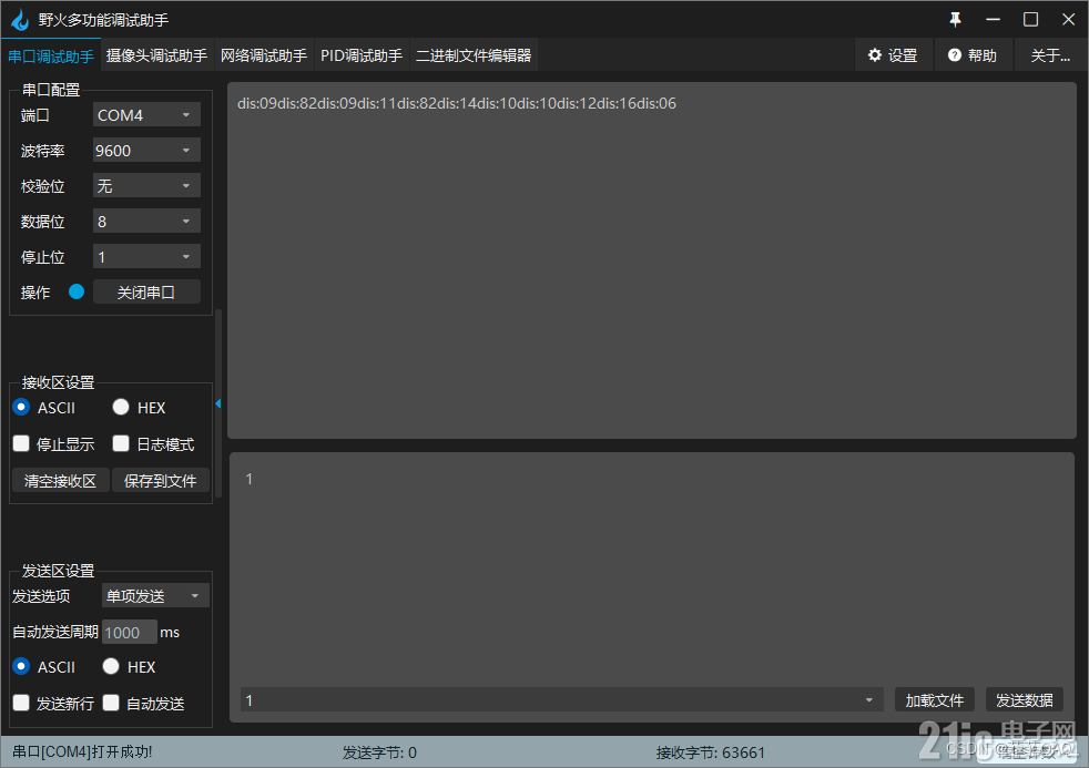

Ultrasound.c
#include "stm32f10x.h"                  // Device header
#include "Delay.h"
uint16_t Cnt;
uint16_t OverCnt;
void Ultrasound_Init(){
        RCC_APB1PeriphClockCmd(RCC_APB1Periph_TIM4, ENABLE);
        RCC_APB2PeriphClockCmd(RCC_APB2Periph_GPIOB, ENABLE);
        GPIO_InitStructure.GPIO_Mode = GPIO_Mode_Out_PP;//trig 推挽输出
        GPIO_InitStructure.GPIO_Pin = GPIO_Pin_12;
        GPIO_Init(GPIOB, &GPIO_InitStructure);
        GPIO_InitStructure.GPIO_Mode = GPIO_Mode_IPD;//echo 接受引脚 下拉输入
        GPIO_InitStructure.GPIO_Pin = GPIO_Pin_13;
        TIM_InternalClockConfig(TIM4);
        TIM_TimeBaseInitTypeDef TIM_TimeBaseInitStructure;
        TIM_TimeBaseInitStructure.TIM_ClockDivision = TIM_CKD_DIV1;
        TIM_TimeBaseInitStructure.TIM_CounterMode = TIM_CounterMode_Up;
        TIM_TimeBaseInitStructure.TIM_Period = 60000 - 1;                //ARR
        TIM_TimeBaseInitStructure.TIM_Prescaler = 72 - 1;                //PSC
        TIM_TimeBaseInitStructure.TIM_RepetitionCounter = 0;
        TIM_TimeBaseInit(TIM4, &TIM_TimeBaseInitStructure);
float Test_Distance(){
        GPIO_SetBits(GPIOB,GPIO_Pin_12);
        Delay_us(20);
        GPIO_ResetBits(GPIOB,GPIO_Pin_12);
        while(GPIO_ReadInputDataBit(GPIOB,GPIO_Pin_13)==RESET){
        TIM_Cmd(TIM4, ENABLE);
        while(GPIO_ReadInputDataBit(GPIOB,GPIO_Pin_13)==SET){
        TIM_Cmd(TIM4, DISABLE);
        Cnt=TIM_GetCounter(TIM4);
        float distance=(Cnt*1.0/10*0.34)/2;
        TIM4->CNT=0;
        Delay_ms(100);
        return distance;
 楼主| 在水一方00 发表于 2024-1-29 17:05 | 显示全部楼层
5.实验现象
